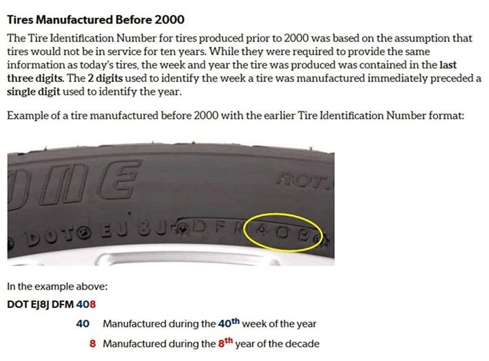

Can anyone help me determine the manufacture date of my goldline tires? I believe they are Coker reproductions and they read: DOT E 4 290... (only three digits) Also there is a white bold 13 printed on the tire... Firestone Deluxe Champion 7.75 15 tubeless ...Made in New Zealand All of the above are on the inside of the tire... Thank You, Pete

Does the 290 mean the 29th week of 1990?

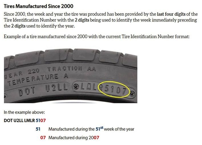

Since you dont have a 4 digit date, the tire is probably from the 29th week of 1990 and extremely dangerous to use. See the link below.
https://www.tirerack.com/tires/tiret....jsp?techid=11
