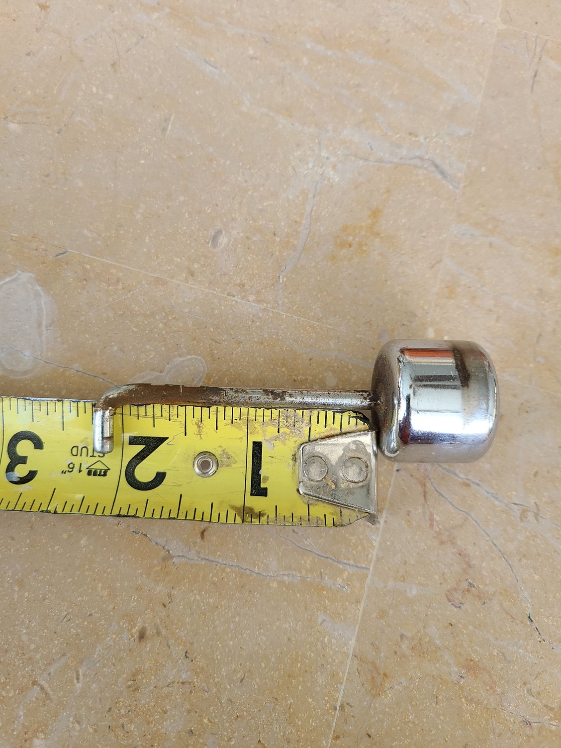

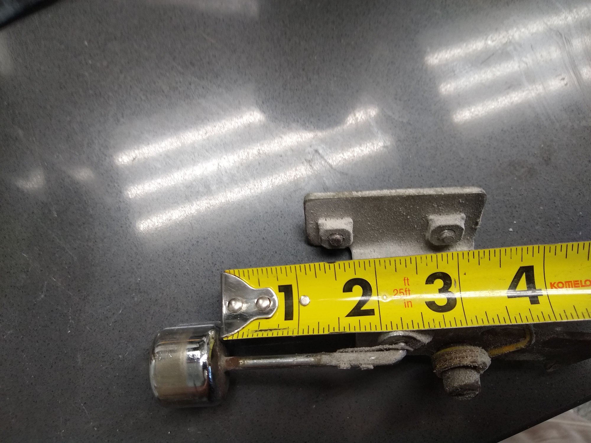

I would think that 57 is the same. Here is my 57 button assembly which works fine. It is the same length as yours. I included a picture of the whole assembly in case you have something different going on there.
Joe
