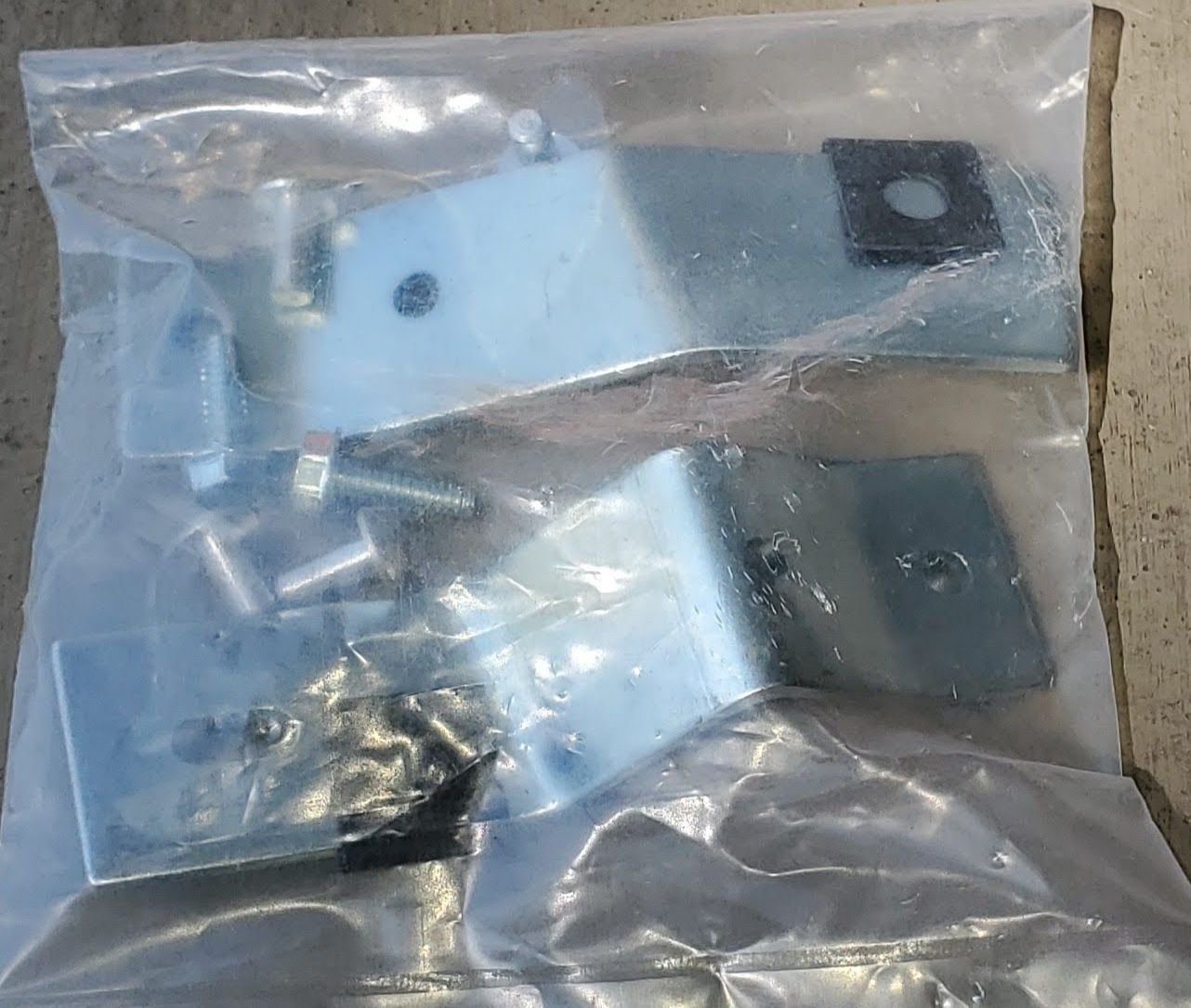

Where do these braces go? They came with parts.

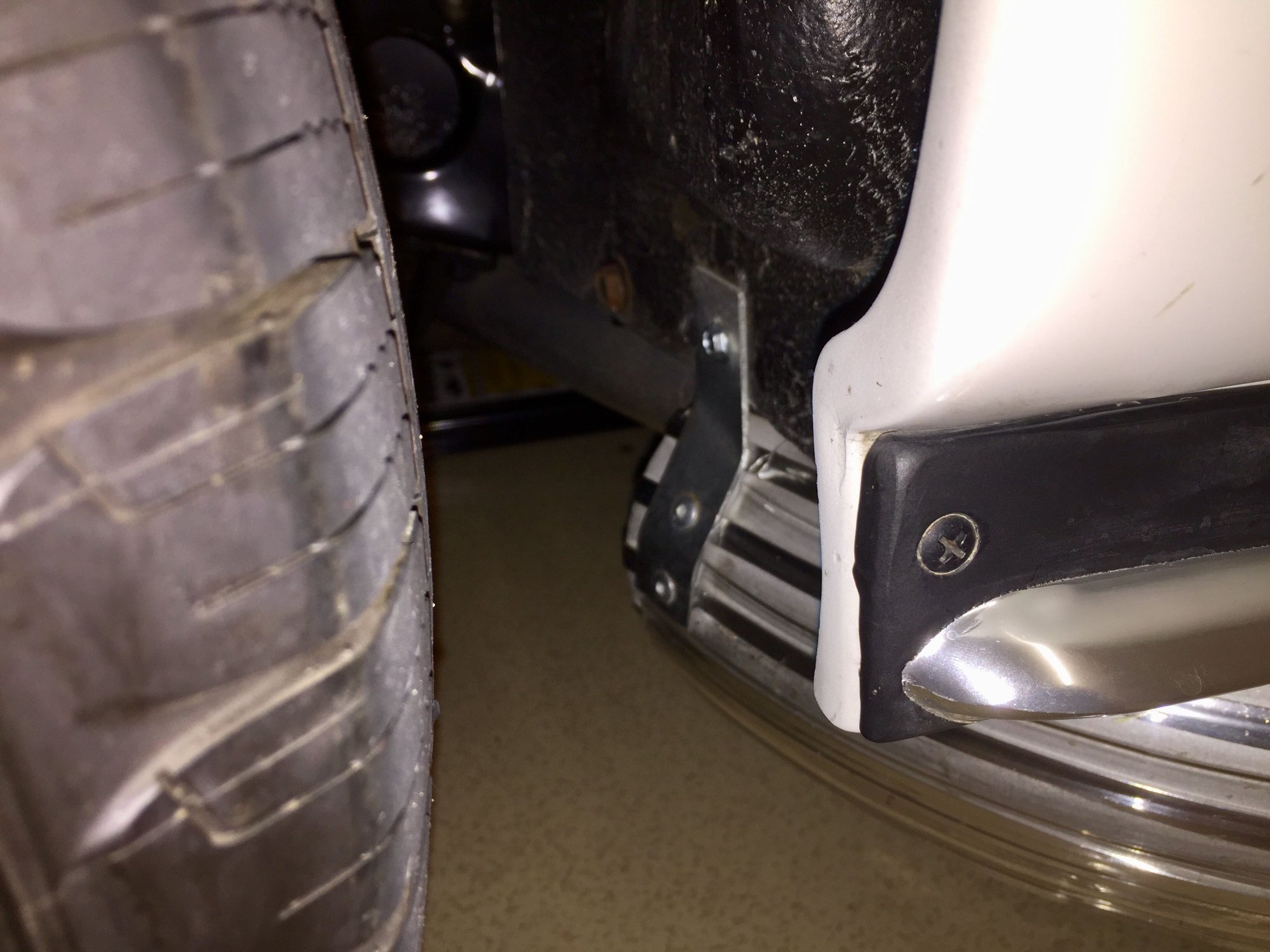

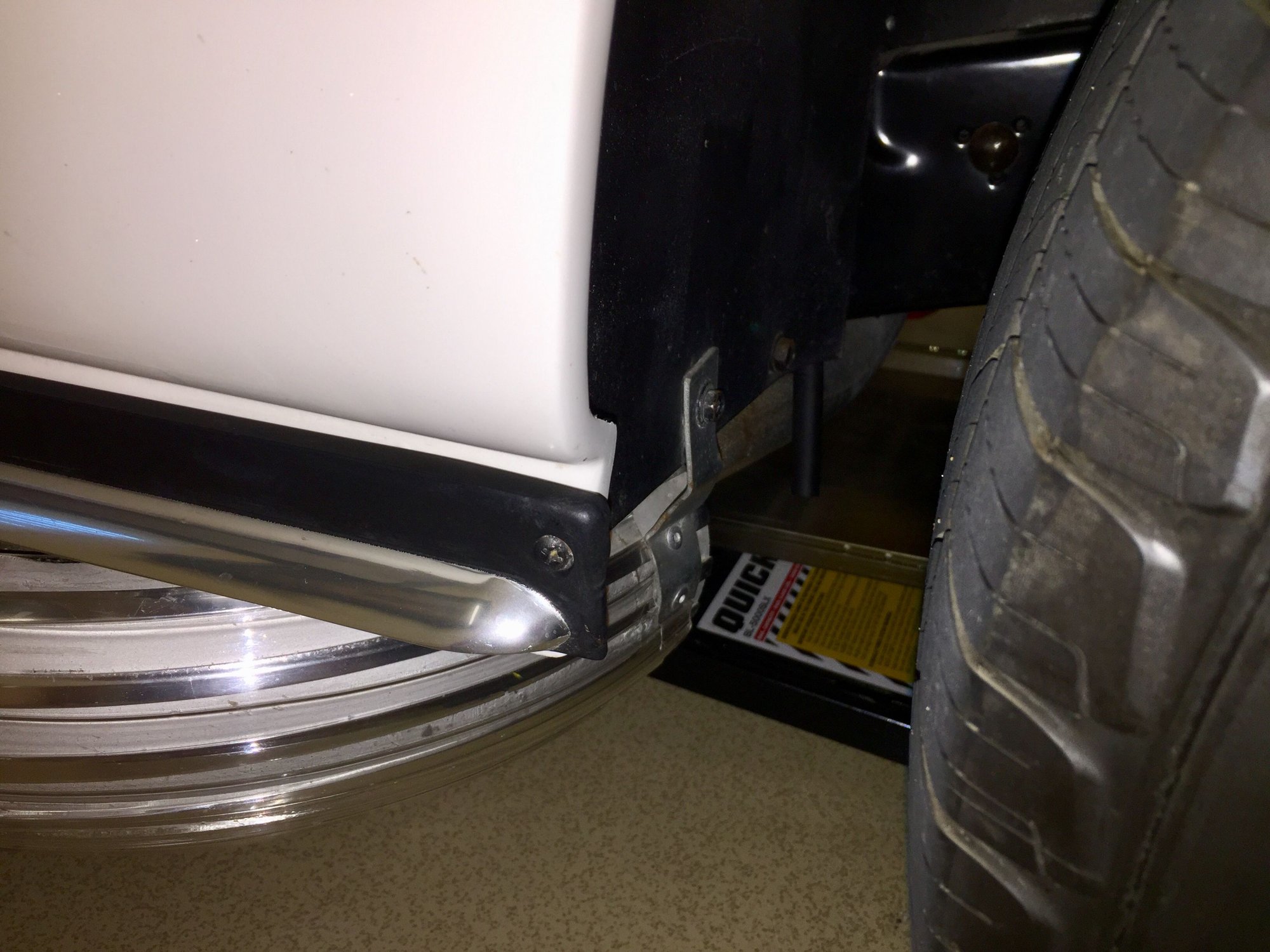

They look to be side pipe cover holders that are in the front wheel wells
Old Apr 29, 2020 | 10:22 AM
leif.anderson93's Avatar
leif.anderson93
Joined: Feb 2014
Posts: 8,783
Likes: 5,304
From: Richardson Texas
And, they are side specific.
Driver's side is the more straight piece.
Passenger side has a deeper bend in it.
