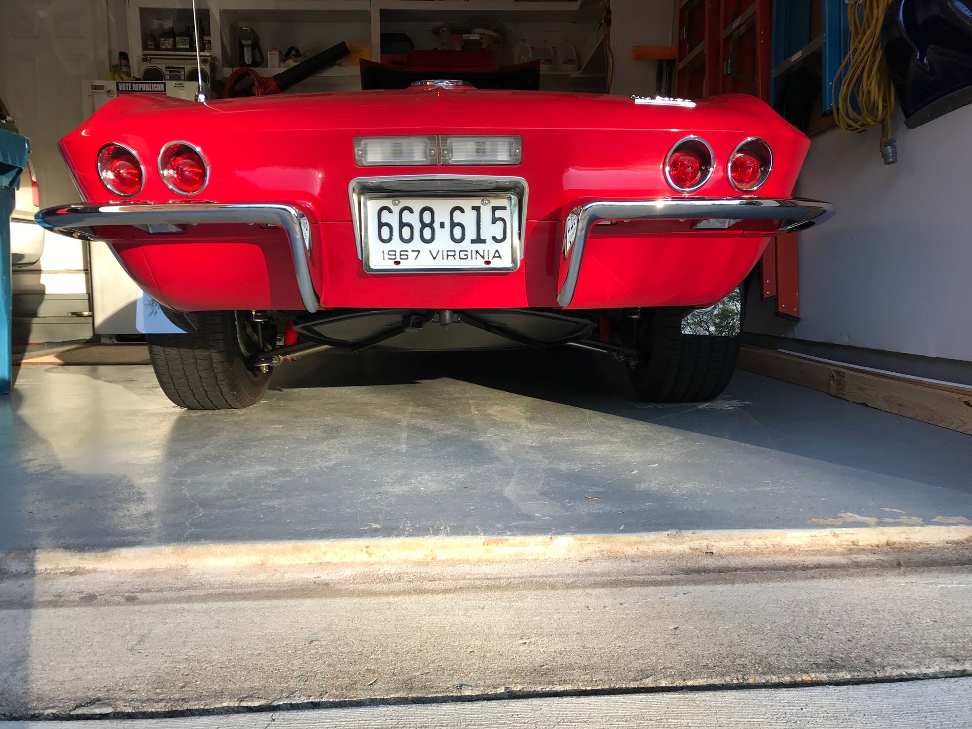

Tom,
Thanks for asking. There are a few pics of my car on the recent "Happy 427 Day" thread ( https://www.corvetteforum.com/forums...y-427-day.html ) and a lot on my profile. Let me know if you want to see something specific and I will be happy to post. Looks like you are only about 50 miles from me. Hope to run into you at the large car show in September in Gaithersburg (if they have it this year). There were too many shadows for a decent picture but here is a quick one (sun was going down) of the 245's from a low rear shot. Take care and stay safe out there. C.J.

I don't have offset arms so I had to relocate the parking brake, the largest tire I could fit with a 15 inch rim was the 235/60R15 in the rear, what mods did you do to get the 235 to fit the front?
I switched to a 1968 Rally Wheel (7 inch - one year only) in the front in order to accommodate the wider tire and I sanded down (from the inside) the half inch lip of fiberglass at the inside/top of the wheel arch.
