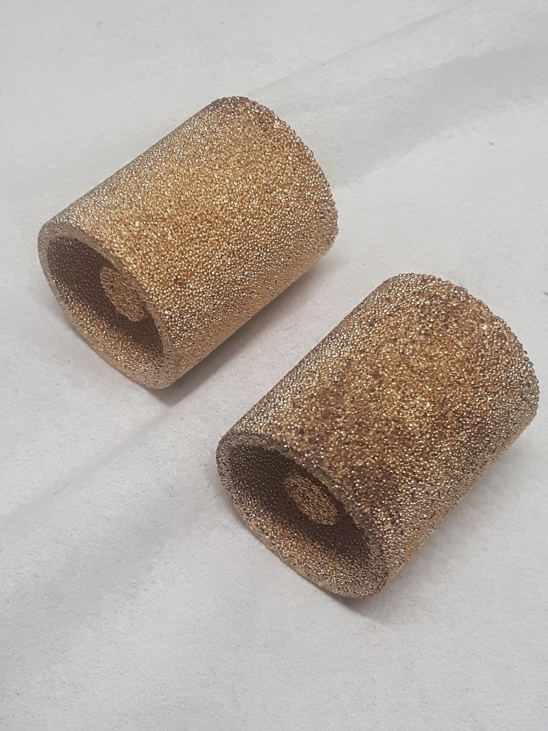

Tim,
As is the norm, Nowhere Man is spot on.
To help you a bit more in your understanding of fuel filters, the one you commonly change is behind the screw in adapter where your metal fuel line screws in to the carburetor. Remove your fuel line from the carb and then unscrew the large gold colored fitting and the gold colored sintered metallic fuel filter will be behind that fitting held tight up against it by a large spring. I have attached a picture down below of what I am talking about in case you are a visual type of guy. It looks like a round stone sponge and is located in the upper right corner of the picture. Good Luck with it and I hope this helps. C.J.

And note the orientation of the sintered filter when you remove it - its uni-directional and not reversible...

The "sock" filter in the tank requires no maintenance if its in good shape....the bronze carb filter can be taken out sprayed thoroughly with carb cleamer and reinserted into the carb...

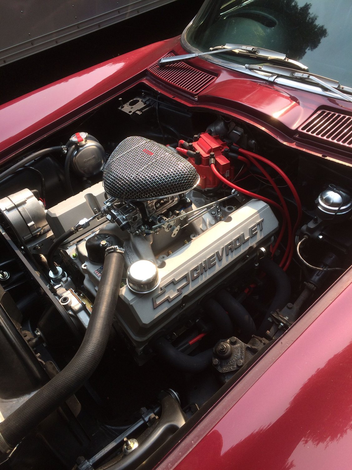

Can you see where my fuel filter is? Put one there

Hmmm... My engine looks a little different than yours
Yep. So cut the line put it in
