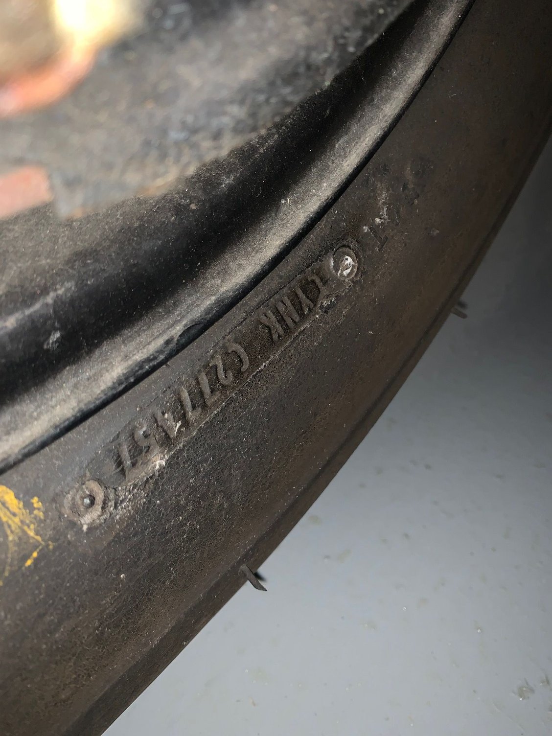

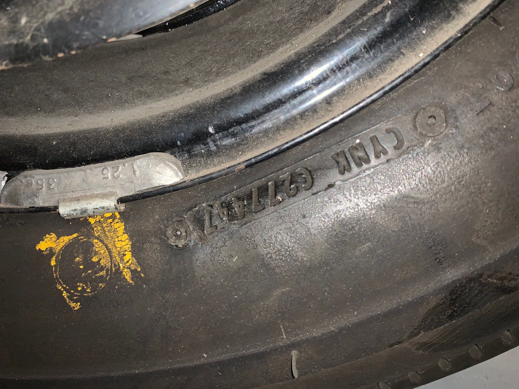

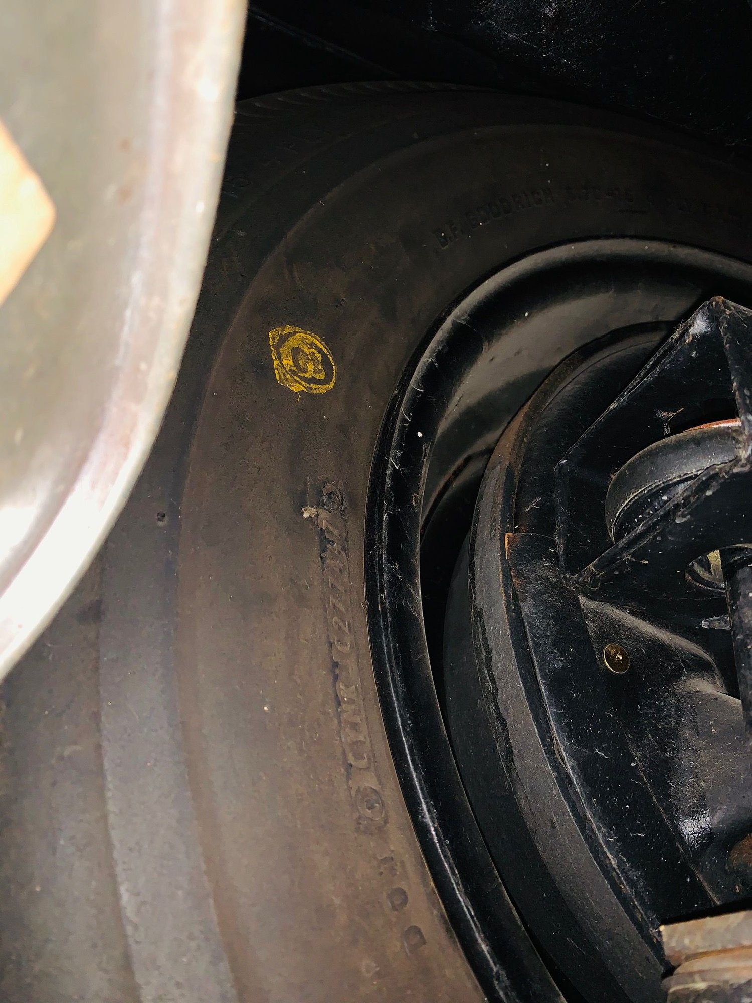

My bias ply tires on my 63...no idea how old they are... are they really in 3 digit code time? So it's the last 3 digits on older tires, making this in 97 or something else? or am i missing another oval on the inside of the tire somewhere...i looked at 3 so not sure if i just cant see anything else and need to keep looking.

From Tirerack website:
Tires Manufactured Before 2000
The Tire Identification Number for tires produced prior to 2000 was based on the assumption that tires would not be in service for ten years. While they were required to provide the same information as today's tires, the week and year the tire was produced was contained in the last three digits. The 2 digits used to identify the week a tire was manufactured immediately preceded a single digit used to identify the year.

The old bias belt tires I took off of my '61 were date coded 269, which meant they were produced in a year ending with a 9, maybe 89, 79, or even 69. By their appearance and ride quality, it could have been any of those years.

Lol, I have plenty of experience with track tires at least. So we all agree these are pre 2000 with the 3 digit code. The car in theory was restored in the 1996 period so I’m guessing they are 1997. Well they are in excellent shape. I don’t see any cracks or anything along the sidewalls. Still just driving in my neighborhood but yup will be getting new ones...Llast night under the car I could finally see I actually have a spare. Though need to get up the nerve to open the compartment and get it out.
