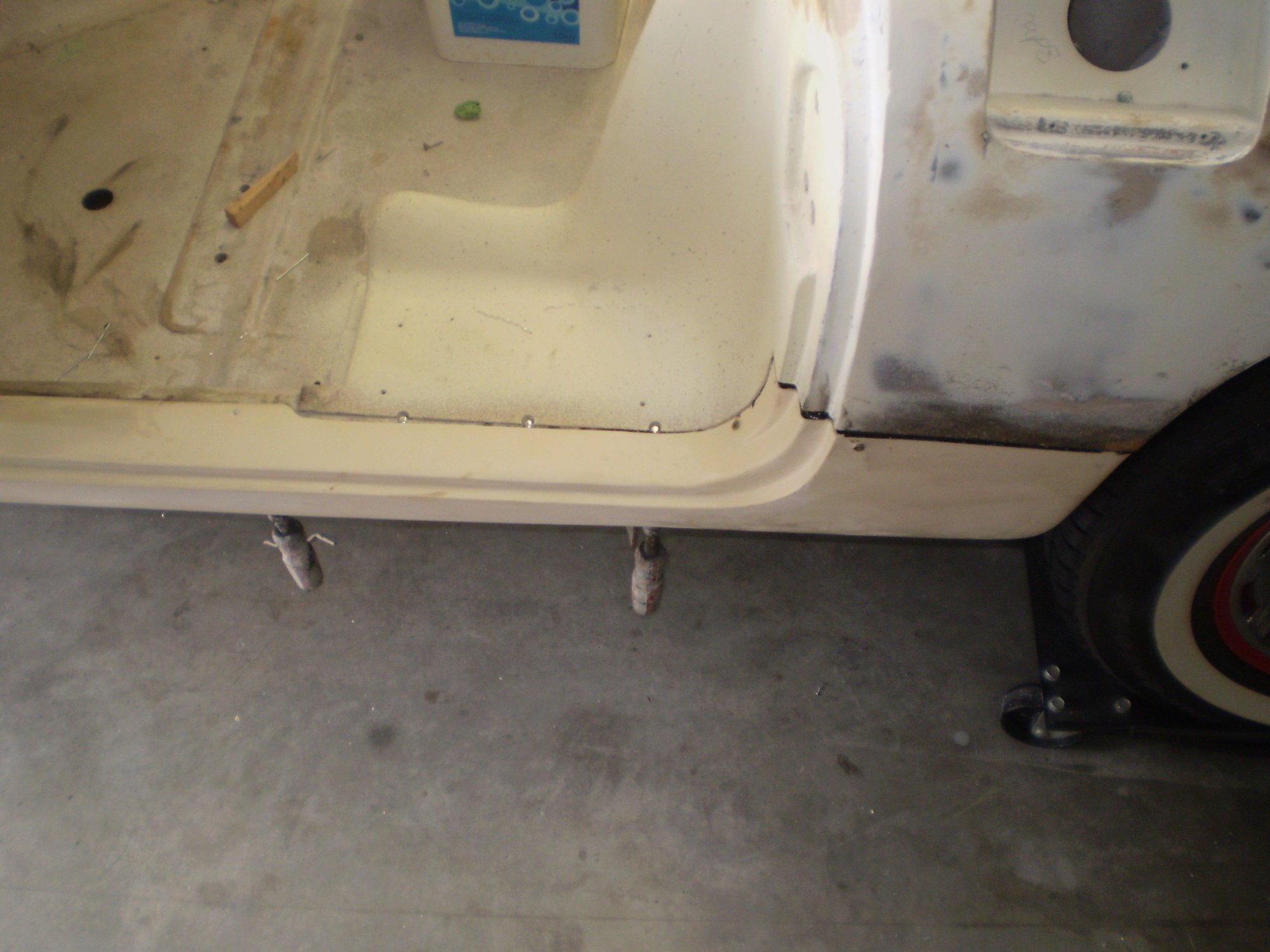

Herm i will read the thread in a bit and thank you factoid for the reply, to give you some insight i need to replace the rockers on my 1960
there was a great thread on here and i have even talked to chip on here about it
below are a couple of pictures from the thread on how the one guy was able to do it, he completed cut the whole bottom half of the car off and i won't lie that scares me.
it's beyond y fibreglass skills at this point.
chip when i talked to him opened up the caps on either end and was able to slide the rockers in. just behind where your feet would be the rockers are tied in with 2 bolts
my plan was to maybe open up the back cap and then cut a large enough hole in the front to access the two rotten bolts and one that was done drill out the rivets to slide the new rocker in and bolt it back up
that would leave me with a large blind hole
the more i keep looking at the job i need to do i am second guessing myself, but i would at-least like to try it
this is the thread i have been staring at for a week https://www.corvetteforum.com/forums...acement-2.html
this shows a good cut out of what mickatbp did
his panel he butted up after
