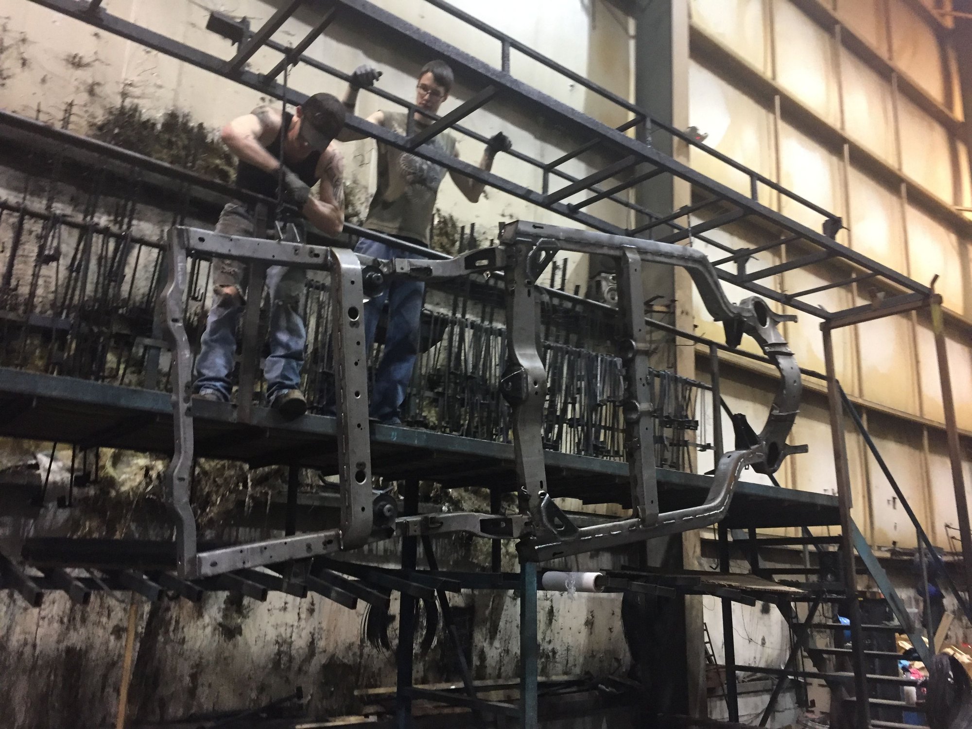

I had to replace my original frame due to extensive rust on the top surface. Swung by a treatment plant in Punxsutawney, PA. Dipped the new frame in 4 or 5 tanks that cleaned, coated, treated, and cooked inside and out. It cost me ~$300! Then also epoxy primed/painted for color. We manufacture military equipment that's often used/abused in saltwater environment and treated rude. We only use epoxy coatings (my decision). My experience with powder coated farm equipment is bad. Rust migrates under PC and comes off in big flakes. Maybe it's poor prep before PC, don't know or care. I get it... PC looks great. But for durability/repairability we only use epoxy on parts that will see abuse/impacts.
