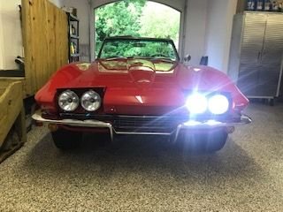

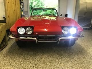

Upgrading to LED headlamps and ran into a problem.. With the Low Beams on the Left headlamp is very bright
as it should be, but the Right headlamp is very dim.
When I press the High Beam floor switch BOTH Left headlamps work correctly and Both Right headlamps do not
illuminate.

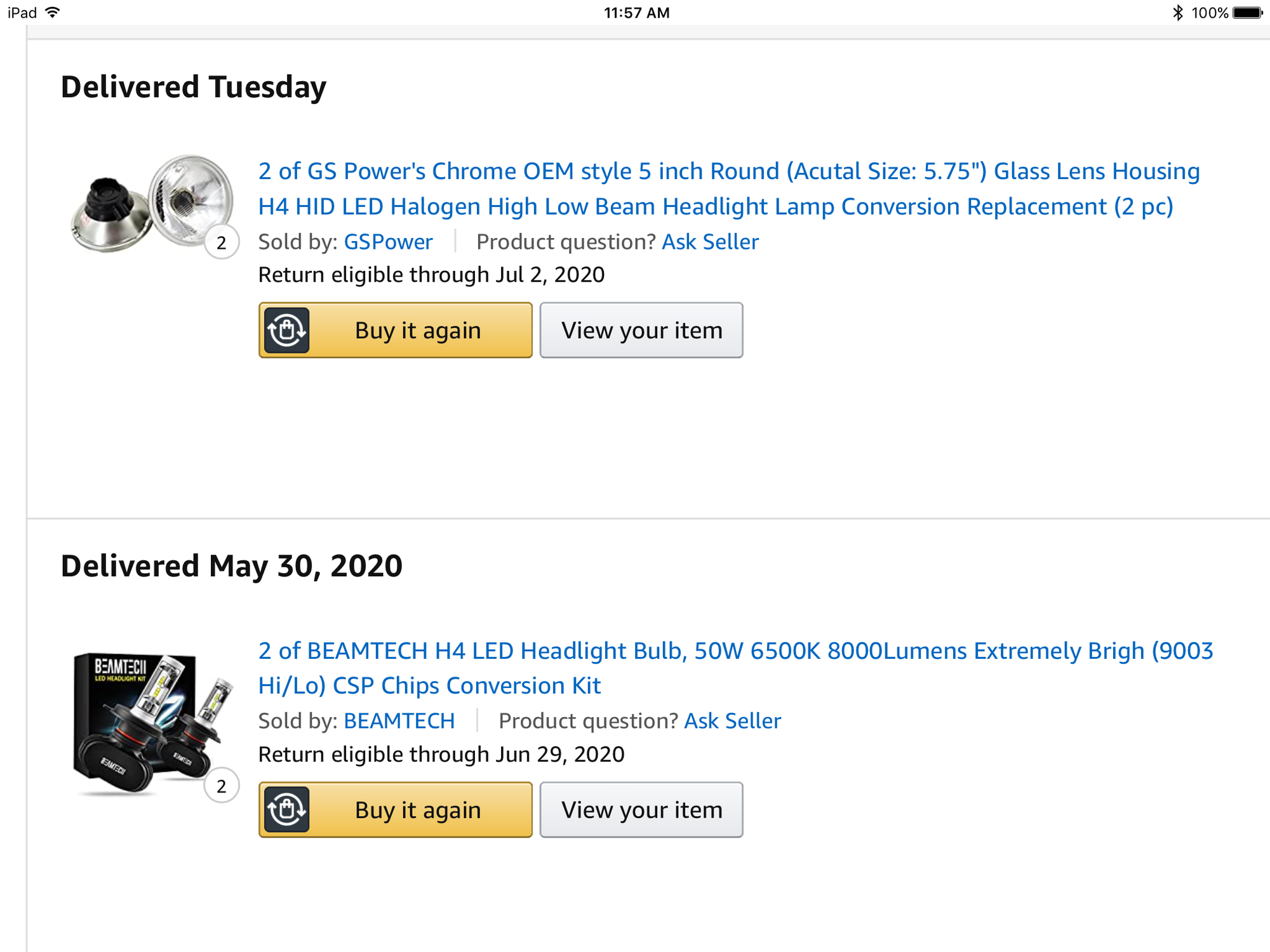

Attached is my Amazon order for reference. The LED bulbs (lamps) are three prong and have both HIGH
and LOW Beams. When installing the OUTTER Headlamps I used all Three prongs, for the INNER Headlamps
I bent back the middle prong and plugged into the Two prong connector. The second part of my order was
for the glass headlamps setup to receive an H4 modern replaceable bulb. The LED lamps are 6500 Kelvin
(very white) and rated at 30,000 hours of usage.
Normal Headlights you have the OUTTER Headlamps on LOW Beam..... But... when you hit the floor switch
for the High Beams you get all FOUR headlamps on High Beam ....! Can't wait to try it out tonight.
The good news is the power usage has gone way down on the system and the results are 10 times better!

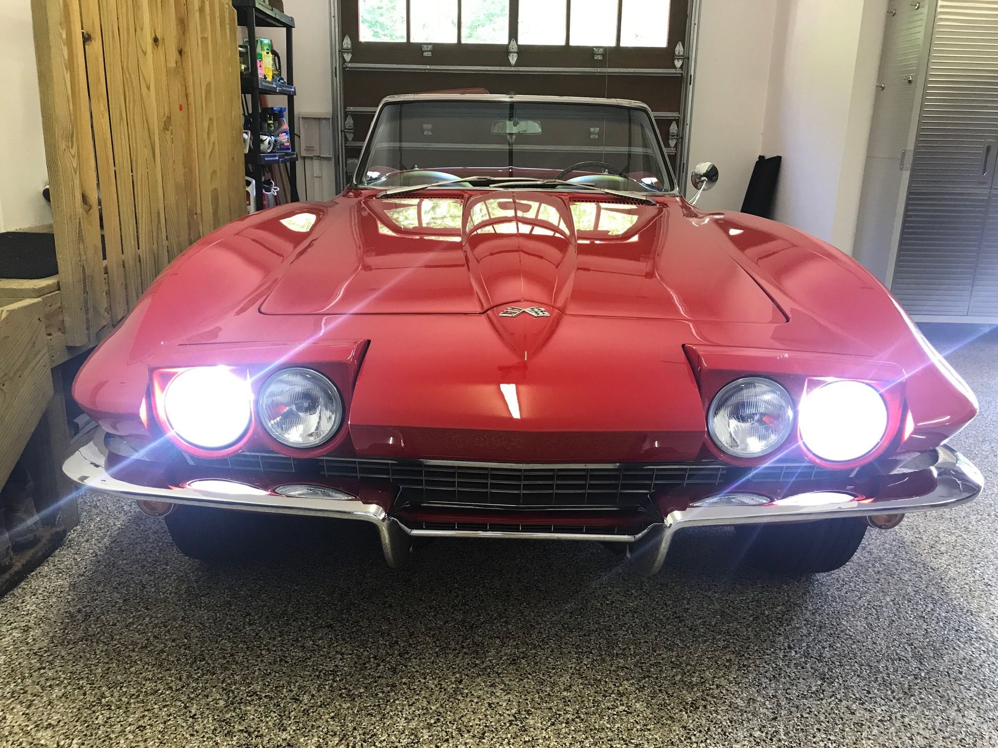

End Result Photos speak for themselves....

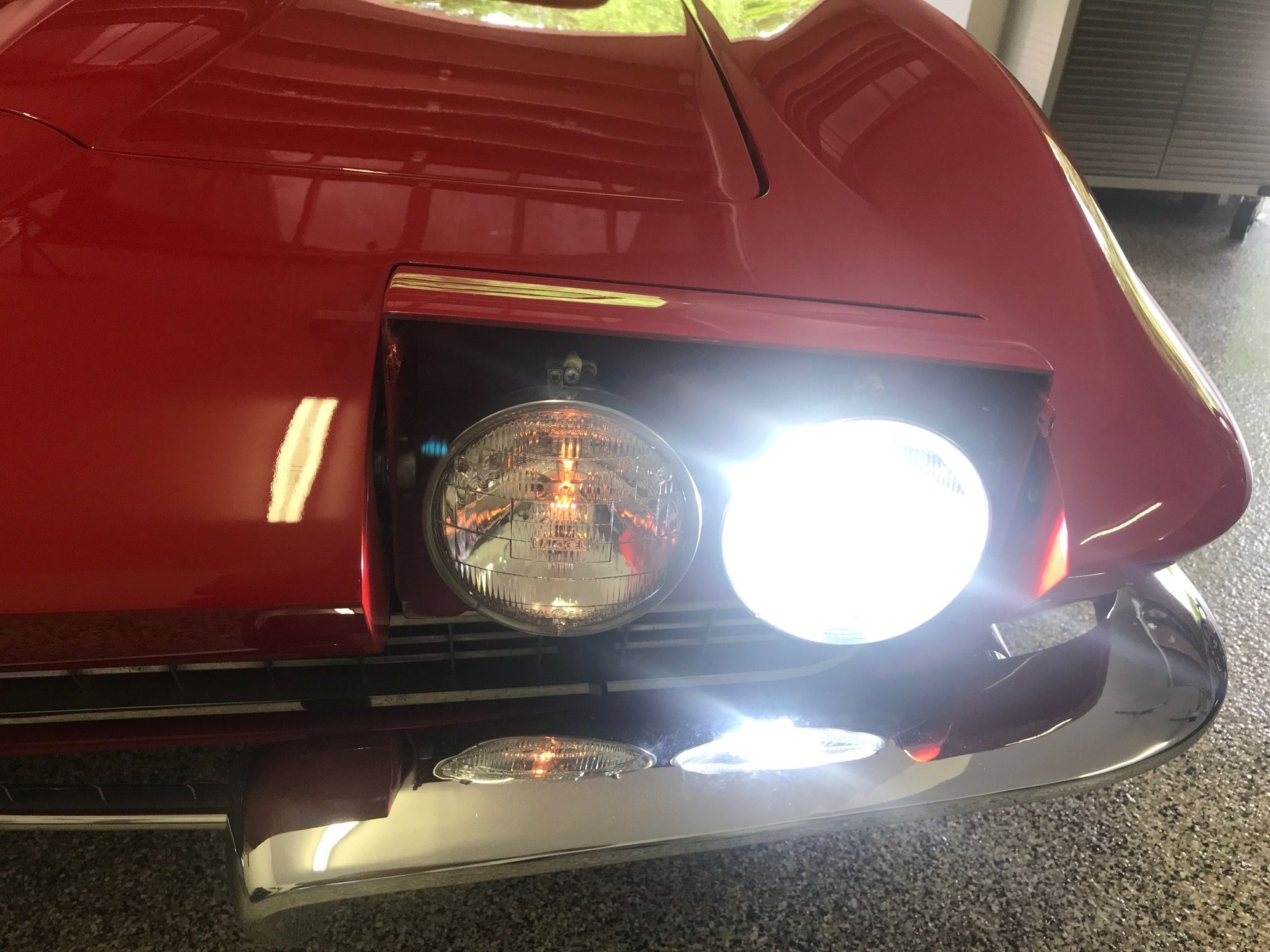

Here is a side by side photo of the Halogen HIGH BEAM to the left next to the new LED on LOW BEAM setting....
Need I say more???
