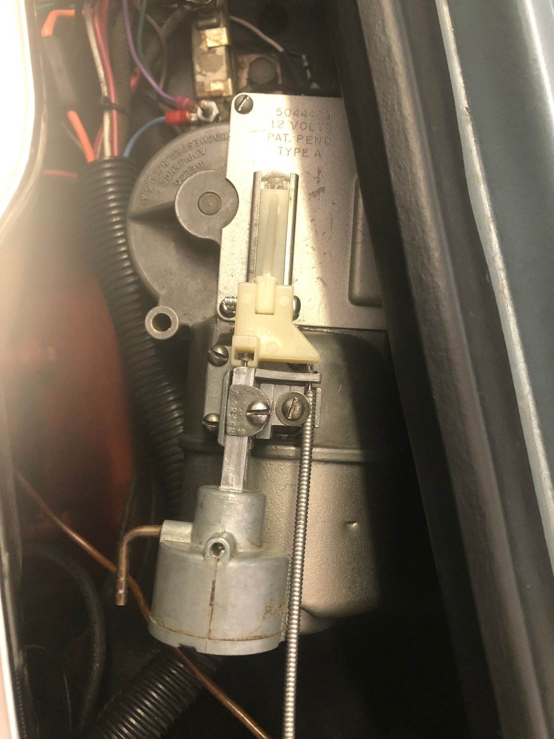

I think I have the wiper coordinator hooked up correctly and, thanks to Rich5962, have the necessary parts now, but I don’t understand how it functions. I don’t need the washer part to work just want the parts there to look correct, but I do want the wipers to work properly.
Something isn’t right, the cable wire isn’t hooked anywhere and appears to just push against the plastic slider to turn on the motor. But the spring action of the coordinator pulls it back so it won’t stay on. The coordinator itself doesn’t slide, does it? What is wrong???

Norm yes it's supposed to slide under the clamp. You may need to file down the square shaft, then add a little oil to it.
The coordinator is normally activated by vacuum, the wiper **** button. It jogs it out to kick in the washer pump system and turn on the motor.

Thanks Rich, I’ll fix that. Must the coordinator be hooked to vacuum in order for the wipers to work?

No not at all. In fact my 59 had no FOA washer system and it had the coordinator too. I did the opposite of yours. That's why I have it in a bag along with the others.

Finally got it all together and adjusted and it works great! I like the way it looks! Thanks to all and especially to Rich!
