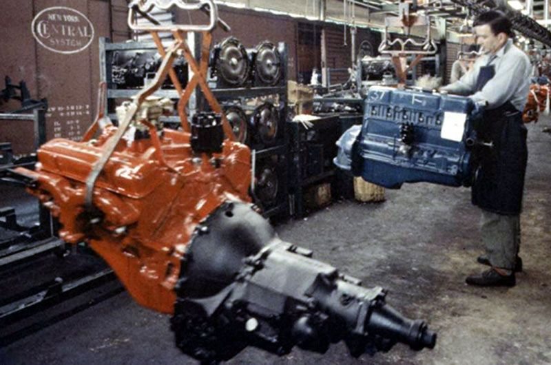

small block and big blocks had the manifolds on
"supposedly" the line worker had under 30 seconds to paint each block
many times the center of the pan had little to no paint......

Great old photo!!!

just think they where doing roughly 250 a hour.
Yep !
wide fan - enamel - hose it on......
some engines were two guys - one on each side
Shoot and go.....
wasnt restoration work.
