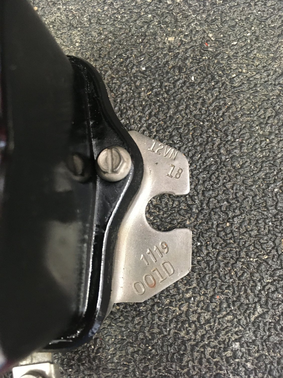

Old Jul 29, 2020 | 04:02 PM
jerry gollnick's Avatar
jerry gollnick
Joined: Mar 2010
Posts: 1,170
Likes: 342
From: boulder,colorado
Is this what you are looking for?

Old Jul 29, 2020 | 05:41 PM
ByByeAmericanPie's Avatar
ByByeAmericanPie
Joined: Jan 2015
Posts: 241
Likes: 9
From: Lynchburg VA
Close! but 001D would be the exact match. If I were searching for date coding, 1A - 1F
Last edited by ByByeAmericanPie; Jul 29, 2020 at 05:43 PM. Reason: Make easier to read

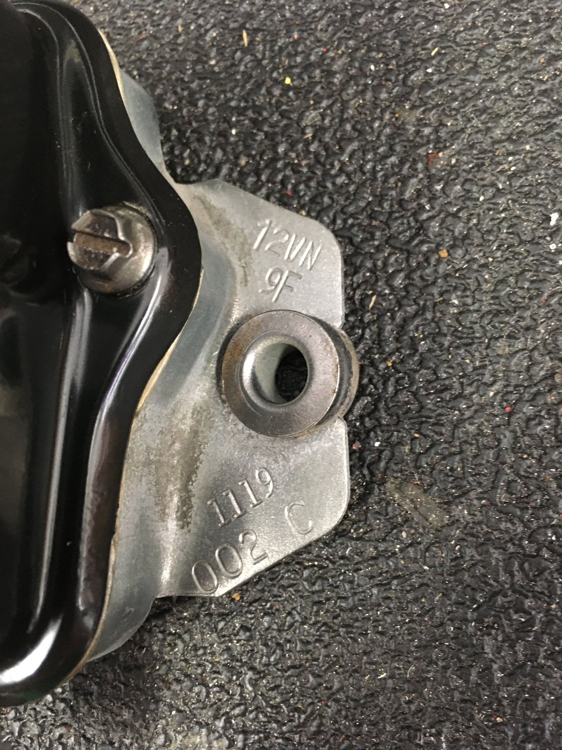

Old Jul 29, 2020 | 07:30 PM
jerry gollnick
Joined: Mar 2010
Posts: 1,170
Likes: 342
Like this?

Old Jul 30, 2020 | 08:46 AM
ByByeAmericanPie
Joined: Jan 2015
Posts: 241
Likes: 9
From: Lynchburg VA
Like this?
Yep, that would be the correct one!
Old Jul 30, 2020 | 05:08 PM
ByByeAmericanPie
Joined: Jan 2015
Posts: 241
Likes: 9
From: Lynchburg VA
On a side note...Anyone venture to guess why the AIM shows mounting the voltage regulator with only the top screw?
And, the 2 bottom attachment points (if you use them) ground the screws to the frame of the VR but the top mounting screw is isolated from the frame....
