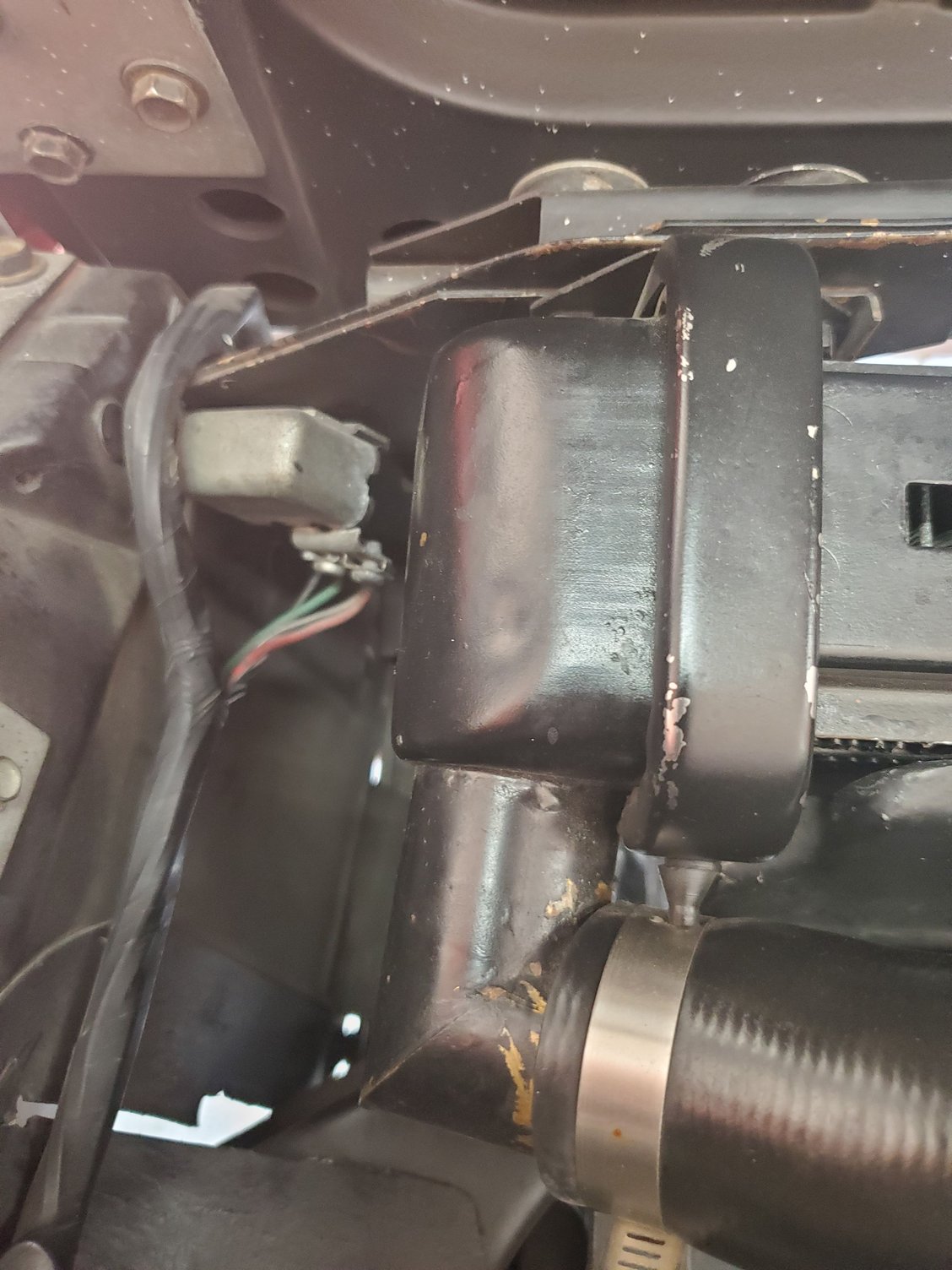

Old Aug 1, 2020 | 04:05 PM
Hoggg's Avatar
Hoggg
Joined: Jul 2011
Posts: 46
From: Omaha NE
Is this the ground for the front blinker?
Old Aug 1, 2020 | 04:15 PM
65GGvert's Avatar
65GGvert
Joined: Jul 2006
Posts: 22,182
Likes: 4,178
From: Kannapolis NC
I don't see it in your picture. I do see the horn relay. The ground for the horns front lights everything up front is several black wires mounted under a screw on the support that holds the radiator. If the other stuff works it would have to be the wire that comes from your front parking light sockets but as I said earlier if your parking lights work then it's not a ground issue. It's probably around the bulbs or in the turn signal switch. Read my other post again and see if anything in there helps with that.
