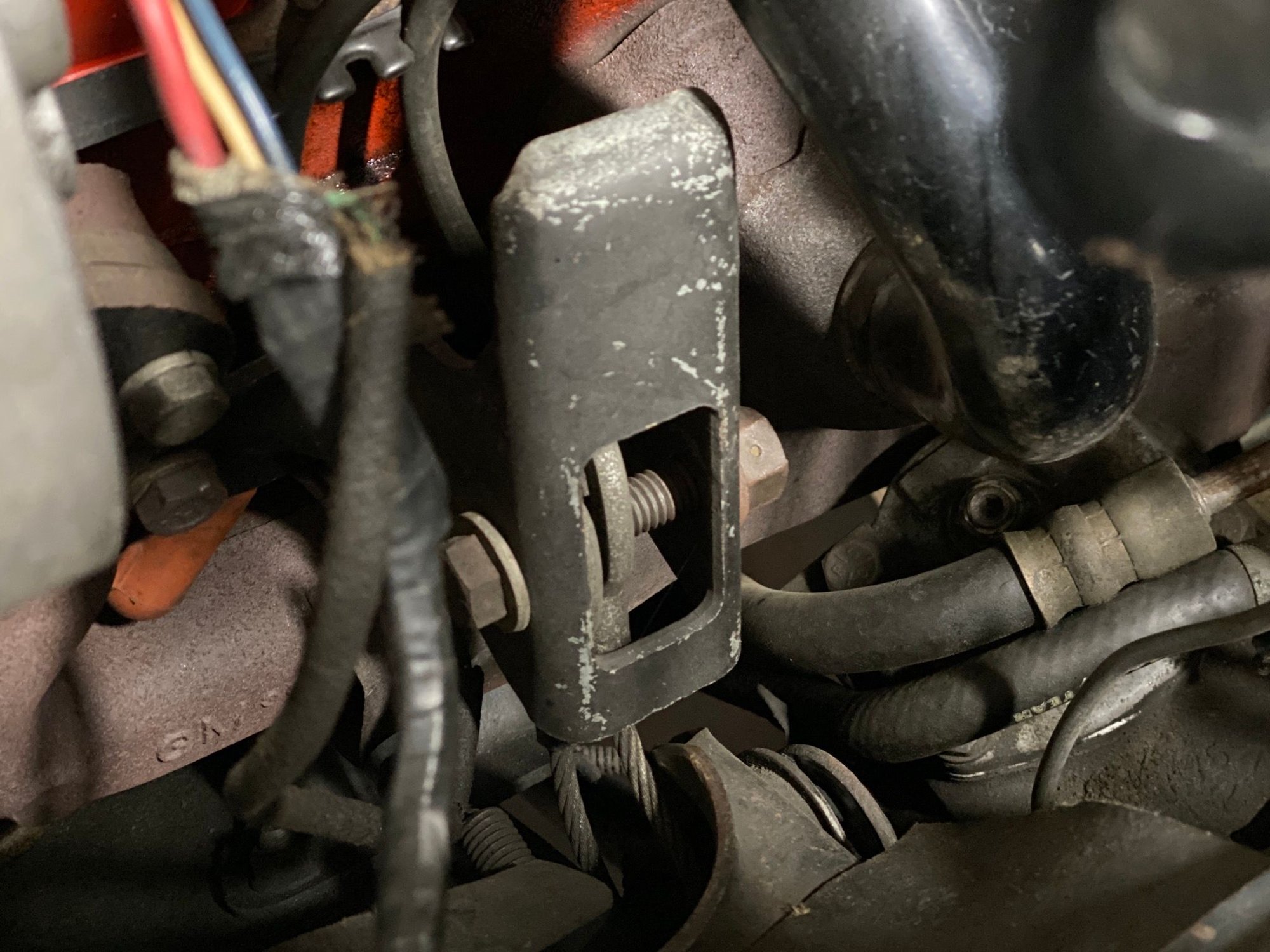

Here’s a picture of my 68 Camaro with the added cable and bracket. Engineering at its finest :-)

emdollar - that's what I was talking about. Missing the bracket on one of my 68s.

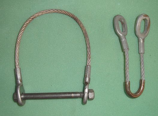

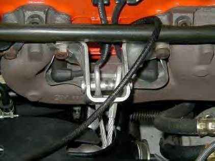

Here's one of the Camaro/Chevelle/Impala recall cable setups; Corvette wasn't affected by the problem, as it didn't go to WOT when the mount separated.

That's the one John. The cable on the right is on my 68RS. The bracket makes it a PIA to change plugs as compared to without it.
Thanks for the pic.
