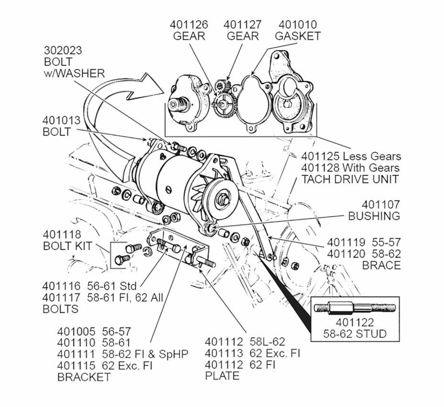

Are you inquiring about the stud to which the generator brace attaches? Assuming so and assuming your generator is on the passenger side of the engine, put it in the upper, passenger side mounting hole.
