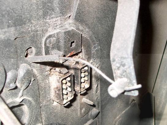

"Go up from underneath with a long screwdriver or piece of broomstick and push rearward on the lever that sticks down just inboard of where the harnesses plug into the connectors on the engine side of the fuse block, and the hood will open. The lever is shown in the photo below. " From a post by JohnZ

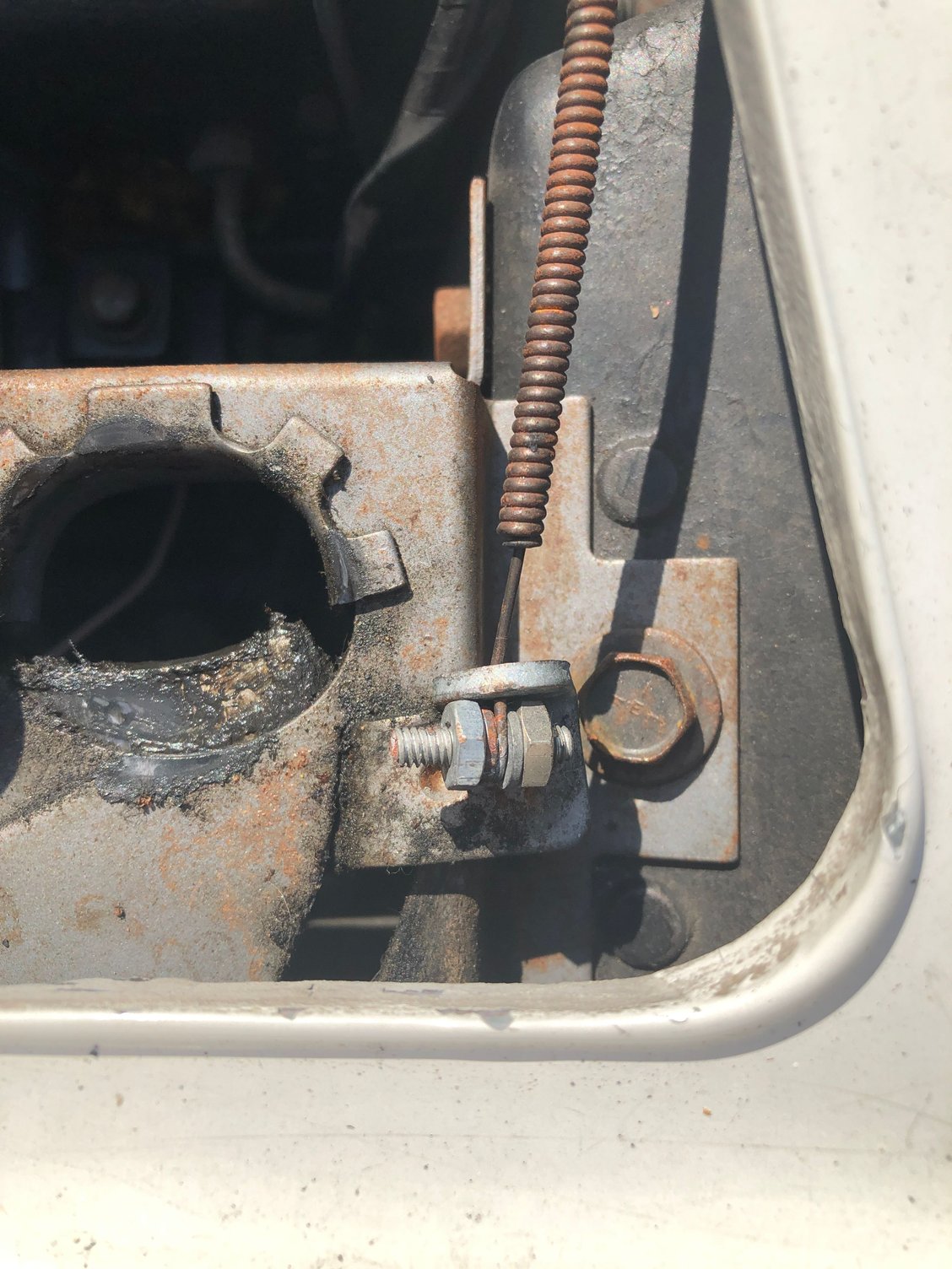

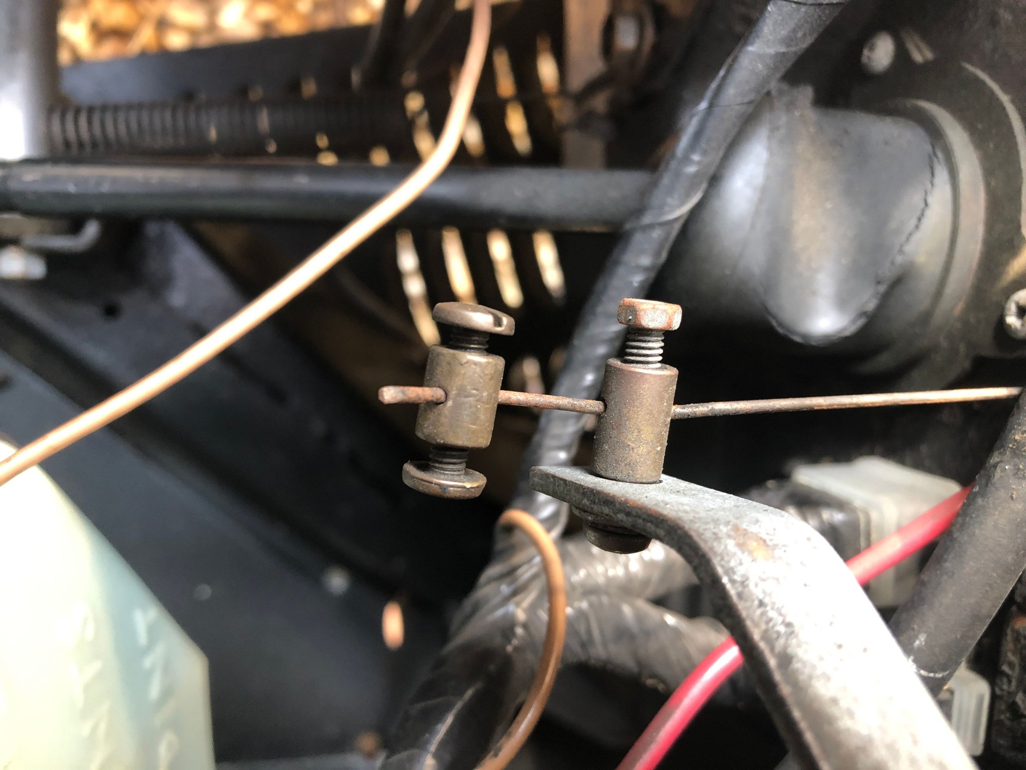

If your cable snapped, and a part is still pinched in the brass barrel, you may need an entire hood release assembly. If it just slipped out of the retainer you can make a permanent fix. Since I had mine slip out, and left me in the same position you describe, I doubled the retainer then made my own. I and others don't trust them. See the pics
enclosed. Dennis

The key to keep the barrel nut from slipping off is simple. Place the barrel nut on the cable, tighten the small bolt, THEN bend the cable 90* just past the barrel nut. This way, if the barrel nut lossens up, the bend in the wire will keep the nut from falling off.

Does such a trick/tool exist for a 1960 without removing the splash shield and contorting my body up there?
Been there before, and now have double cable nuts on a twisted over...but still nervous about closing hood, I kept mine unlatched for a while too.
