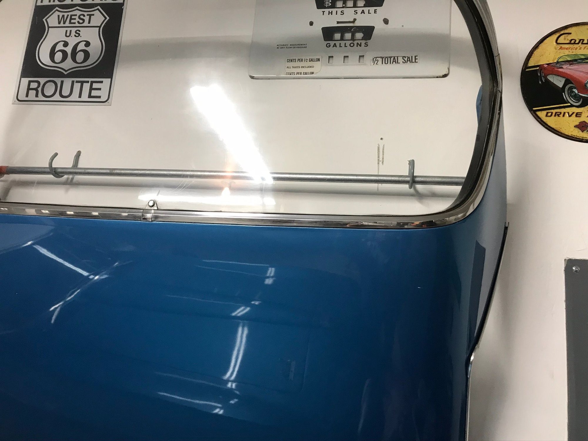

This is how I store my hard top when it’s not on the car.

Very nice setup. Thanks

Corvette Central (And many other vendors) sell this style of hardtop storage...It does take up valuable floor space, unlike warren's slick wall hanging design above, but it is very functional and prevents "speading" of the sides...
That is a great idea. I have been trying t figure out the best way and now I know...thank you!
