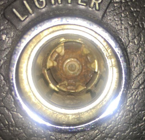

My cigarette lighter gets electricity and lights the lighter, but doesn't get through to my Iphone jack unless I hold it at a certain angle and press in. When I let go, it goes off.
Any quick fixes for that?
Thanks.

Looks pretty rusty Wayne. I would remove and give a good shining up of the entire inside. Easy fix...don't have one.

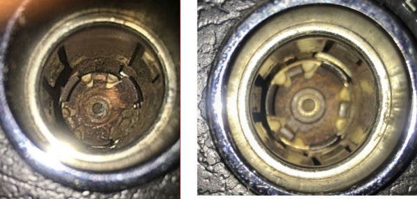

I cleaned it today using a dremel with a wire brush attachment, and Q-tips [with the power off].
Actually it started out as the picture on the left, and the right is after I cleaned it.
Now it works good with the Iphone plug with the longer center rod.

Looks good, well done!

Well done. Corrosion and electricity have never gotten along very well
