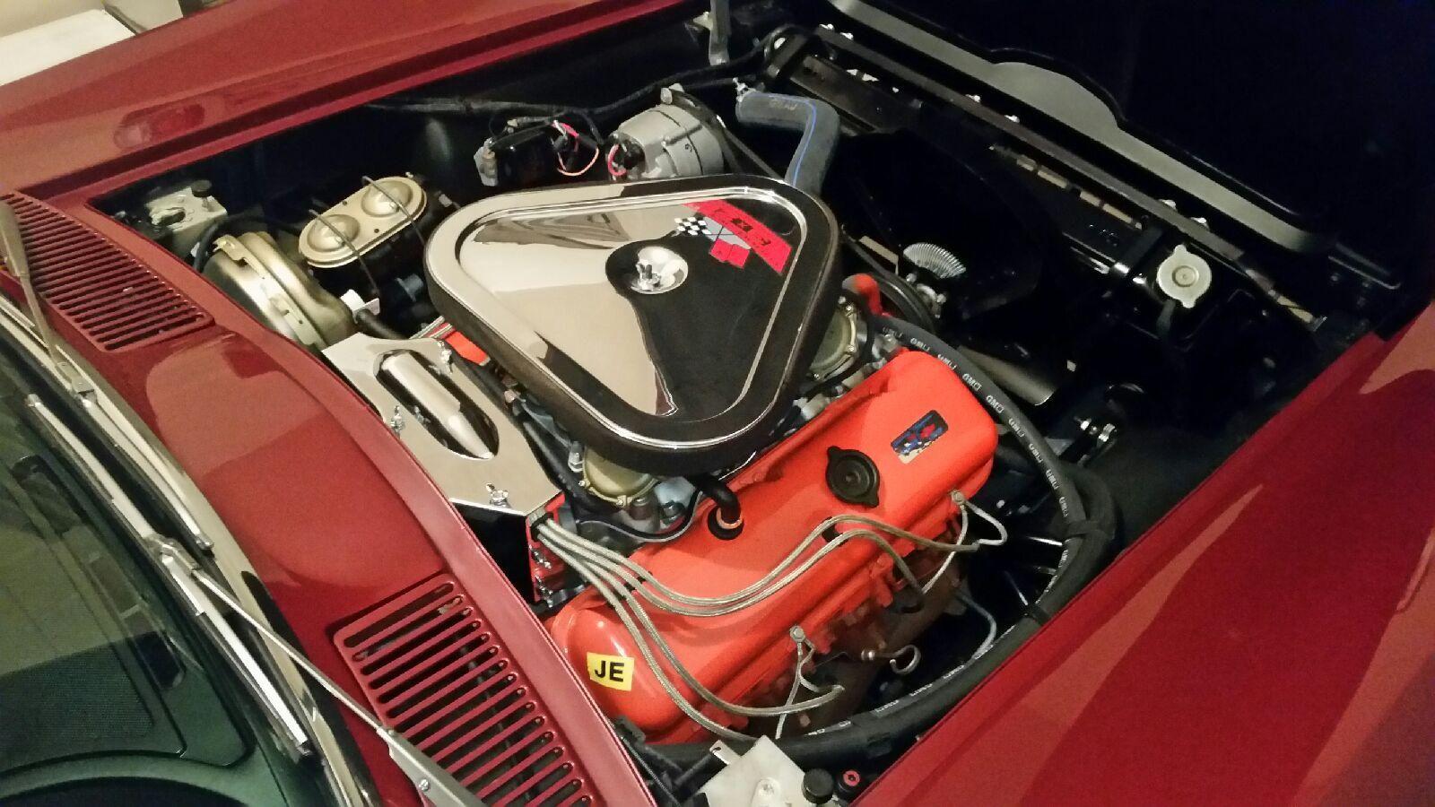

Here's an original Chevrolet photo of a 67 L71 engine compartment from Nolan Adams C2 guide. This overhead clearly shows the location of both the Tonawanda chrome decal at the front of the RH cover and also you can see the engine code yellow/black decal on the rear, flat end of the RH cover. Hope this helps. Cheers, Bill

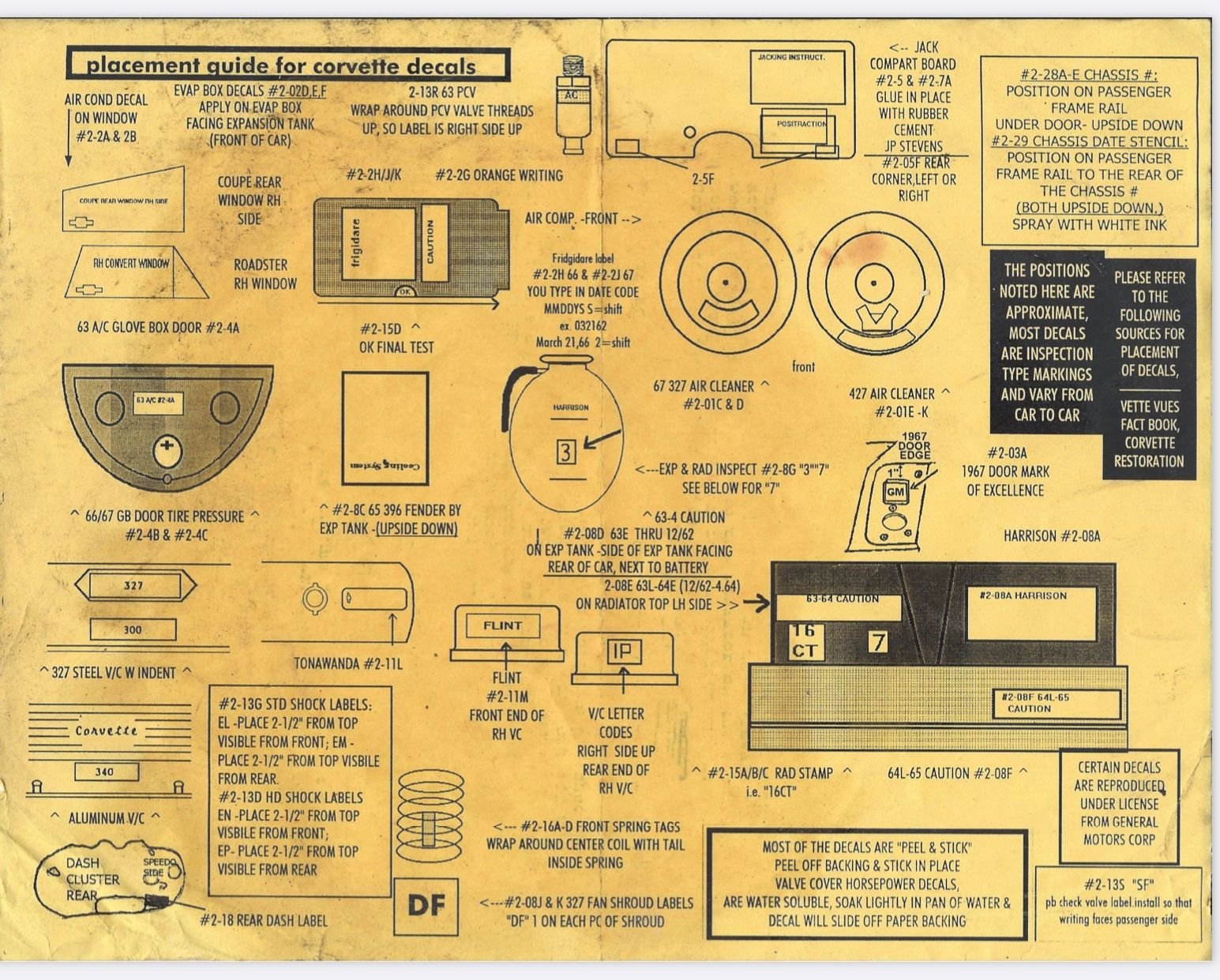

Thank you all. Here’s the photo referenced as a PDF in another thread. Great find!!!!

That is from Long Island Corvette they use to give you that when you bought decals from them

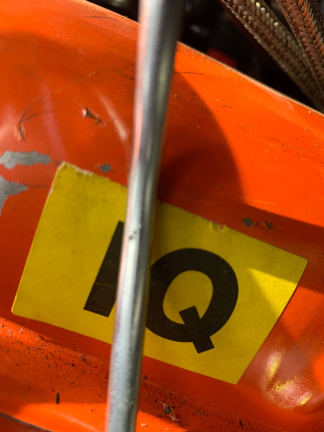

Originally Posted by KingRat
This is the 1st time in 50 yrs I've ever seen an engine code sticker attached on an angle list this. Personally I would NOT use this as an example of how they came out of the factory.
as sloppy as they could have been that is not how they looked

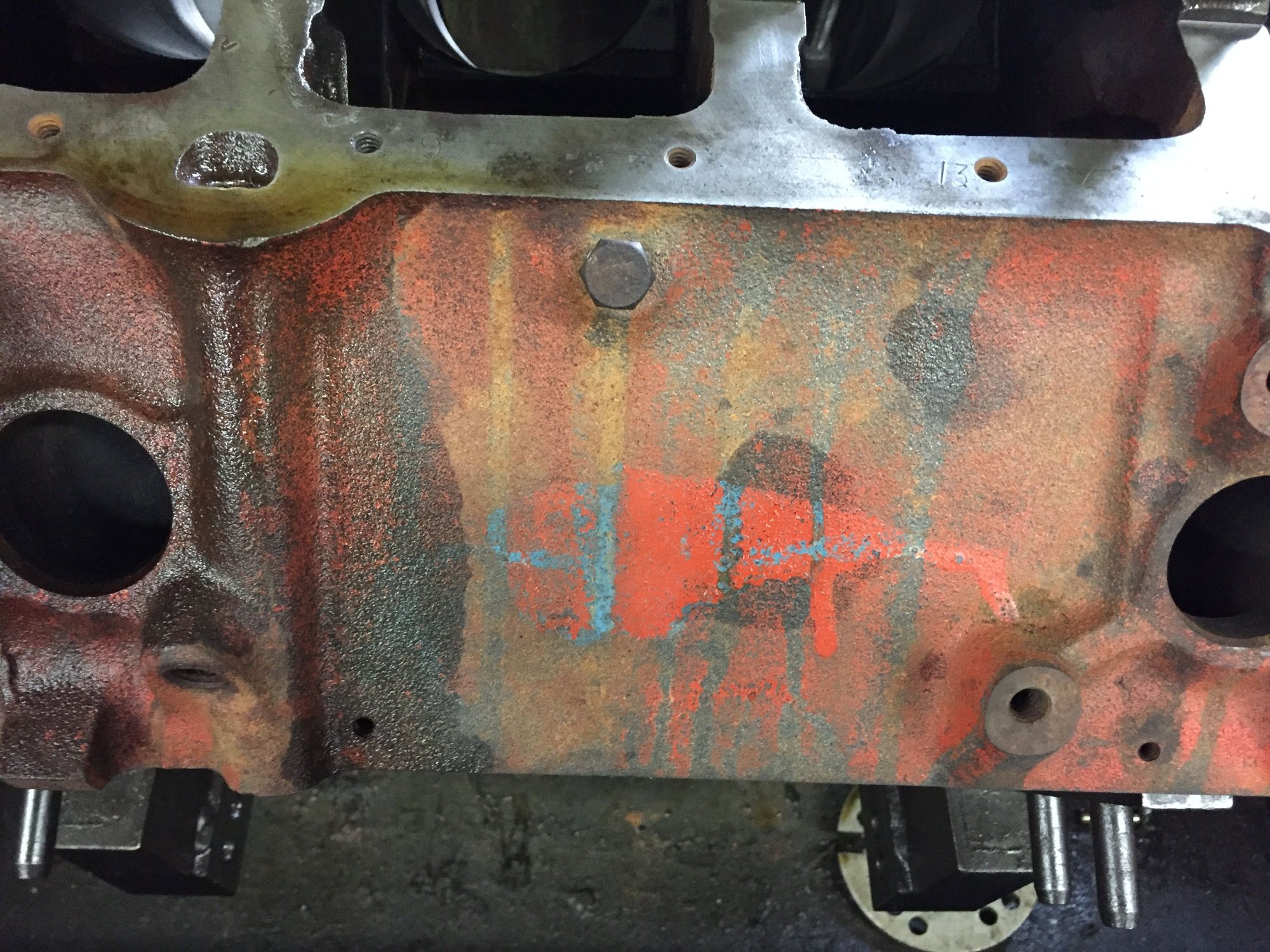

Not a 67 BB, but a different location for a late Sept 65 small block assembly line photo:

427sidepipes for SB that was written in grease pencil there and under the exhaust manifold

Nowhere Man - The GM assembly line image speaks for itself... just pointing out a documented factory procedure, on September 28, 1965.
