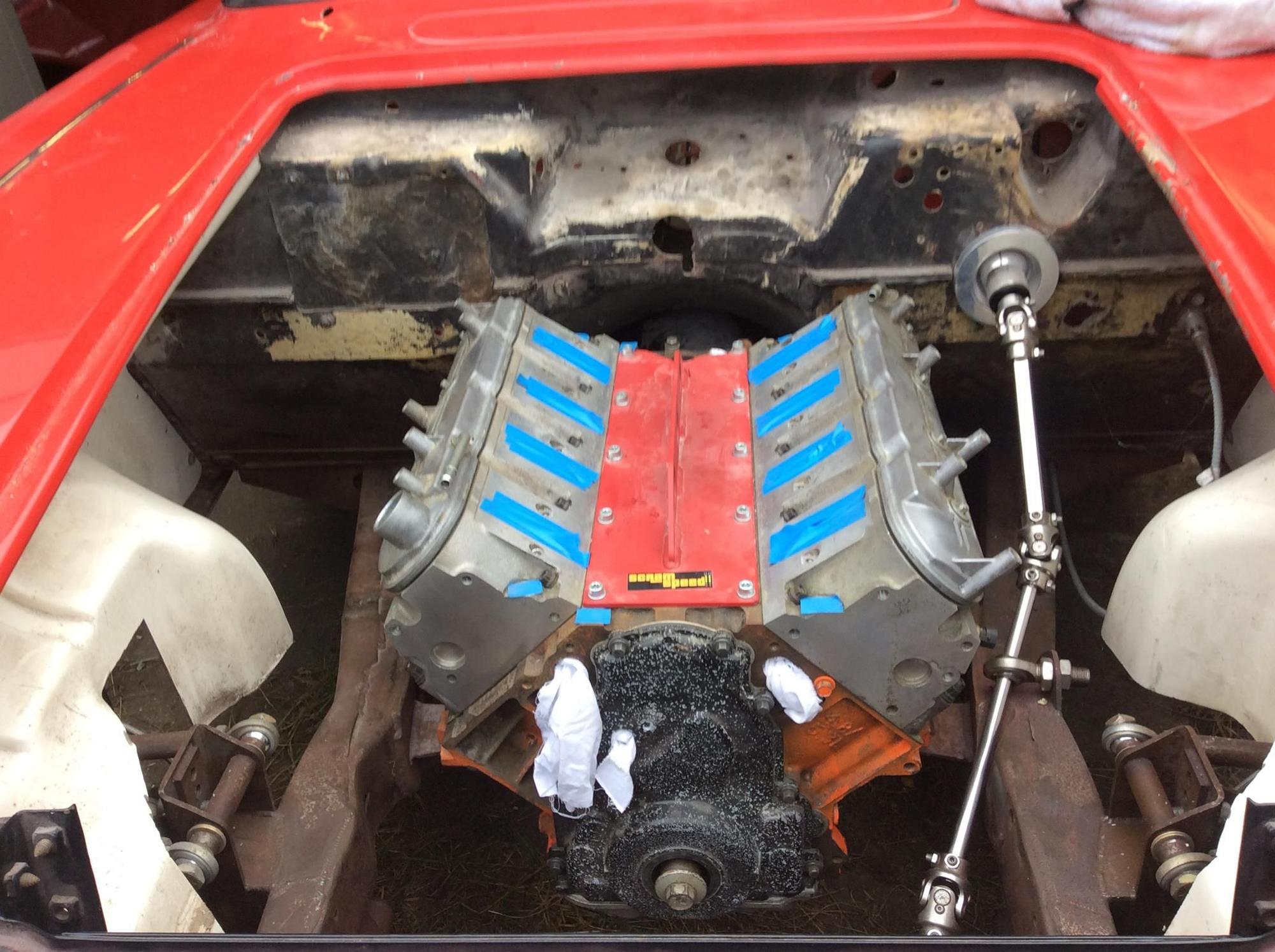

For $500 for a mock up, you can just get a junkyard 5.3 motor. In that manner, you can mock up real motor mounts, exhaust, and cut the pan to fit.
I mocked up an LS motor (an L33---aluminum version of the LS327) in a '60 using a motor plate and the stock mounts. The exhaust manifolds are the sticky wicket, as the frame is really narrow at that point. A set of ZR1 manifolds (relatively cheap on the forum classifieds) can be modified to fit by cutting the flange off and re-welding them as block huggers. With the engine plate, you need to use a racing water pump with no heater outlets. I had kept the stock steering, but that was not really an issue, other than there was no place to put AC pump.
I had the motor mocked up in the car, but did not have the intake completed. There was, by my measurements, sufficient room to fit the low-rise cast manifold and Holly EFI unit using a short air filter that surrounded the EFI.
There are photos of the installation on this forum under my name, if you do a search. It was a lot of work to get it to fit and get a package for water pump to work, and to do it again I would go with either a SBC in a stock chassis, or an LS motor in an aftermarket frame. The benefits (run on pump gas, cut some front weight, cool factor of LS in a stock chassis) did not warrant the amount of effort and the car would still have a wet-noodle handling. For this car, I abandoned the LS motor for a 60's period-correct 327 to maintain the full C1 driving experience.

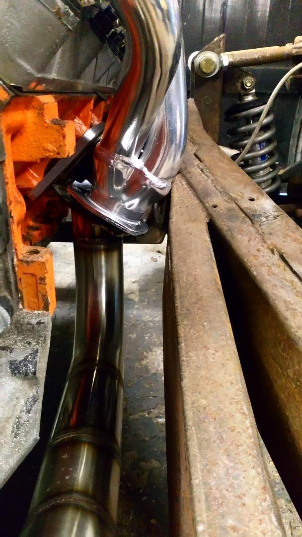

Jon i have used hooker bloc huggers but modified my steering mount to accomadate them the flowtechs might clear the meyer bracket

Wow, those are some really nice looking shorties, even with the tight fit they look awesome.
I see how you moved the bracket for the heim joint, I guess I can do that also if the Meyer setup does not fit.

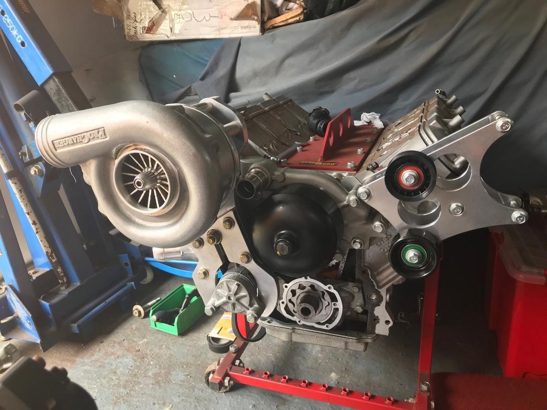

sorry Jon my body is still off the chassis and engine not installed yet(dealing with an oddball crank problem) 1 thing to keep in mind whatever serpentine system you use it has to match the dampner I.E corvette/firebirdcamaro/truck also besides the car/truck waterpump differences there can be some variation where the tensioner bolts to the waterpump i have used a few ICT BILLET parts for my build
Sister Mary Francis!!! Is that going in a stock chassis car? You are insane!!!! Can't wait to see it finished....
