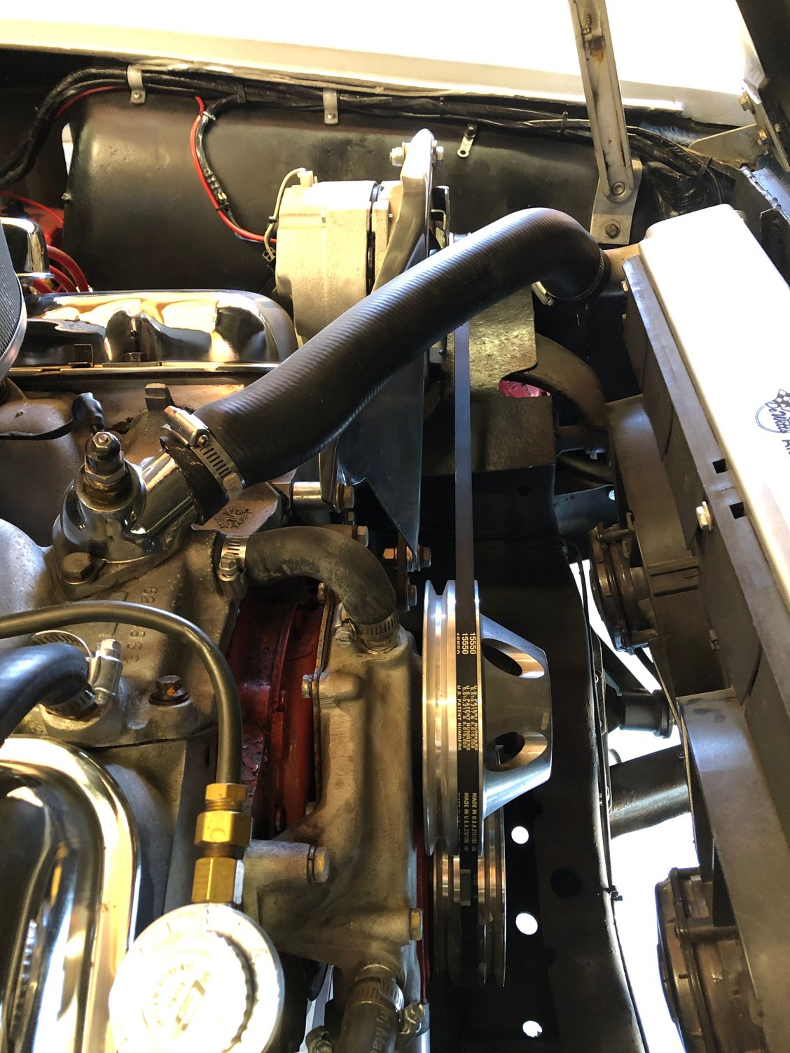

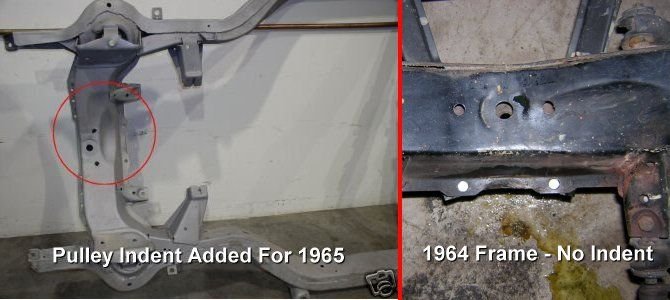

My SBC 65 was built 6/65 and has the sidepipes, not sure if it has the keyholes. It may have had the motor indent but maybe was cut out to accept a larger aftermarket 454 harmonic balancer. Curious!
Does anyone have a pic of the motor indent?

To the OP, if your 454 has a long water pump on it, the lower pulley will not clear the frame indent and would have to be cut out. I am not sure if a midyear will even work with a long water pump, but this could be the reason. Post a pick of the front of your engine.

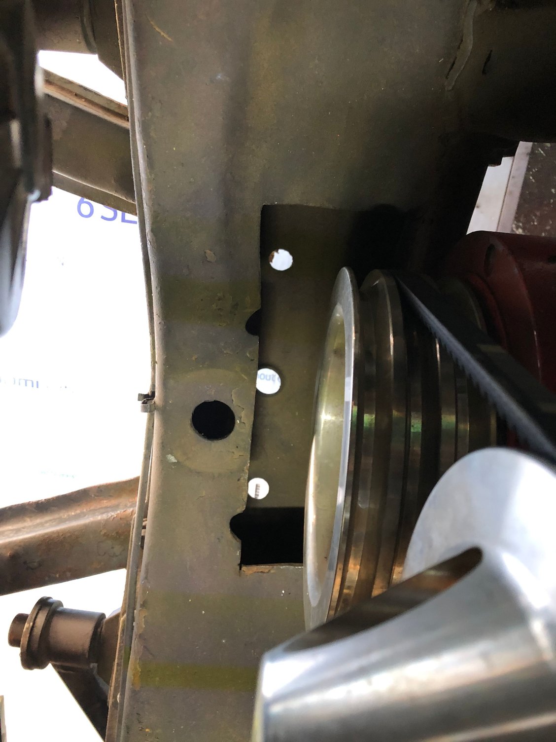

Well, can’t tell if mine had the indent or not since it’s been cut away. Looks like a bit of overkill but I guess they wanted to make damn sure the motor cleared.

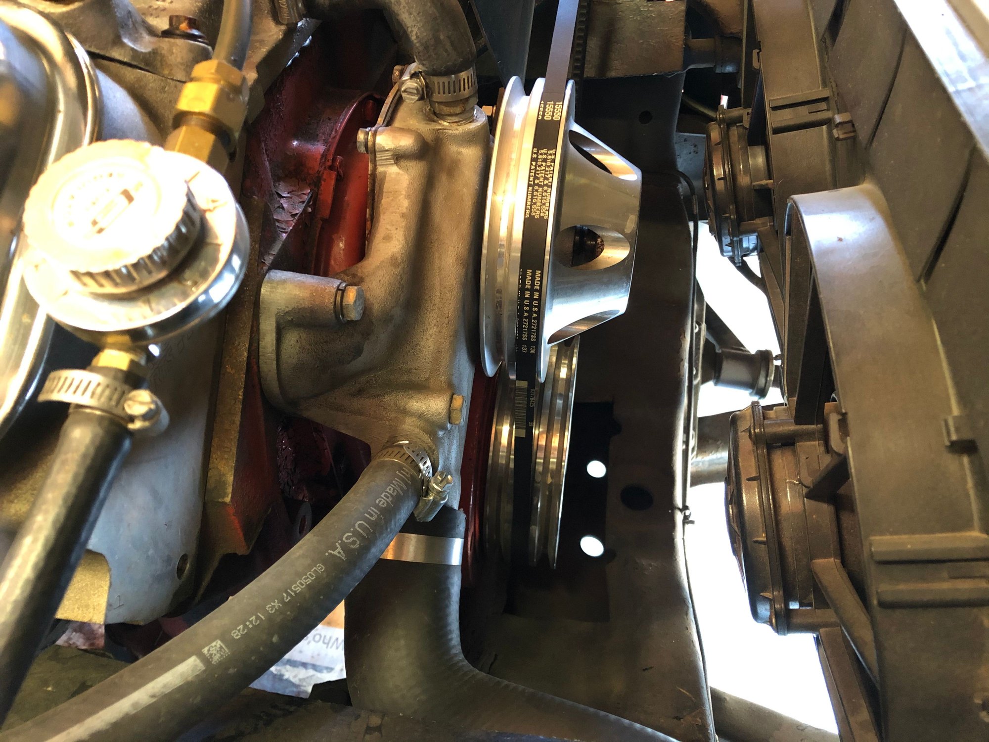

Post pic of water pump, those pulleys look pretty large diameter and three wide. Looks like bubba paid your car a visit years ago.

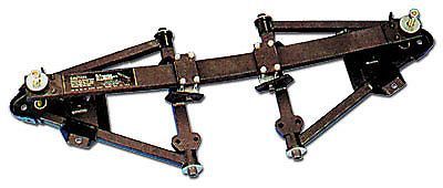

I have to ask, what kind of front suspension do you have? That's not a stock lower a-arm bushing.
VBP composite spring

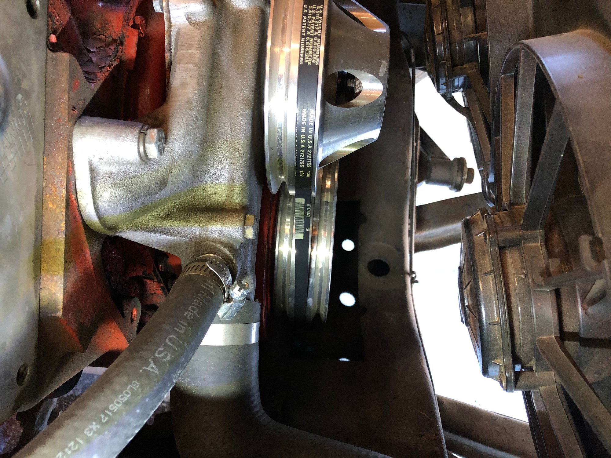

Bottom pulleys measure 6”. Don’t know why multi groove.

OK, short water pump also which is correct. Probably no way to tell whether it had the indent or not originally. It can always be welded back in, but that is a lot of work and you would obviously have to remove the engine.

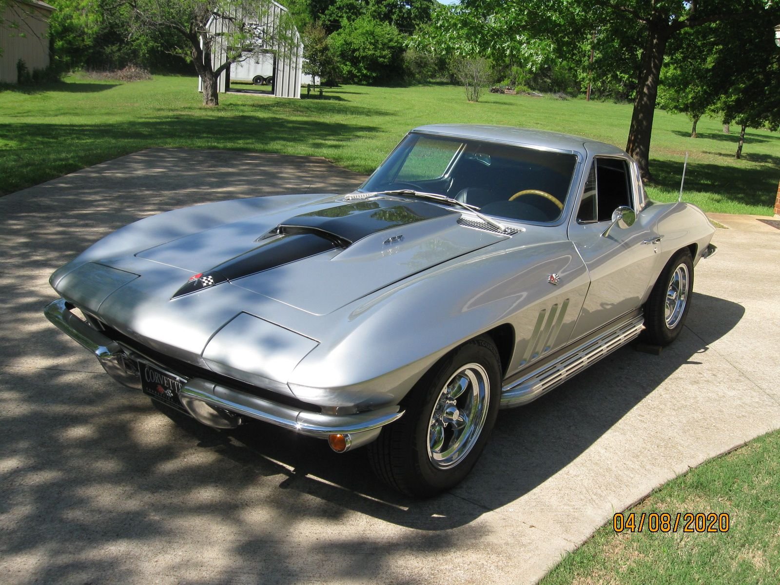

Is the car in question the silver coupe in your avitar? It is a good looking car if it is. Post a better picture of it!!
