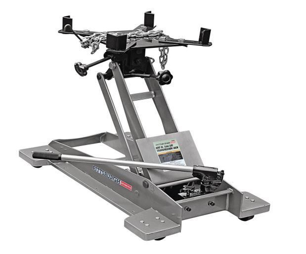

Personally, I think it easier to leave the engine in place. To pull the engine, you have to remove the radiator and shroud, and then there are a bunch of wires, hoses, and fluids to mess with. If you have power steering and/or air conditioning, there are even more things to disconnect and move out of the way.
If you put the car up about two feet on jack stands, it's pretty straightforward to get the trans out. As a substitute for a strong helper, I really like this 3-axis transmission jack from Harbor freight:
https://www.harborfreight.com/800-lb...nsmission+jack
The key features of this jack are those two ***** in the photo. In addition to changing just the height, the transmission can be tilted in any direction, and can remain in that position as long as you like. It's like having an infinitely strong and infinitely patient helper.
I have used this jack to install a TKO 600 5-speed with the engine in my car. That installation is far more complicated than a stock 4-speed.
