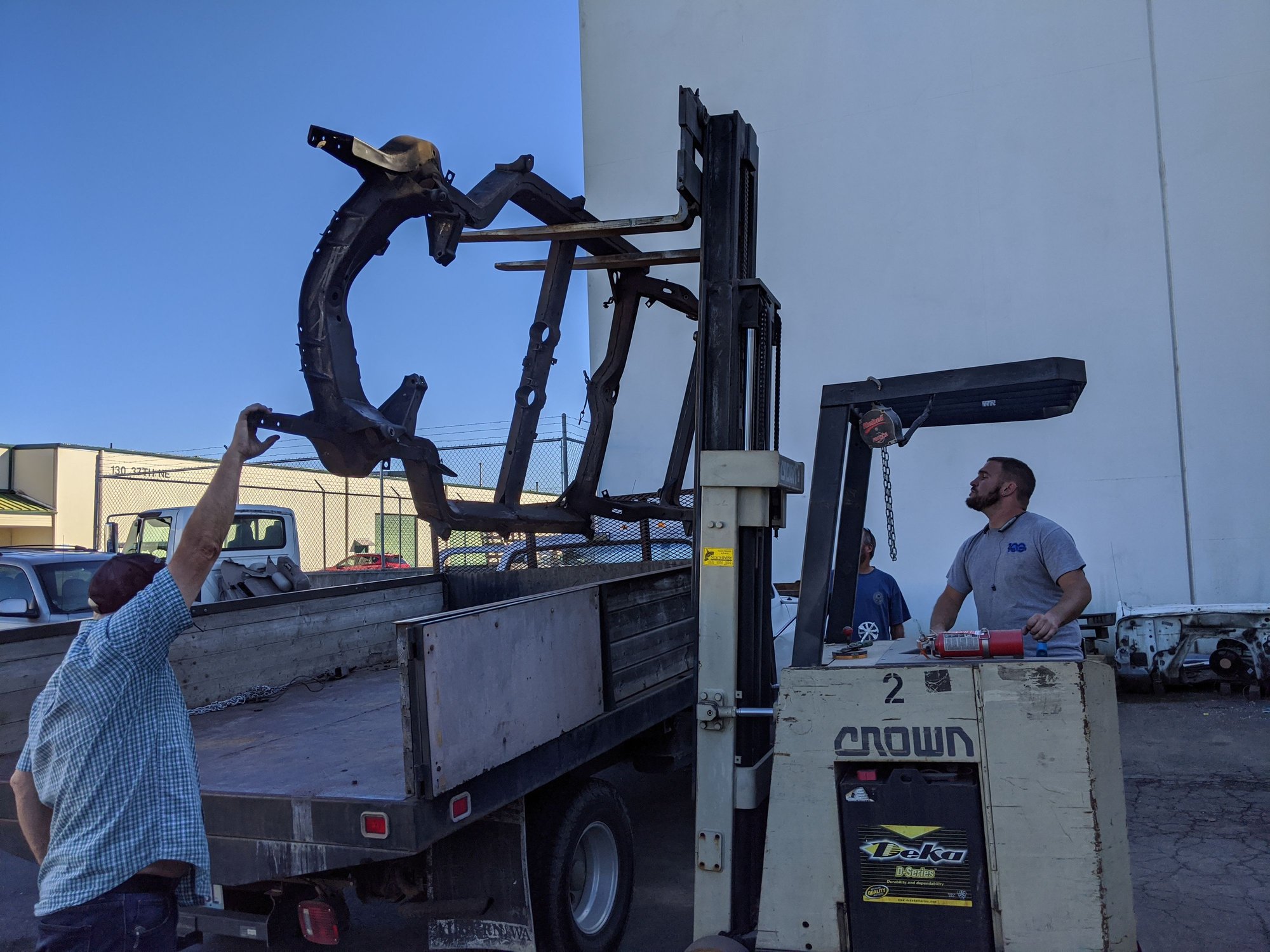

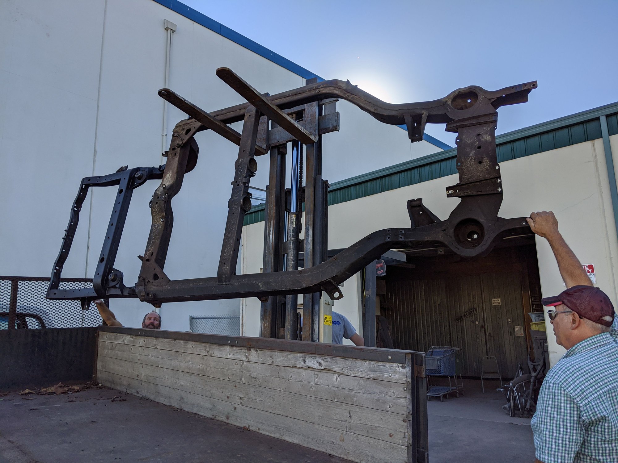

Hi, I've posted with questions about Vin location, differential removal, etc. Today the frame went to the sand blaster. Will post pics so follow along with me. It was a nice afternoon here in the Pacific Northwest.

You might want to remove your seat belt cables..

Good eye, I wasn't sure how to remove them. I was told they were OK, he could work around them.

Do your cables still have the 'plastic' on the cables?

Yes, a black cover.

Hope they can protect them when they sand blast....
They are easy to remove...unbolt the outer ones, the center one, use a large flat top screwdriver in the tab and bend it over just enough to get the cable out...then put cable back in and use a hard rubber hammer/dead blow and bend the tab back into place...

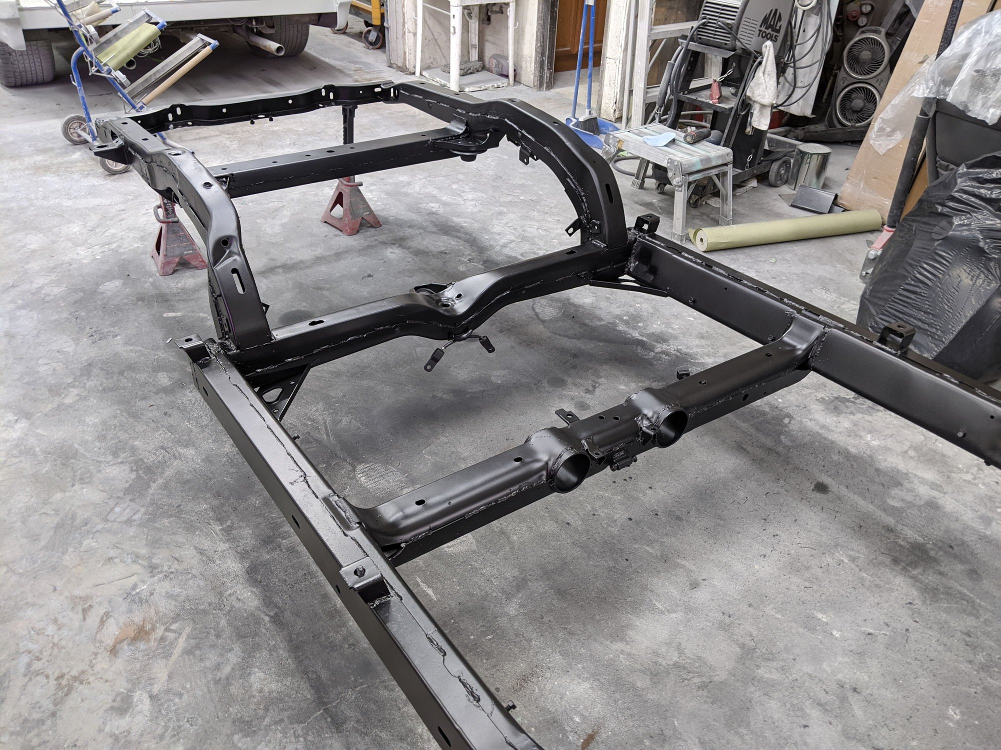

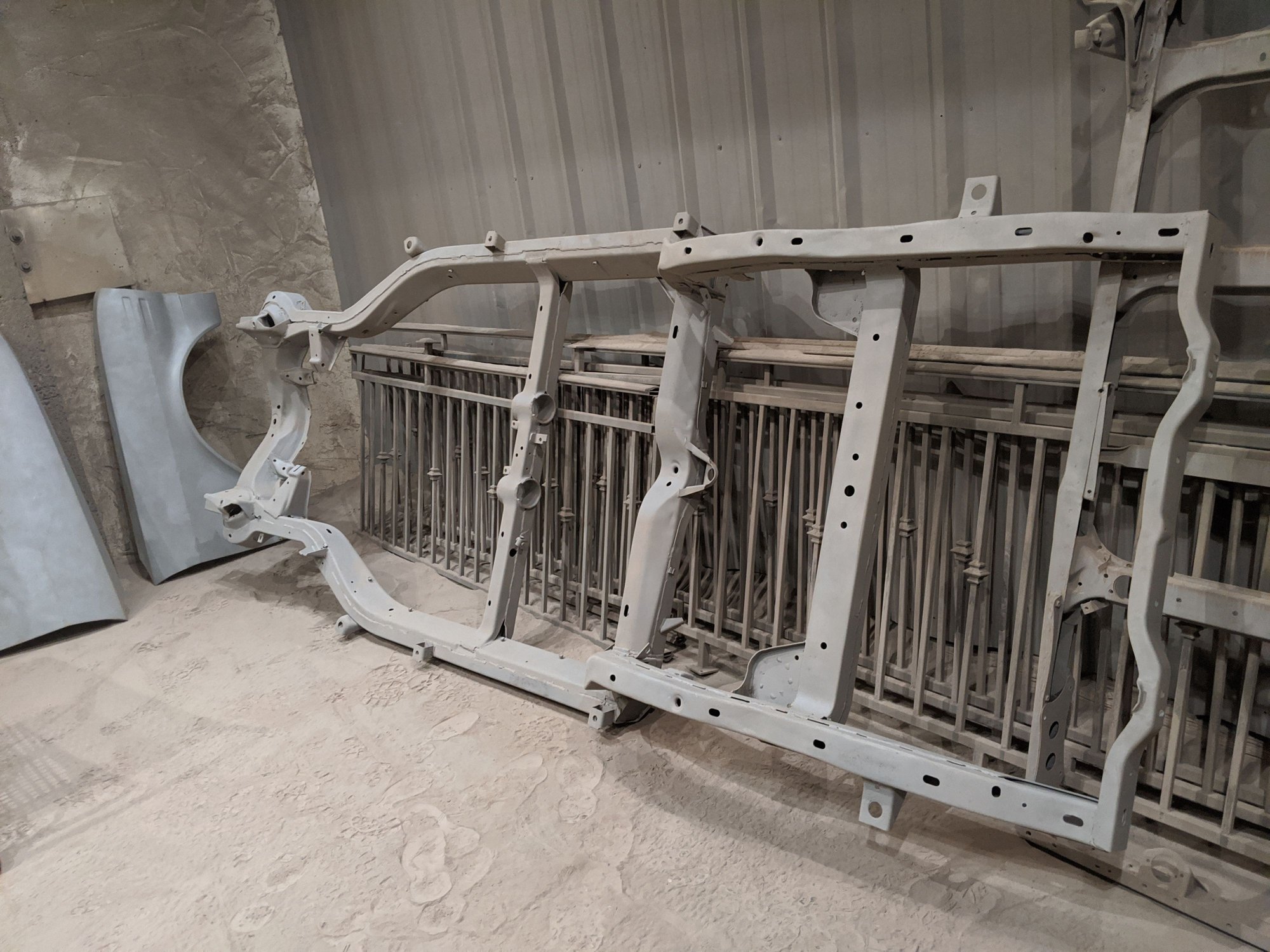

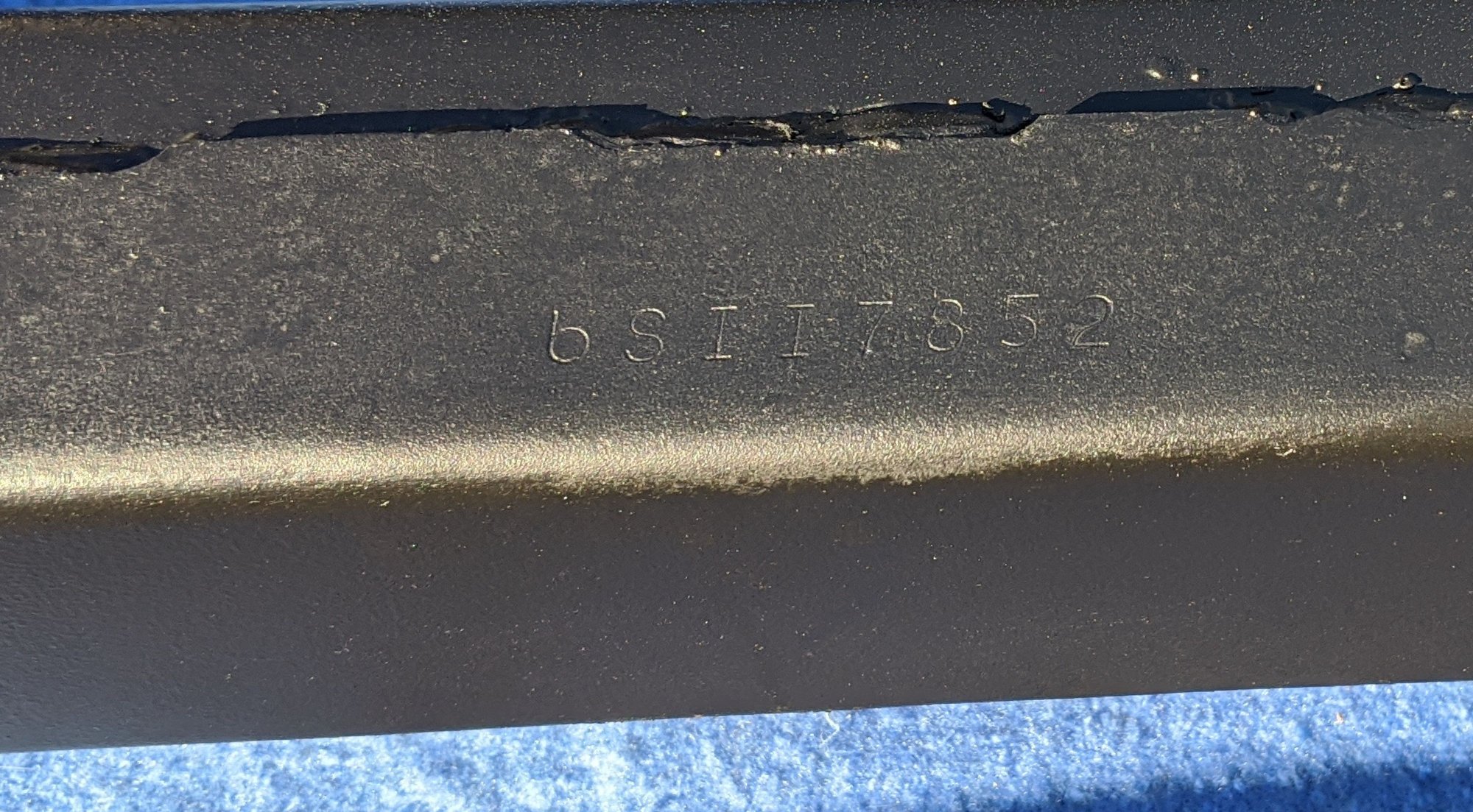

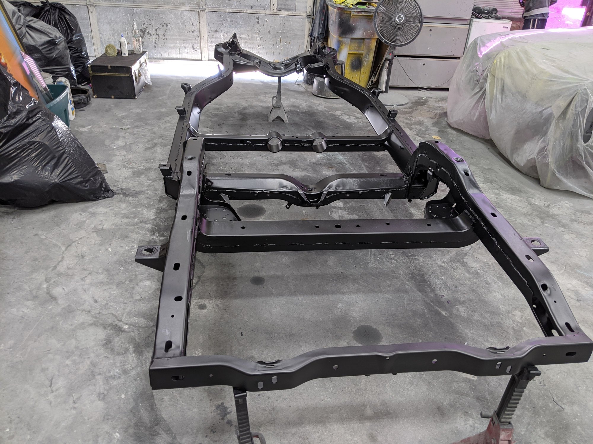

OK, it looks like pics are reversed. Moving along, the frame was sand blasted then off to the painters. He did a great job and after sand blasting and painting the VIN still looks like it was punched yesterday. So far so good...
