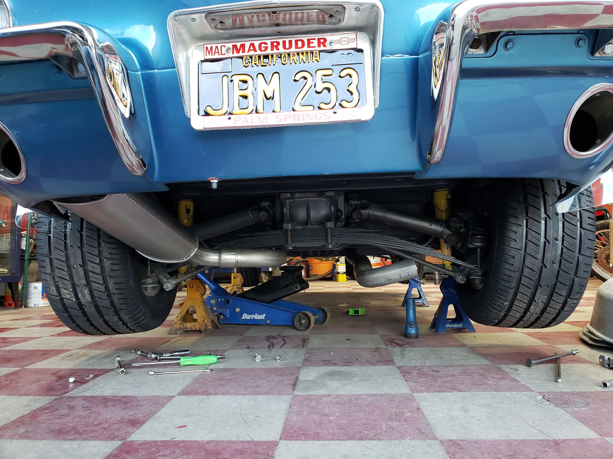

I also have a pair of air shocks on my '65. I wanted a period correct look which included a set of TorqThrusts with 11 inches of rubber on the ground and the rear slightly raised. I also installed a new rear spring as one side of my car was almost an inch lower than the other from spring sag. karkrafter is right, the air shocks are very affordable. They will buy you some time and hold the rear end of your car level. One thing I can mention, with the Corvette's rear suspension set up, the amount of travel is much less than you normally get with air shocks on a Camaro or Chevelle. My max lift when fully inflated is only about an inch and a half. Sure, ride is a bit stiffer but hey, it's a Corvette. If I wanted a soft cushy ride, I'd buy a '68 Cadillac.
