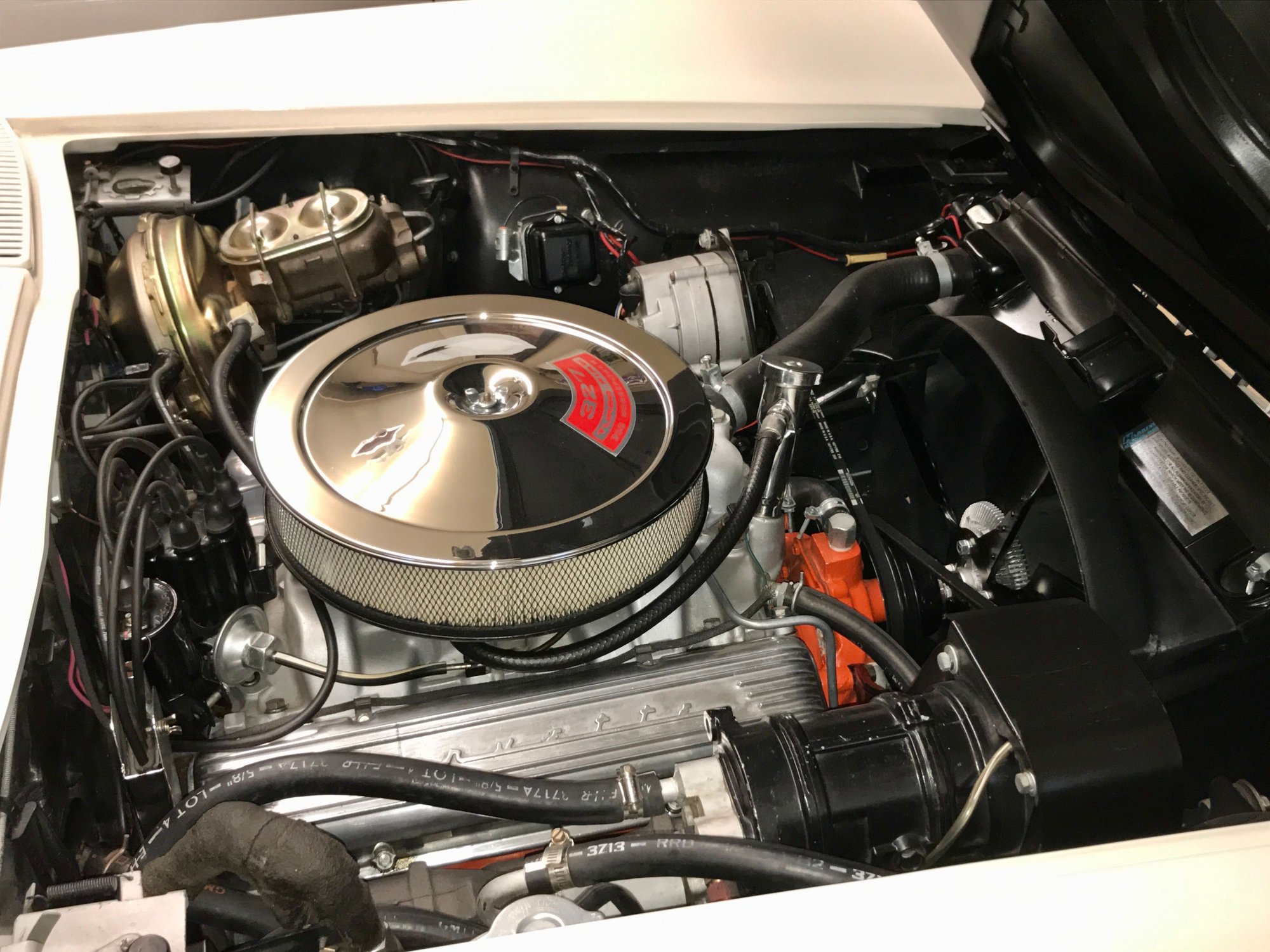

There are A6 replacement compressors and, then, there are aluminum replacement compressors that will adapt the factory hoses, etc...but, I don't believe there is an aluminum A6 compressor. The Pro6Ten is an aluminum body compressor that bolts directly to the factory brackets and fitting lines...but, it doesn't really look like a factory compressor (see picture below).
If you're going for an "original" look you'll want to get another A6 and put your decals on it.
My Pro6Ten with a oil sling shield attached.
