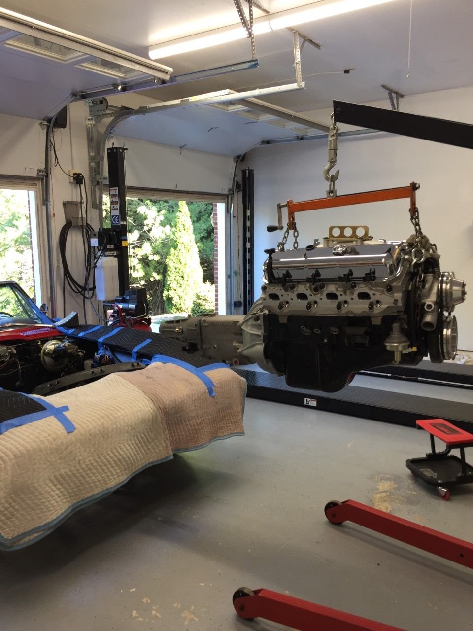

I have done it both ways. Pulled out the engine separately from the transmission and the transmission separately from the motor. In addition I have also pulled the engine and transmission all as one unit and installed both as one unit. My vote is for removal and installation all in one unit. I did mine on the garage floor with a standard engine lift and a leveler. I had attached a carb plate to the top of the aluminum intake manifold for emergency purposes but ended up not using it.
Vette5311 is correct and you do have to make sure that you have enough room behind the engine lift to push it back away from the car or toward the car depending on whether or not you are installing or removing. Another option would be to leave the engine lift where it is and slowly roll the car forward or backward into the correct position as needed. Or a combination of both as I did. Regardless, good luck with it. C.J.
