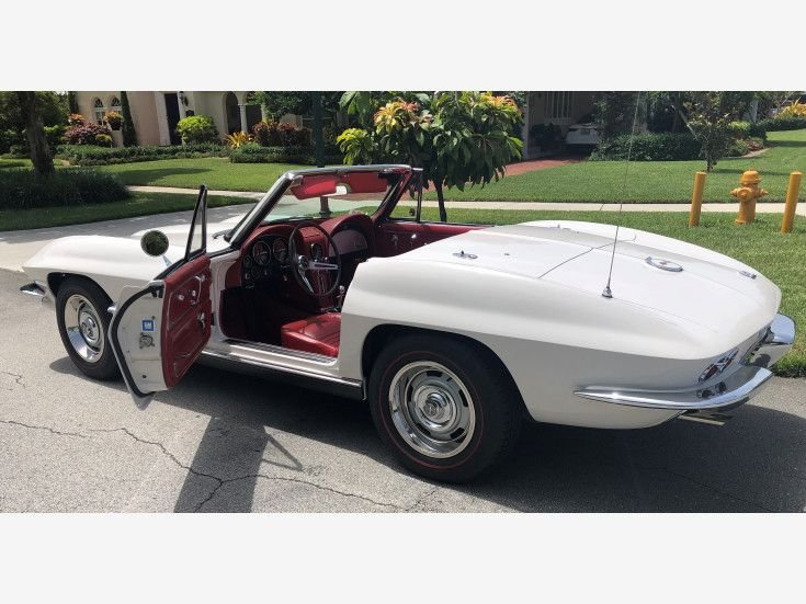

I'm a proud first time Corvette owner I recently bought a 67 L79 which was delivered in mid November. The car came from Miami to my place in Syracuse, NY. I've started the car only 3 times since I got it, the day it arrived, Thanksgiving morning, and most recently this past Saturday when I added fuel stabilizer and ran it for a while (10 min). During each start I noticed thin white smoke coming out of the passenger side rear exhaust and no smoke out the drivers side. The exhaust didn't smell of antifreeze or oil or anything other than typical engine fumes. The engine was completely rebuilt in 2018 and the previous owner and the car inspector claim the car didn't
smoke when starting or running. My question is is this normal? If it is, shouldn't the smoke come out both exhaust pipes? I'd like to add that the temp was below 40 degrees each time I started the car. Thanks for your input.
