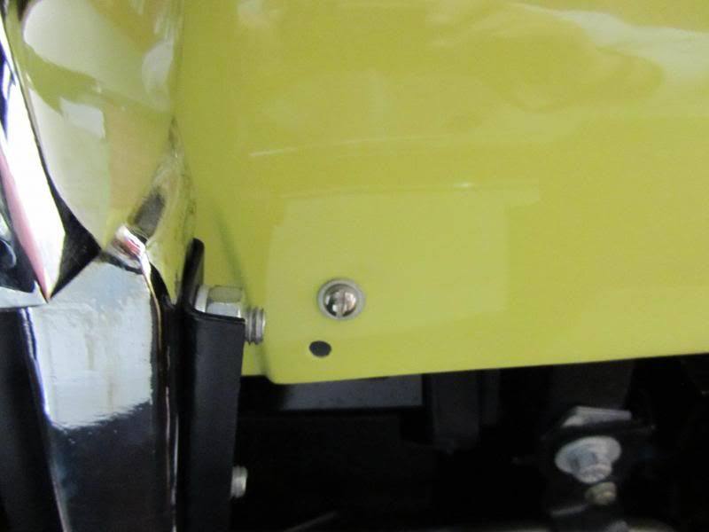

I'm getting ready to reinstall the front grill and bumpers and realized my car is missing something...
1) My 66 (427/390) is missing the small brackets that connect the bottom of the radiator support to the bottom fiberglass piece of the front lower valence. What is this bracket called and any idea where I might find a pair?
2) My valence has two holes on each side (pic below), but the bracket only requires 1 hole. I've seen another 66 that has 3 holes where only 1 is used. What are these other holes for?
Thanks!

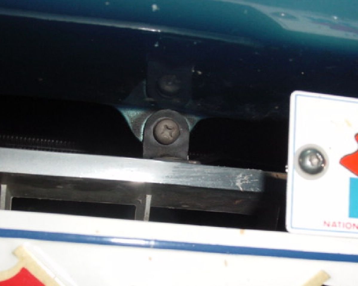

Here's what the phillips bolt looks like. Black phosphate. This pic is courtesy of John Hinckley's 67 but these are the bolts used on the grill center tabs both top and bottom. Bill

Here's what that area should look like; those two lower valance bracket screws were driven in the Body Shop (in the front clip bonding fixture) long before Paint.
