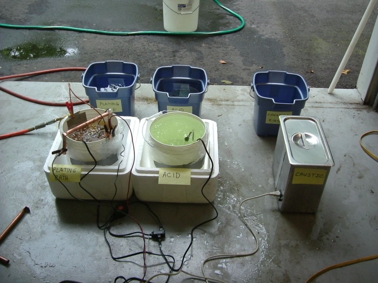

Regarding the Caswell System, I got excellent results once I mastered things...can be a learning experience. Several years since I used it a lot, My suggestions would be to have a plating rectifier for setting constant volts and upto 10 amps. At the time I found a digital display unit on ebay for around $60 to $70. Required plating amperage is a simple calculation based on surface area to be plated. IIRC seldom if ever did I use more than 5 amps and it only takes five to ten minutes of plating. Dependent upon the amount of "brightener" you add in your solution you can get results from dull to near chrome appearing items. If you want the gold appearing zinc you will have to add a process and buy additional chemical which is not an electro chemical process but a dip of seconds. I only used this dip process when I did my 2x4 carb choke and main bodies.
I used plastic 5 gal buckets for everything and believe at least 3 gal solution setup is best. For more consistent plating, use two zinc anode placing them on each side of the bucket. Yes, blind spots do not plate very well but you can rotate the item during plating and get very acceptable results. While plating my door window channels and seat tracks, only half of the item could be submerged. I found that you can plate half of an item then the other half and during the buffing process the overlap area polishes out and disappears. Just an after thought, I could have changed from a five gal bucket to a long piece of large diameter PVC pipe with cap on the bottom too. Point is that you can be creative for your plating "tank"..
The most time consuming and critical part of the process is prep before you plate. A perfectly cleaned pitted item will plate showing the pits...metal condition is a factor. To me, most items with surface rust only came out looking very nice. I would also recommend that you wrap your anodes in bandage gauze while plating. And, when finished, wash the anodes for storage until you use again.
Bottomline, I highly recommend the Caswell system. Hope this helps?
edit: Just remembered, temperatures and agitation play an important role also. I used some fish tank heaters and small fish tank pump for agitation.

I had a Caswell system for years and I did a ton of vintage motorcycle parts that still look great. As tgtexas02 said, it is not a plug and play system. I spent a lot of time experimenting with it before I got really nice results. If you are doing one car, I suggest sending the parts out. If you expect to be doing other projects, it is a good alternative and you do not have to wait to get your parts back. Doc

I separated my parts into those that would never be seen such as inner door items and those open to the eye such as a trunk latch cover plate. For those never seen I just wanted them cleaned and protected and I didn't really worry about dull versus shiny and so on. For the visible stuff, I was much more methodical regarding appearance. The more I experimented and used the system the more I could predict an outcome before ever going through the entire process. Consequently, I would start with stuff that will never be seen as you progress and learn.
The Caswell instruction book is a great read and if correctly followed the system works, is predictable and is repeatable. I actually did some pre-pre-prep. Before getting into the actual plating prep, I would do an initial degrease using water and arm & hammer washing soda in my sonic bath. I also bought a 5 gal propane turkey fryer and boiled larger parts in water and arm & hammer washing soda for roughly five minutes. After this I would glass bead blast removing the original plating and rust and etching the surface. Another degrease using the Caswell degrease solution followed by a "waterbreak test". From here, I would go to plating. While plating, you can remove the item to inspect and put back in for additional plating without any damage. The longer you plate the thicker the deposit. Once plated, I would buff items using fine steel wool. You will be surprised at how hard the plating is. Just remember that zinc plating is a sacrificial coating so it won't last for ever and its environment will dictate life span. To me, commercially plated items don't last for ever either.
edit: FYI it takes 0.14 amp/sq in of plating surface. You can see that 20 sq in of plating area requires 2.8 amps at a DC voltage which constantly maintains this. Not very much amperage or voltage.
