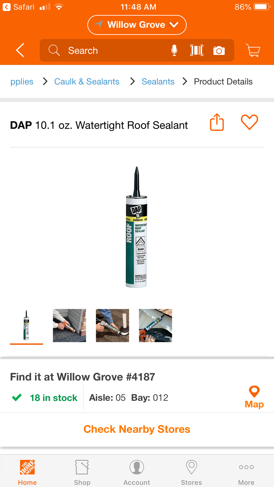

Krylon 5 ball 1613 semi flat black is a perfect match to original. You must use a sealer that is flexible for the hood braces are you sure the brown isn’t from age all the ones I have taken apart were black.
I use dap roofing shingle sealant. I clean up where it goes put A small amount at each location then close the hood and leave it closed for at least 48 hours.

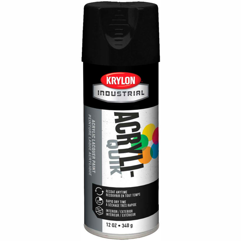

go to globalindustrial.com. Their part number K01613A07. They sell it minimum quantity of 6. It is acrylic lacquer and sprays really well. I believe Krylon sells 1613 at a lot of retail shops but isn't the same paint.
Its not the same you want it labeled INDUSTRIAL as I noted, and the stuff touches up invisibly too,,

From: Reading Pa
This is the industrial stuff

KRYLON INDUSTRIAL! Best match in an aerosol. begee22

The industrial krylon (five *****) is available from FilmTools.com.
