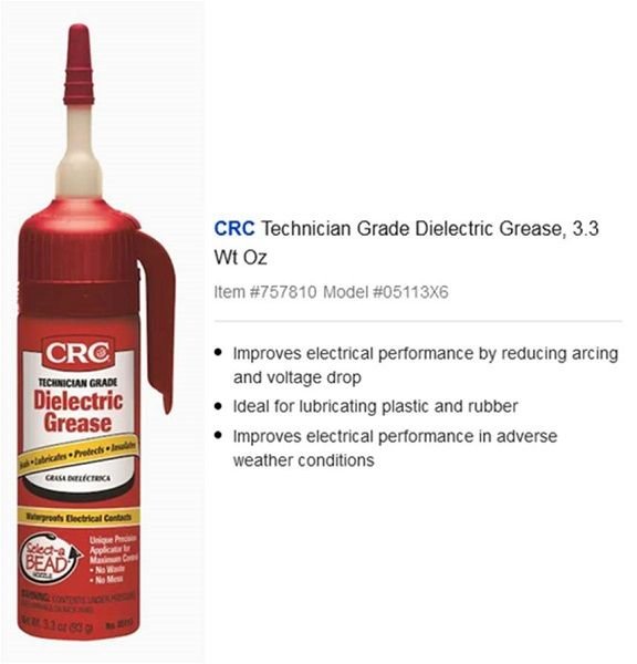

Peter, a couple of handy things to have around the shop for situations like this are some contact cleaner and some Dielectric Grease. Both products (in various brands - these just happen to be my favorites) should be available in any good auto parts store or online.
Contact cleaner is useful for dealing with lite corrosion in electrical contracts and bulb sockets, while the Dielectric grease is useful for insulating electrical connections from the corrosive effects of humidity and moisture. It can also make removing old burned out bulbs and separating electrical connectors a lot easier down the road.
Good luck... GUSTO
