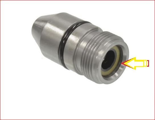

Lip seal inside the cable end.

Replace the "bullet" they're cheap and easy to install...

That’s exactly what I intend to do, ordered the bullet last night. Didn’t realize there was a seal inside it, learn something new every day. As also mentioned, I intend to drain some fluid out of the tranny which should also help.

Replace the driven plastic gear as well. It can get a slight groove worn into it. Also if you do buy a new bullet (still available at your chevy dealer) the do not come with the o-ring on the outside, but do have a new inner lip seal. Parts to rebuild the original bullet are available on the web.

I ordered the bullet from Paragon, which includes the inner seal and the outside O ring. Don’t know yet which plastic gear I need, but it will be new.
