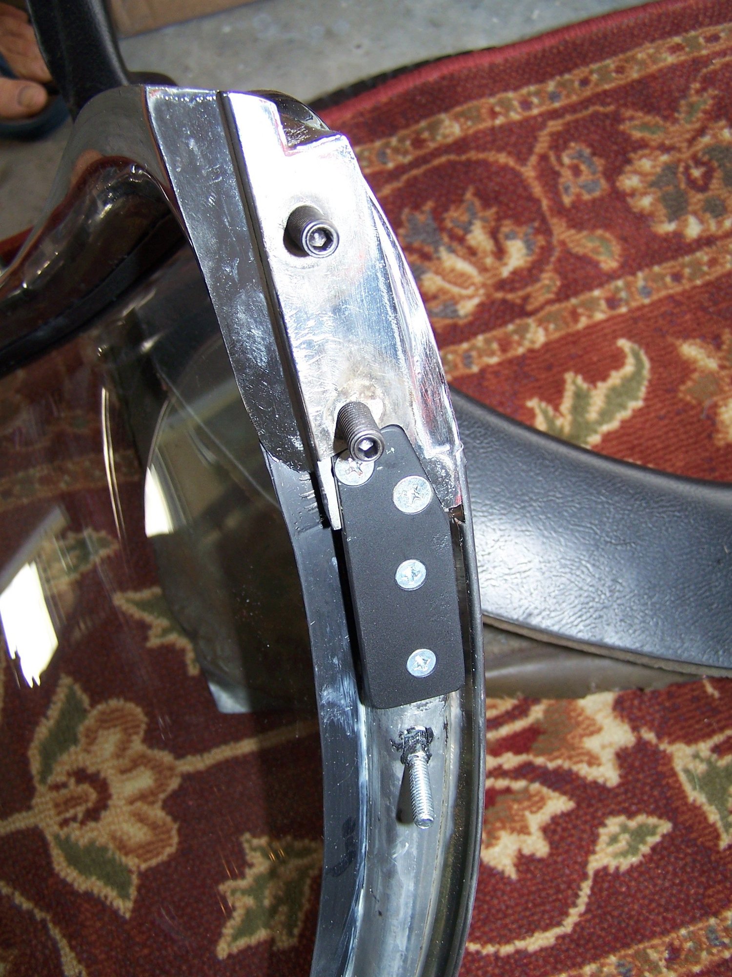

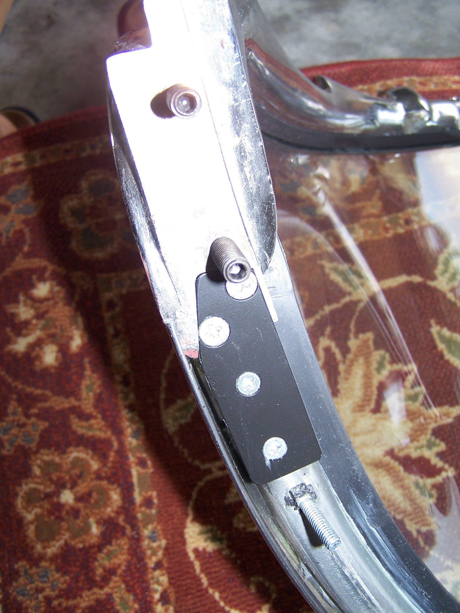

The C1 windshield side pillars were a poor design...they stand upright on a pot metal tab that extends forward and easily breaks in two. I've heard about them being broken as a short cut to windshield replacement but not sure I buy that...nobody has told me how you would deal with the other fitment challenges even after the pillars were snapped loose.
More likely they were just weak and fractured over time, or, somebody's convertible top was too tight and they latched things down on the front anyway and broke the pillar tabs, or, some people used to grab the windshield header to pull themselves up when getting out of the car.
At any rate Paul Mazut does the repairs for many of the vendors or you can go to him directly, when he's done, short of rolling the car over, they'll never break again.
Here are my Paul Mazut repaired tabs:
