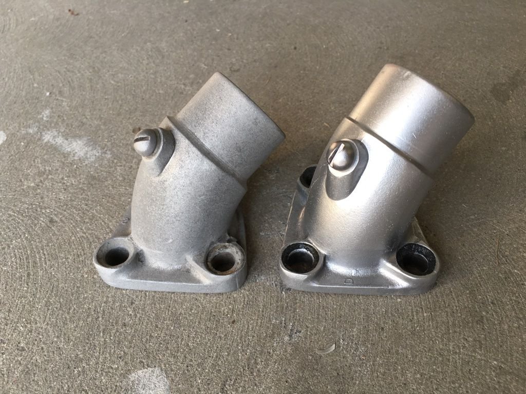

Not a dumb question if you are not familiar with it. With vapor blasting / honing, you can use almost anything you would use for dry blasting but high water is used with the media. It is a game changer for anyone restoring just about anything. The difference between dry and wet blasting is that the surface is cleaned and honed without destroying the surface. You can even use it on plastic and rubber.
For the OP, I have tried several grades of glass bead and ended up using the finest I could find (I think its 320-400) at 70-75 psi. Excellent results with a bit of trial and error. I found that the distance from the gun to the piece you are blasting can change the shine in aluminum pieces. What I really like is that the surface once blasted is very easy to clean. Here a pieces I did.

How does this surface respond to the elements over time? I had considered just painting aluminum engine drivetrain parts. Now you got me thinking differently.
Originally Posted by Harry66
......I have tried several grades of glass bead and ended up using the finest I could find (I think its 320-400) at 70-75 psi. Excellent results with a bit of trial and error. I found that the distance from the gun to the piece you are blasting can change the shine in aluminum pieces. What I really like is that the surface once blasted is very easy to clean. Here a pieces I did.
In the photo are manifolds off of a 70"s motorcycle. After 8-9 months of use, no change at all. I would suspect the aluminum will oxidize in time but so far it has not changed.
