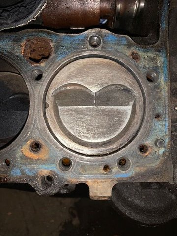

Can anyone identify the type of piston this is? Compression ratio, 10.5-1?
When I bought the 60, it came with this "spare" engine. It has been decked but not rebored. I am not sure of the cam. I will spin it over later this week.

327/350 hp stock piston or speed pro L2166F

Is that normal to see in a 283 block?

I looked at your ideas and I see some differences. The picture is hard to see, but there is a concave indent where as the 327/350 stock piston or speed pro L2166F has a higher spot.

If its a 283 then I'm sure speed pro made a similar piston for the 283, closest today for off the shelf is a KB166.

Part number should b on underside of piston.

In your picture I can’t see if that is a dome or a dished piston? Is the piston head raised or recessed?
The piston is domed. I don't know who made it but I don't believe that's a GM ;iston.

Is the piston head recessed.

It's a domed piston. Can't tell you who made it. It's a 283 not a 327 but the pistons look just like 327 factory pistons except they were forged. I believe yours are cast. I can't think of any reason in the world why someone would put dished pistons in a 283.

I need to apologize to all those that stepped up to help me out. I am VERY new at this and truly did not understand what I was looking at in the piston. It is domed, as you all knew. The newbie goofed up. I appreciate the help and will try to get a better understanding before I post for help. Thank you.

I believe the first use of a domed piston was the '57 283 HP FI engine, and this piston continued with the 290 HP FI engine through 1960. These engines had a advertised CR of 10.5:1. For '61 I believe a slightly different design with a larger dome was used on both the 275 and 315 HP FI engines with the new 461X heads that have slightly larger chamber volume than previous heads, and the advertised CR was increased to 11:1
My understanding is that these pistons were cast and being as how they were for the 283 the nominal skirt diameter would be 3 7/8" versus 4" for the 327. I recall a repro outfit, Danchuck, that specializes in full size Chevrolet repro parts offers at least one of these pistons, but I don't know who manufactures them.
The first use by Chevrolet of forged pistons was the '62 340/360 HP 327s.
