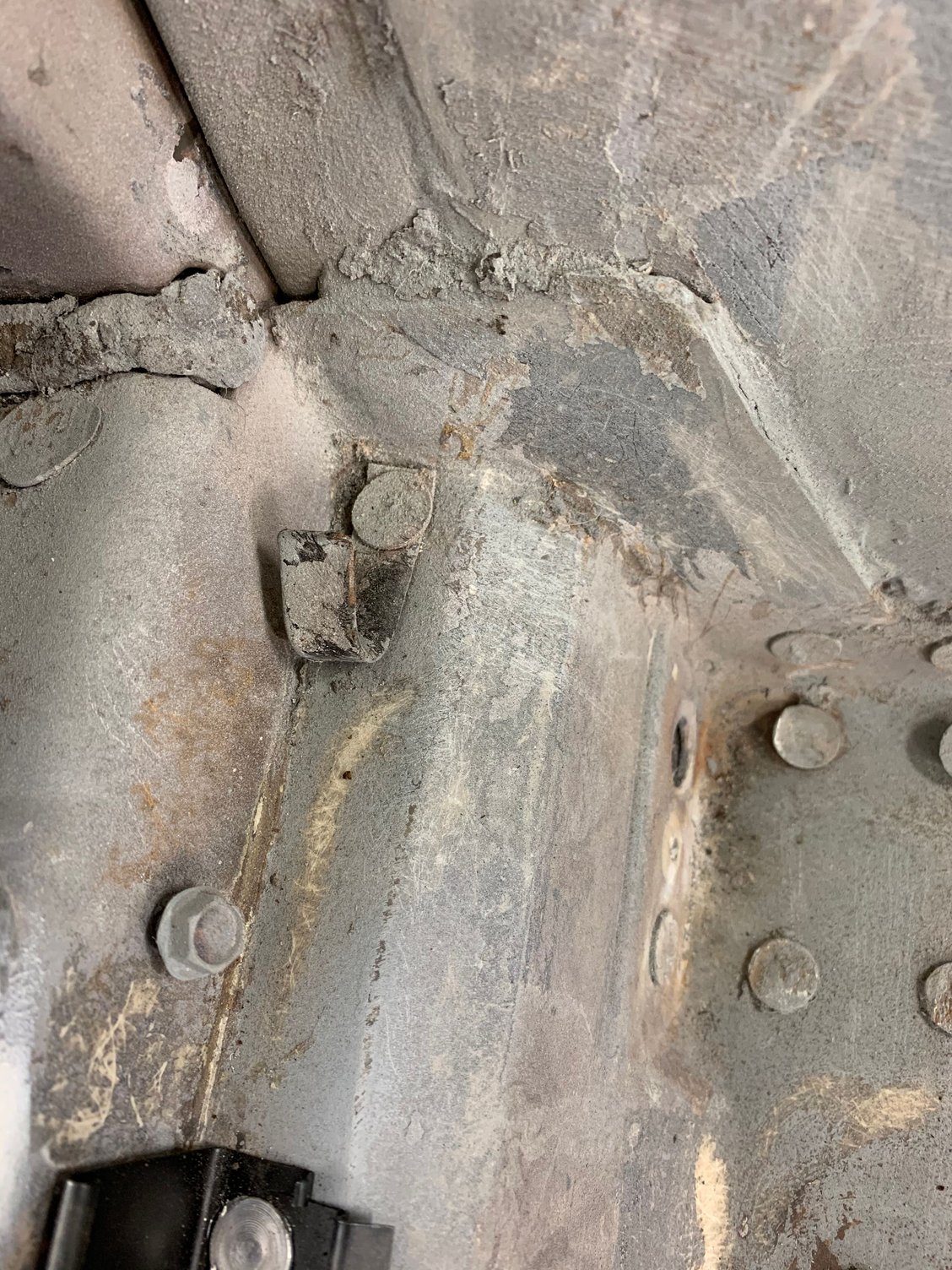

Several of my retainers are missing. In the back corner floor board just behind the seat Can anyone help with a proper picture of restoration or tell me what goes there? Thanks

Old Feb 18, 2021 | 01:59 PM
Dclayton's Avatar
Dclayton
8th Gear
Joined: Jan 2019
Posts: 8

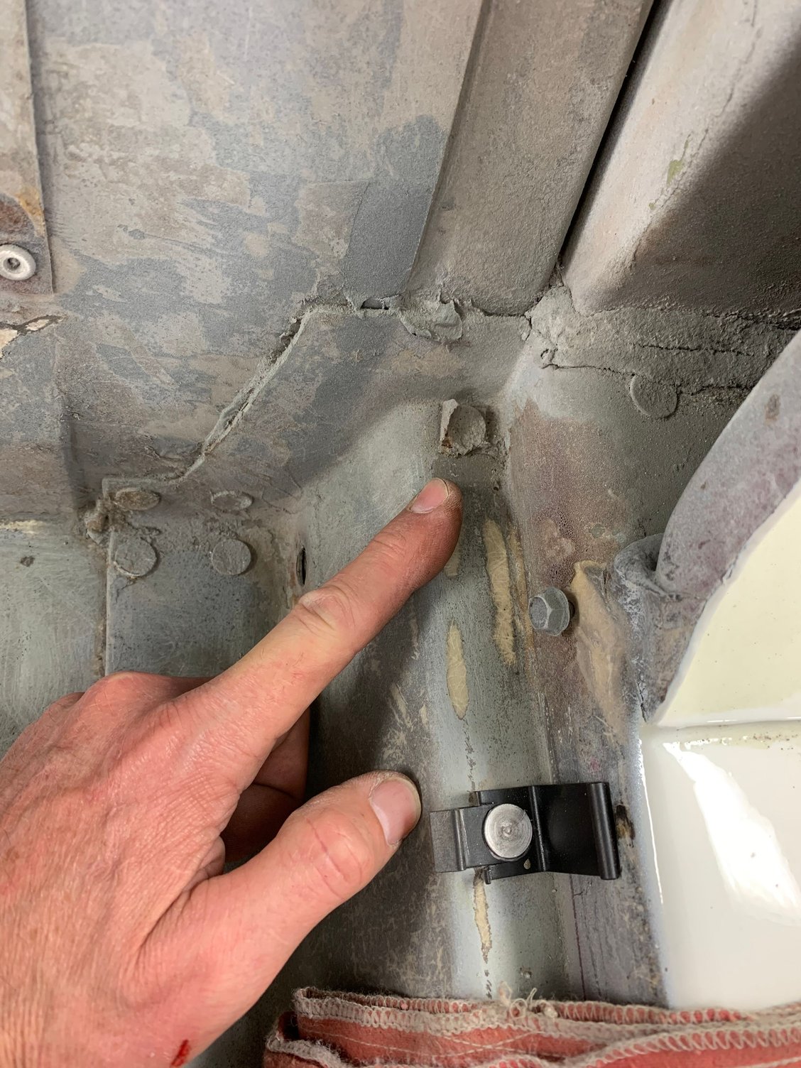

Pics of what I’m referring to
Old Feb 18, 2021 | 02:07 PM
silver837's Avatar
silver837
Joined: Mar 2017
Posts: 5,120
Likes: 1,612
From: Nor- Cal
Look in your AIM. I believe those are aluminum rivets.
Old Feb 18, 2021 | 06:25 PM
DansYellow66's Avatar
DansYellow66
Joined: Jan 2003
Posts: 17,682
Likes: 3,678
From: Central Arkansas
Yeah - I think you are pointing to large head aluminum assembly rivets. They are available from most of the Corvette parts houses. I’m not sure who has the best ones anymore. Years ago some were being sold that were too hard a grade of aluminum and were hard to set right. You might want to ask for a current recommendation. They have to be bucked up and set by hand although some have used a pneumatic hammer for the job.
Old Feb 18, 2021 | 06:32 PM
Dclayton's Avatar
Dclayton
8th Gear
Joined: Jan 2019
Posts: 8
yes it is a rivet. I have that but something was there snd broken off
Old Feb 18, 2021 | 06:54 PM
silver837's Avatar
silver837
Joined: Mar 2017
Posts: 5,120
Likes: 1,612
From: Nor- Cal
I think if you look in the Assembly Instruction manual it will show you the configuration, with part numbers for the rivet and what component it holds. It also may be just sloppy work by the line workers.
Old Feb 18, 2021 | 08:30 PM
TC233's Avatar
TC233
CF Senior Fox Bat
Joined: Aug 2011
Posts: 3,818
Likes: 619
Don't think you are missing several, there is one where you have one, and another where you are missing one, other than that, thats all that is back there. The one on the drivers side is the one that tends to disappear because it holds the rear harness and the radio antennae lead so must be bent tightly to keep the leads from bulging.
The one on the passenger side has nothing in it, its why its still there.
