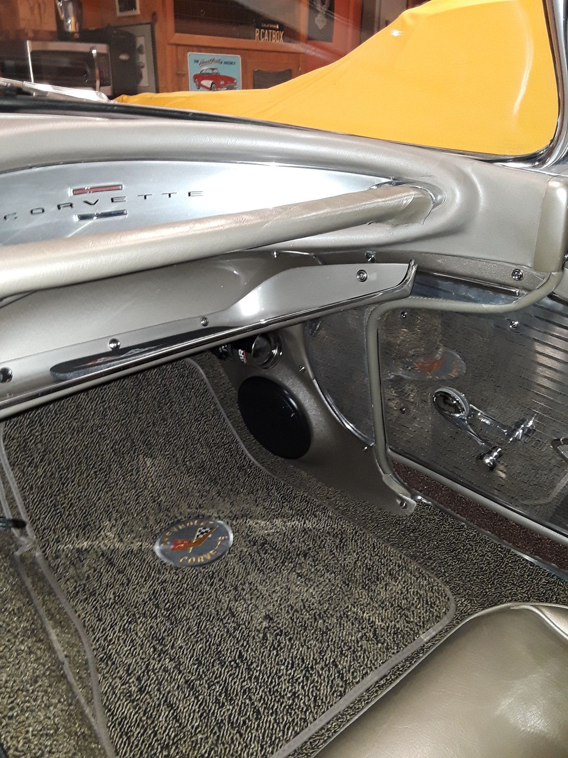

Abs panel and speakers from Ecklers. Painted to match, strong enough to support a small fire extinguisher and no damage to original panels if future owners want to go back to original.

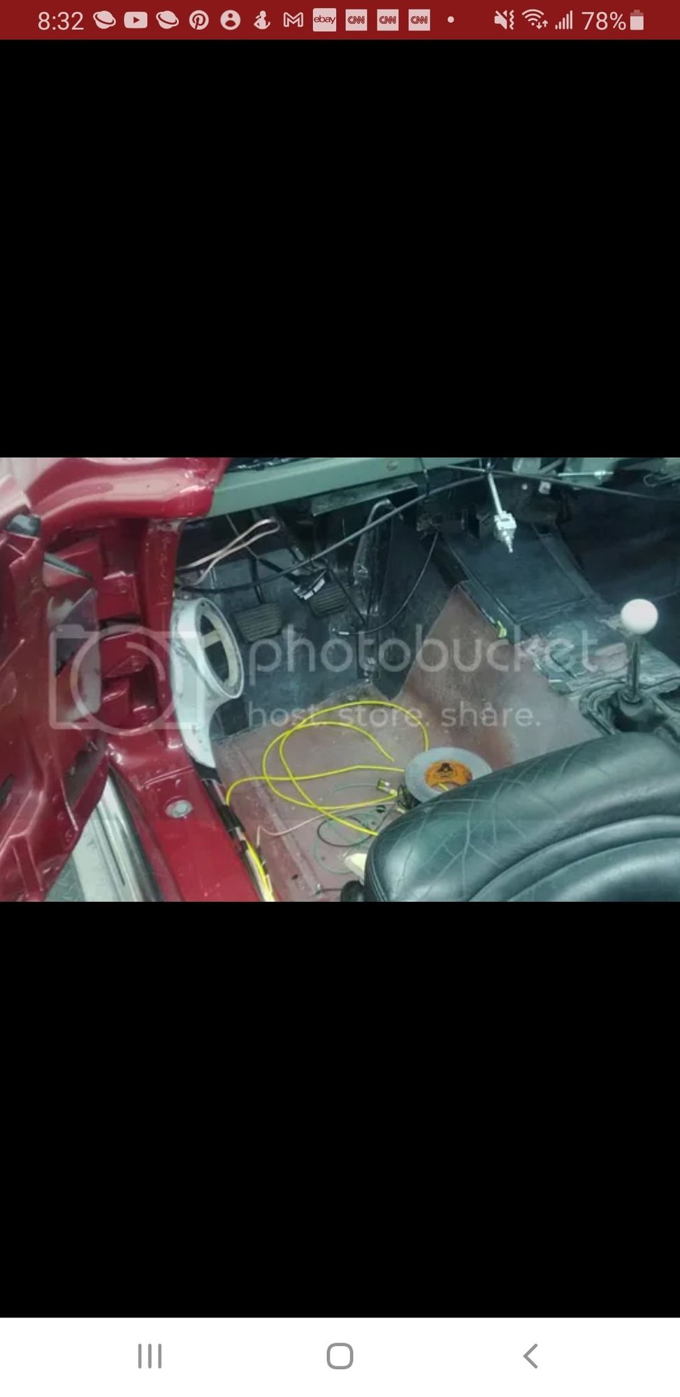

On my 67 I built custom kick panel housings to hold 6.25" speakers. I angled them in a criss cross fashion the best I could and still allowing easy in and out access. It took several iterations on depth and angle when building the stick framework. They are powered by an external 400 watt amp and being a C2 I made a sub box for a compartment behind the seats. With top down, sidepipes i have no problem listening to anything on the freeway.
