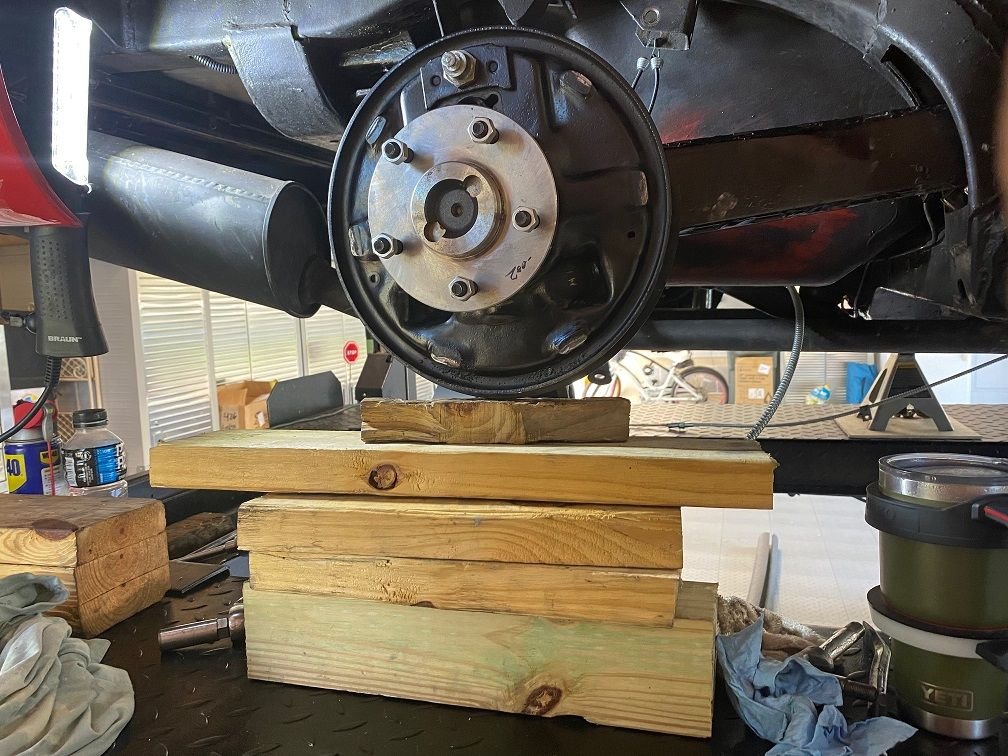

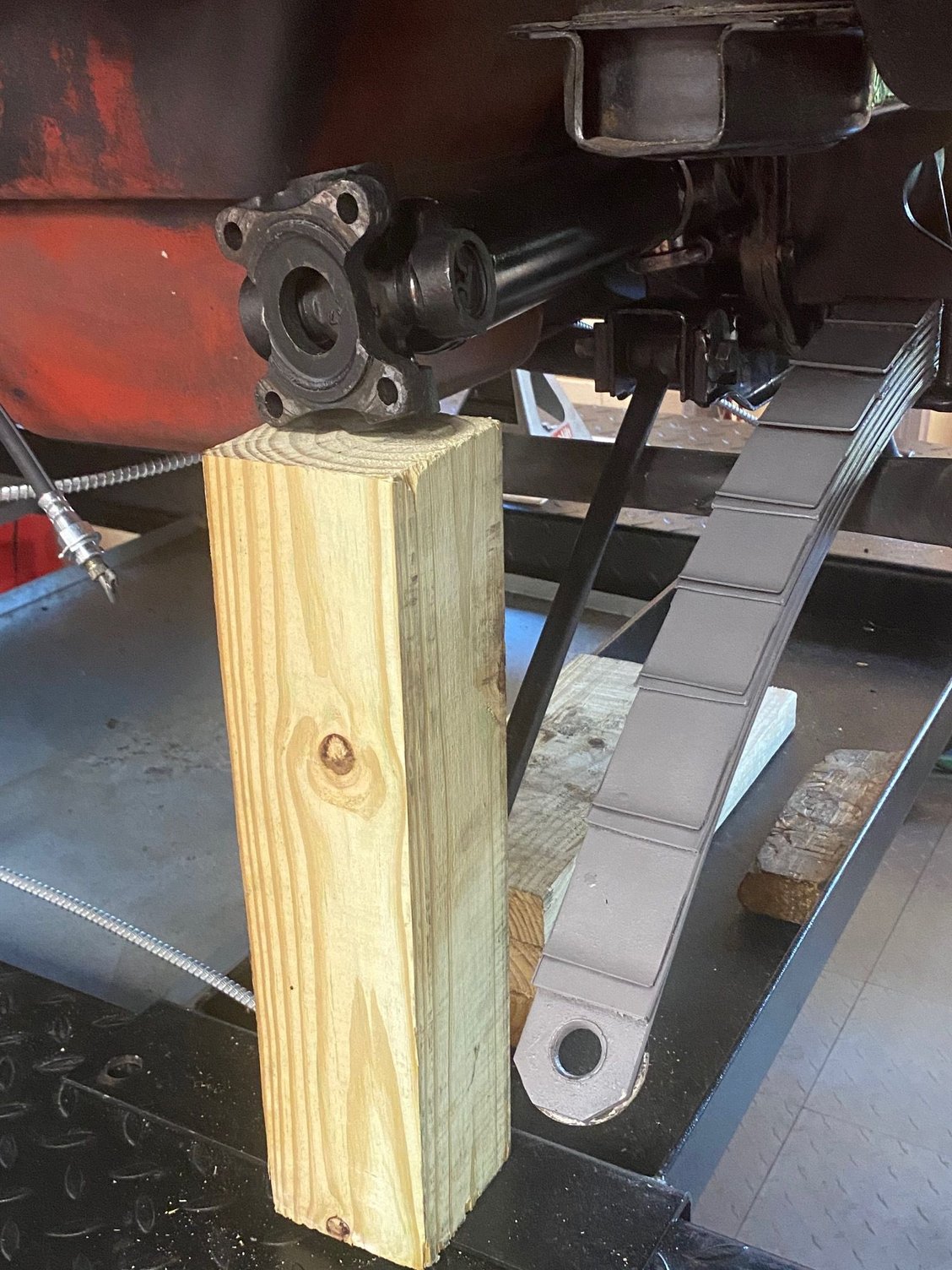

You can do a suspended test but the trailing arms have to be supported to reduce the angle at which the half shafts operate and safety is a concern - you have to be VERY careful. Its a bit easier with drum brakes.
The C2 "three link" rear suspension is a bit delicate in some regards.
Even without running the car, with the half shafts extended completely you can turn them by hand and feel and hear the "clunking" of the U-joints as they transition through their rotation. Then you'll see how damage running the car like this can happen.

You can also put a steel shim of some sort between the lower side of the trailing arm and the frame pocket before raising the car up to keep the suspension from dropping (or at least reduce the drop) when the rear of the car is raised if you must rotate the drive train for a test.
