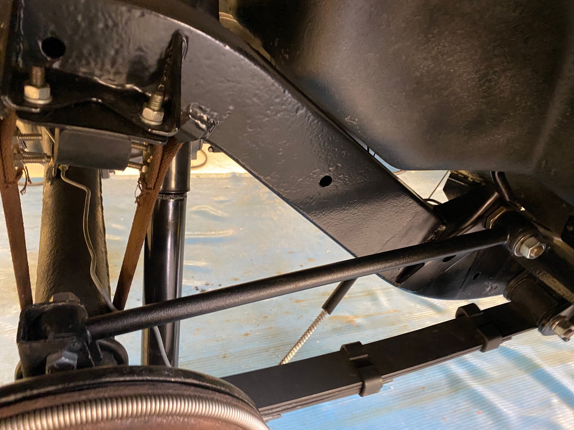

Anyone installed a composite monoleaf on a c1 vette, I'm thinking of trying to make car handle better any real world perspectives.thank you.

A friend put those on a 62 to lower the rear end, didn't notice any difference in ride or handling. What are you trying to achive?

Go with radial tires and the best shocks for your purpose...
Changing just a rear spring may affect the ride but prob won't do much for handling...

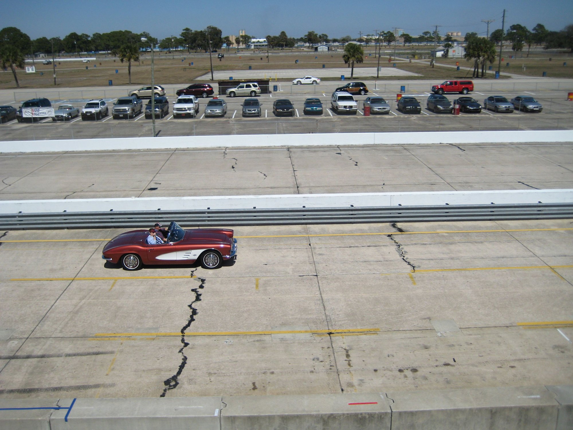

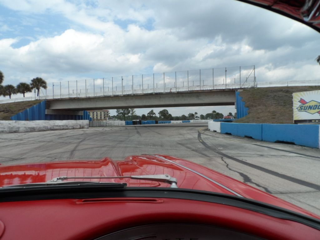

I've taken my stock-suspension 61 around Sebring, hitting triple digit speeds a few times in 2010 and again in 2013. The car was a handful but it is what it is. They aren't the equivalent of modern day track cars and you can't make them so without major changes.
My guess is that is the sound of an inexperienced non professional driver. You need to take a look at some of the times and speeds the pros were doing at that track back when these cars were new, it will astound you.
Old Mar 10, 2021 | 02:55 PM
Frankie the Fink's Avatar
Frankie the Fink
Joined: Aug 2007
Posts: 58,061
Likes: 7,146
Army
if you mean me I used to autocross my Shelby-ized 66 Mustang regularly. I was no slouch and quite used to “pushing” vintage cars.
Old Mar 10, 2021 | 03:01 PM
68hemi's Avatar
68hemi
Joined: Nov 2003
Posts: 10,696
Likes: 3,090
From: Cottonwood AZ
C1 of Year Finalist (performance mods) 2019
Yes, I was. A weekend warrior novice is quite different than a pro driver that does it for a living and has little to no fear. Do you really believe you could have competed with the the drivers that were setting records back in 1957 at Sebring?

Better ride can come with a bit of effort. Take the rear spring packs apart and put Teflon spring liners between the leafs. You may have to sand and clean surfaces for good sliding action. This is an old street rodder trick for early Ford front spring. The binding that occurs from the spring leafs trying to slide causes a poor ride from no spring action. Really old old GM cars used to wrap the rear leaf springs with tin and put a grease zerk on them to keep them sliding freely. Try it, you will be surprised how good a leaf spring can ride.
