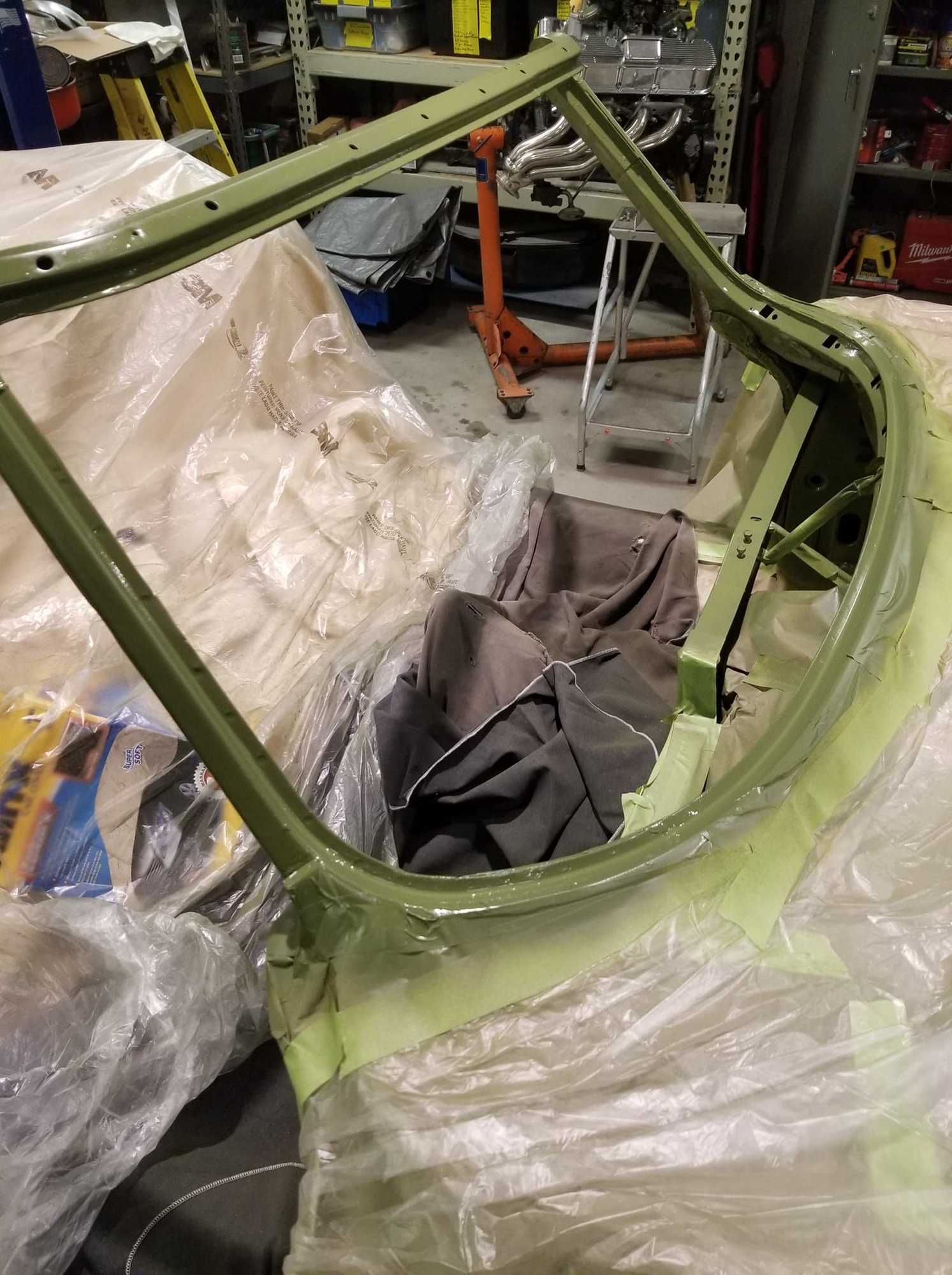

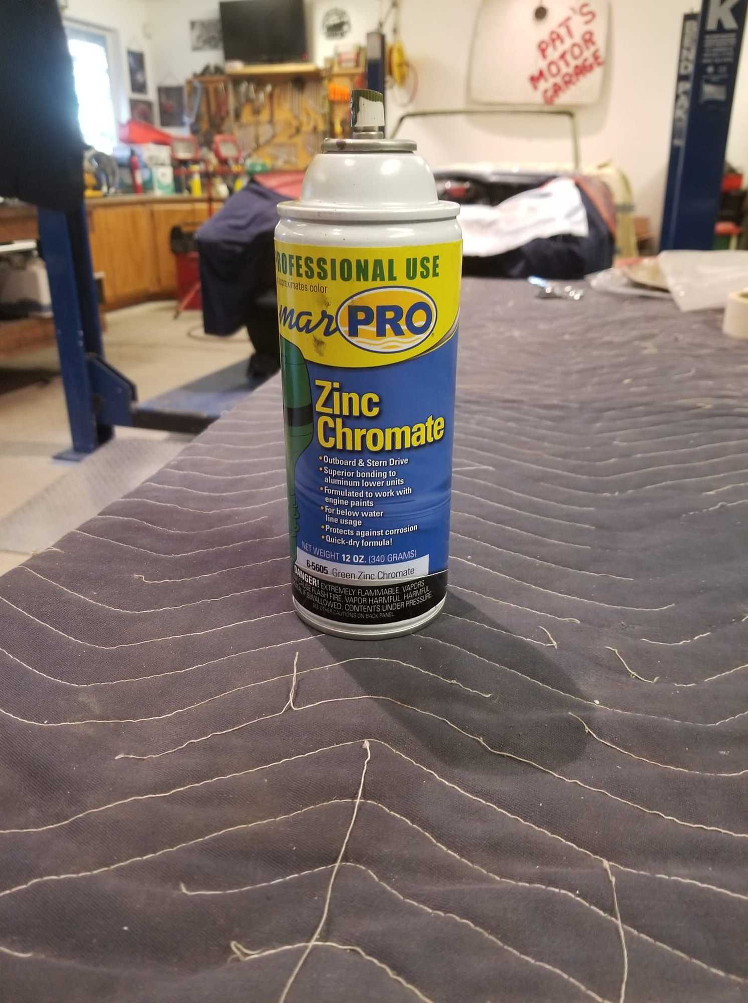

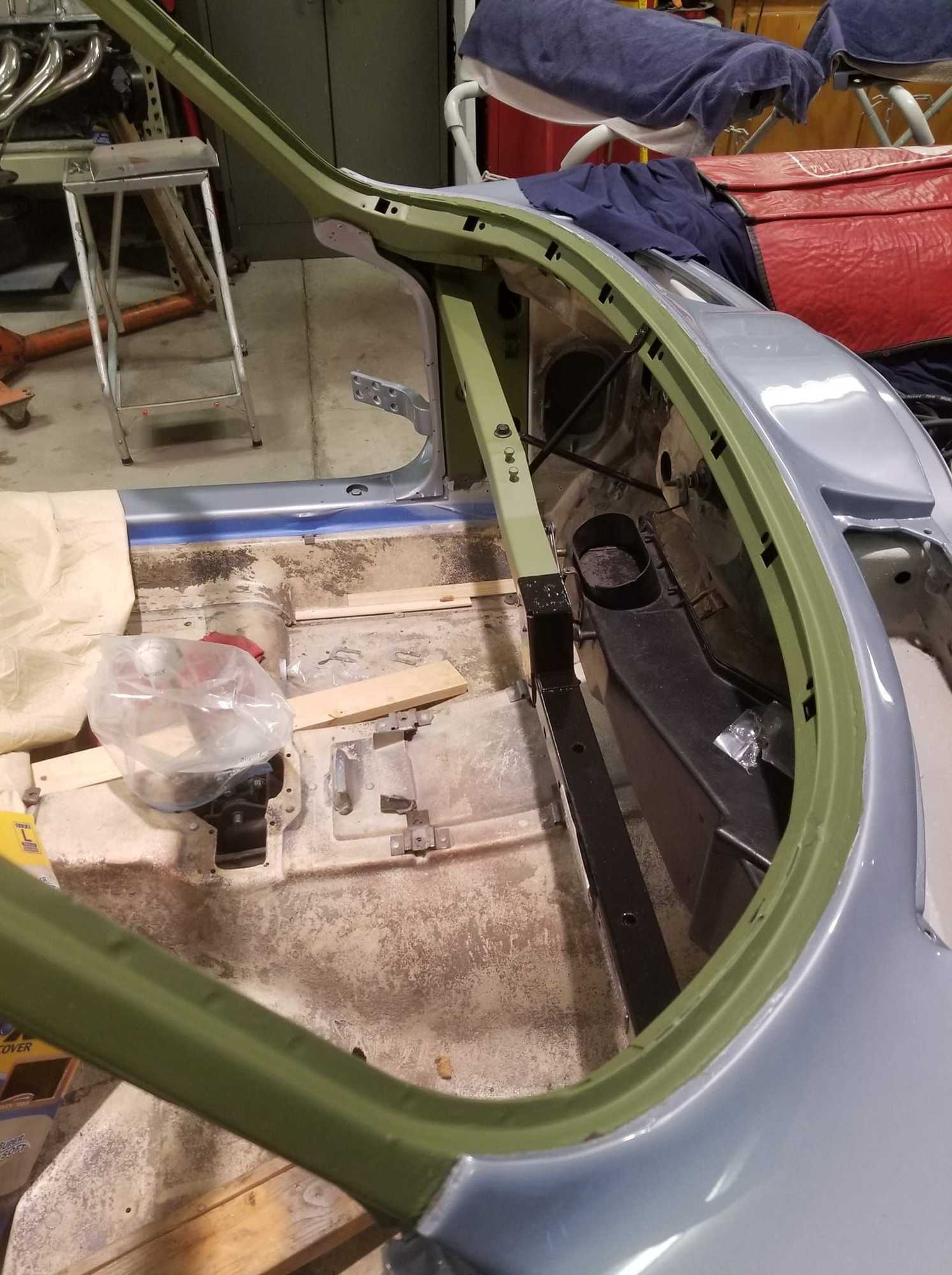

Old Mar 21, 2021 | 12:57 AM
ptjsk's Avatar
ptjsk
Joined: Feb 2007
Posts: 4,778
Likes: 2,445
From: Northern California CA
Originally Posted by bauto
Hi, has anyone found a close match to the zinc chromate paint used on the dash and windshield frame . I have purchased some of the quanta paint and it is more olive green than the original that has more of a yellowish green
I just repainted my windshield frame with Mar Pro Zinc Chromate #6-5605 Green Zinc Chromate.
Cover anything and everything you don't want it to stick on. This stuff "clings" to everything!
Also, be sure to wear a respirator, long sleeve shirt and gloves.
Pat
