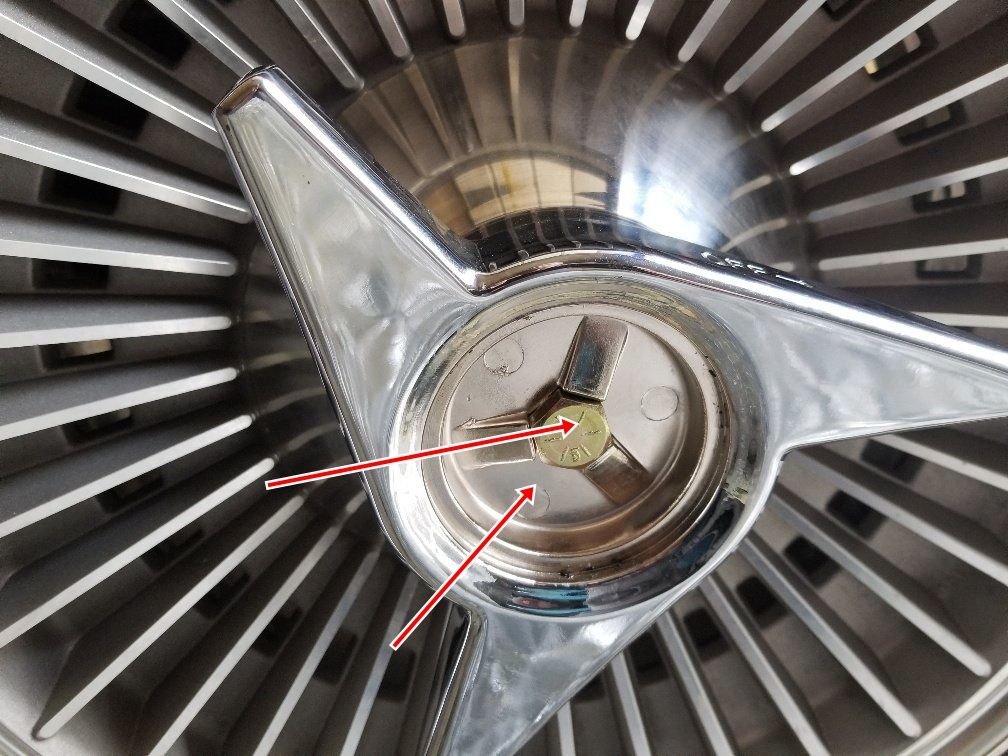

My saga with the knockoffs on my 64 roadster continues. I tried removing the knockoffs today so I could get the spinners pointing in the right direction. Banging on the spinner doesn't seem to loosen it. I pulled the cap off the spinner and didn't recognize the type of knockoff. I'm assuming it's a bolt on. I don't see any clips or anything holding it in place. I don't see anyway to remove the spinner or knockoff. Does anybody recognize this? If so, any advice on how to remove the spinner and knockoff? Thx.

Yes they are bolt on. There is probably an anti-theft pin installed. You need to remove the parts in the center (see arrows) for removal of the pin before you can hit the spinner off.

This is not a Corvette America Direct Bolt On Wheel and I see no pins. It must be America Finest.

Although I'm not familiar with the bolt-on "knockoffs" (I have real aftermarket KOs), the center bolt appears to be a normal grade 8 bolt in the spinner; if so, it would unscrew counter-clockwise. Looking carefully at the 3 ramps aligning it with the spinner, it appears that the clearance between the ramps and the bolt shows that clockwise torque has been applied. Have you tried to turn the spinner counter-clockwise?

BlueRidge67 Thx for the reply I have emailed America Finest to see if they are the manufacturer.

larry, I've tried both directions but perhaps not hard enough. I emailed America First to see if they are the manufacturer and to see if they have instructions. Thanks for the reply

Blue Ridge 67 turned out to be correct. They are America's Finest wheels. Mike from AF helped with some instructions. Very easy to take off. That nut in the middle is nyloc. As you turn the spinner counter-clockwise (fairly hard) at some point you get past the nylon part and then the spinner spins easily and eventually comes off. There are no pins. You just turn counter clockwise to remove and clockwise to tighten. That's true on all four wheels so you ignore the OFF arrow and turn like you would with the "righty tighty" rule.

Big-K, that sounds like the America's Finest bolt-ons that I started this thread with. My reply is below. If so, all of the wheels loosen turning counter-clockwise regardless of which side of the car they are on and regardless of which way the arrow points. That center nut is nylock so you need to turn it hard a couple of times counter clockwise to get past the nylon after that the spinner turn easily. I used my lead hammer for a few blows to get it started. You don't need to take off the center cap. It is purely for show. I arranged my spinners so they all point towards the front of the car, but the arrow is just for show it has nothing to do with the direction you need to turn the spinner to remove. It's always the "lefty loosy", "righty tighty" rule. I'm only referring to America's Finest bolt-ons with that comment.
