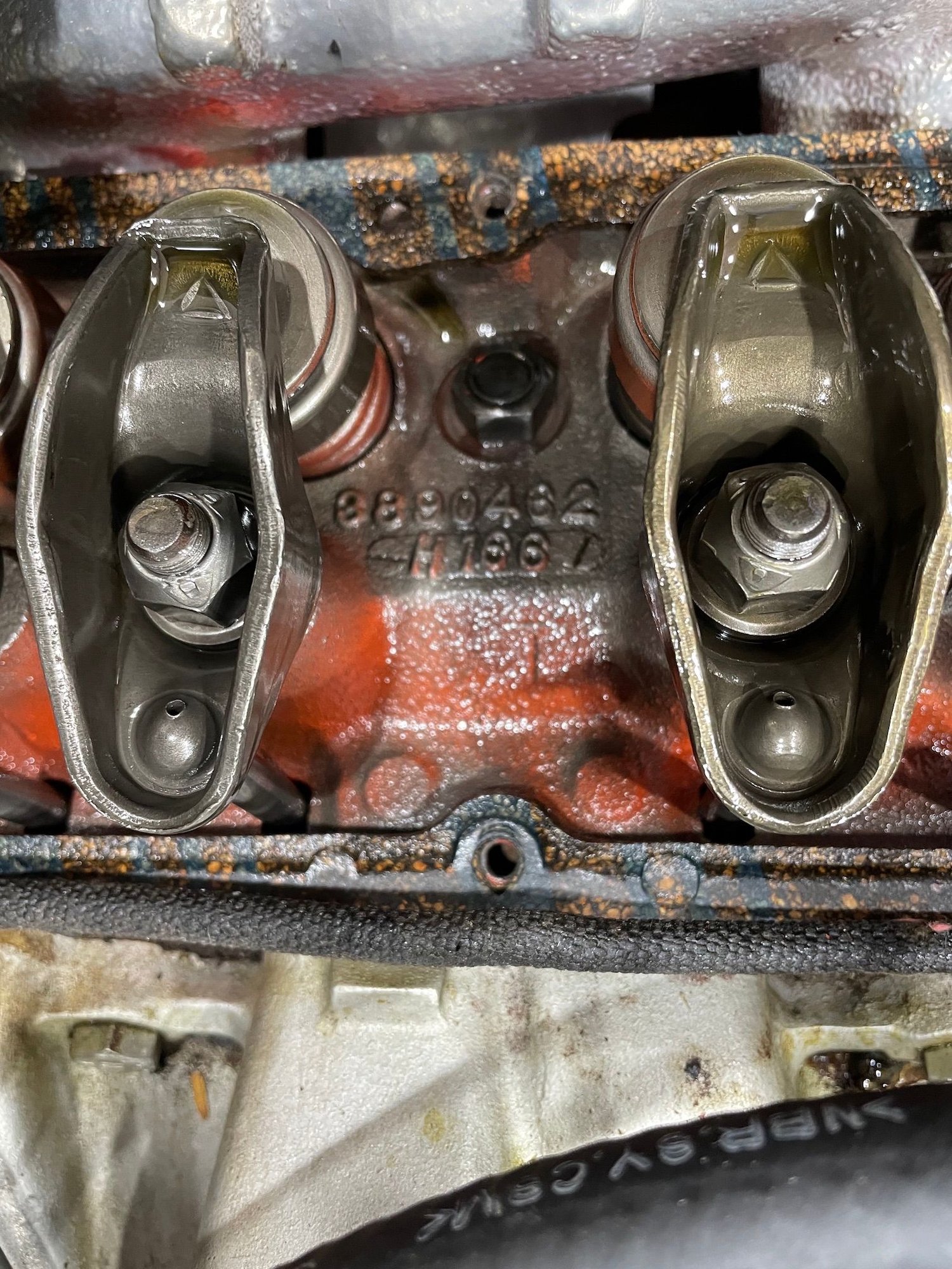

Long story but my rebuilt “Original” L79 67 coupe engine froze an intake valve. It is at the shop (A new shop) and I stopped by and was shown the stuck #3 intake. I got to looking at the heads and casting numbers and was wondering where these were when they left GM
Right casting looks like 8890462 over H 166. GM 3
.Left casting looks like 8890462. K 166. GM 12

RH
3890462, H is August month, 16th day, 1966, GM3 is the pattern number for mold used when head was poured at Saginaw Grey Iron
LH
3890462, K is November, 16th day, 1966, GM12 pattern number

My car was born on Oct 6, 1966. The right head could be original but the left one, nope.
thanks for answering my question.

Make sure that "K" is not another "H" before doing anything drastic.

Here are photos of the heads.

I have no plan to change it. I just wanted to know exactly what I have. This is indication the motor has had some serious fault that was fixed by replacing one head.
