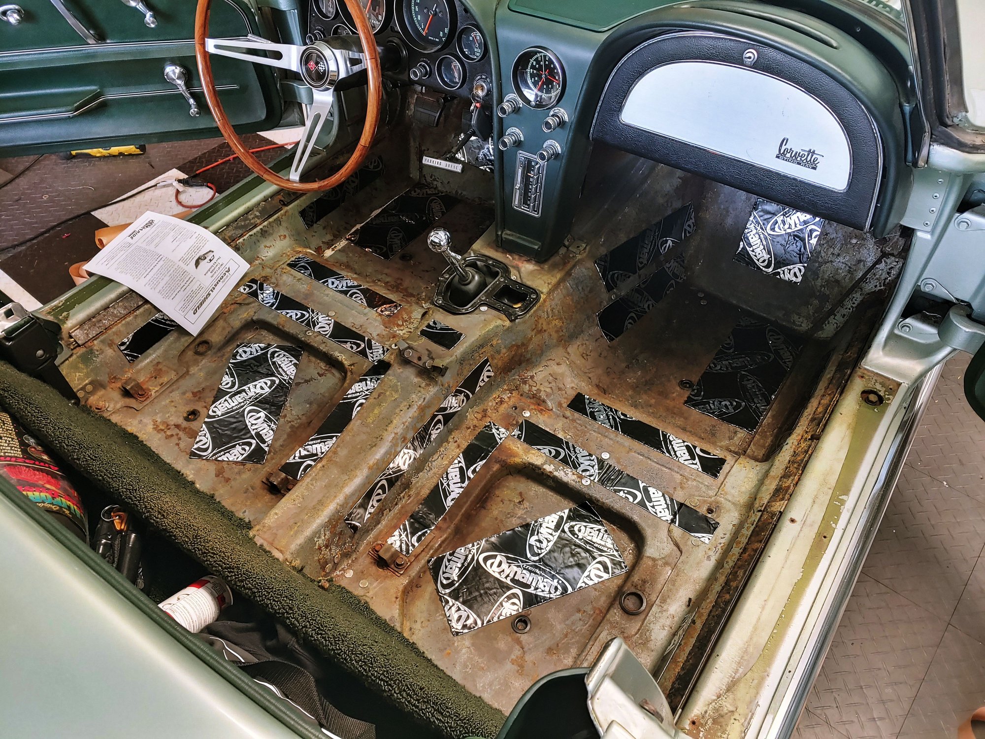

I had a heater core leak a few weeks back which soaked my passenger well carpet and the pad. After pulling the carpet back it I found some terrible foam padding which looked like it belonged under some 1970 **** carpet.
No sense in trying to dry that junk out. I ordered a deluxe AcoustiShield / Quiet Ride floor pan kit and started the install today.
First step was to remove the seats, seat belts, and carpet.
Mmm foam. Yuk.
With all of the foam removed I cleaned up all of the old foam and dry adhesive.
Once dry and clean I followed the instructions to apply the pre-cut dynamat pieces. Dynamat doesn't need to fully cover the entire panel. I've used this material on over 10 cars/trucks and half as many boats. The kit comes with everything you need.
Once the Dynamat was laid down I test fit the heat shield pieces. Tomorrow I will start to glue them down and seal the edges with the foil tape
