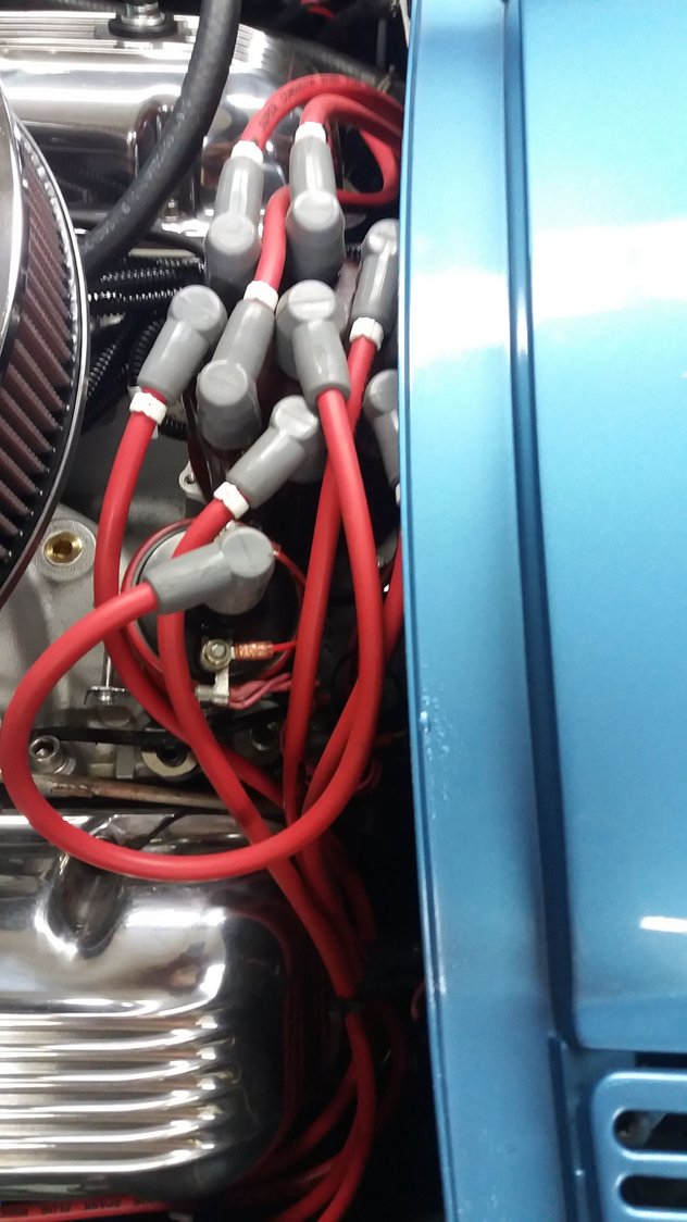

I can't remove my distributor without moving the engine forward first. The distributor is tucked under the "rain gutter" at the back of the engine bay opening in the body. In the side shot picture you can't even see the rear most (in this case #6) plug wire. The angled picture shows it hiding underneath.
What would be causing this? Could the body be mounted this far forward on the frame? Is there that much play in the mounting points that this could happen?

If I take the rear wires off first I can get the cap off. However, the distributor still needs to be taken out straight up several inches before it clears the intake and by then the body of the distributor kits the fiberglass and cannot be removed. I literally need to disconnect the motor mounts at the engine block, the transmission from the cross member, the exhaust pipes from the manifolds, the clutch and throttle linkage and move the engine forward an inch or so to be able to remove the distributor.
I have not seen any other cars at shows that are in this situation, which is why I was wondering if the body might be mounted too far forward on the frame but I don't know how much play there is in the body mounting points. Obviously the engine cannot be mounted with any adjustment since the frame mounts are welded on.

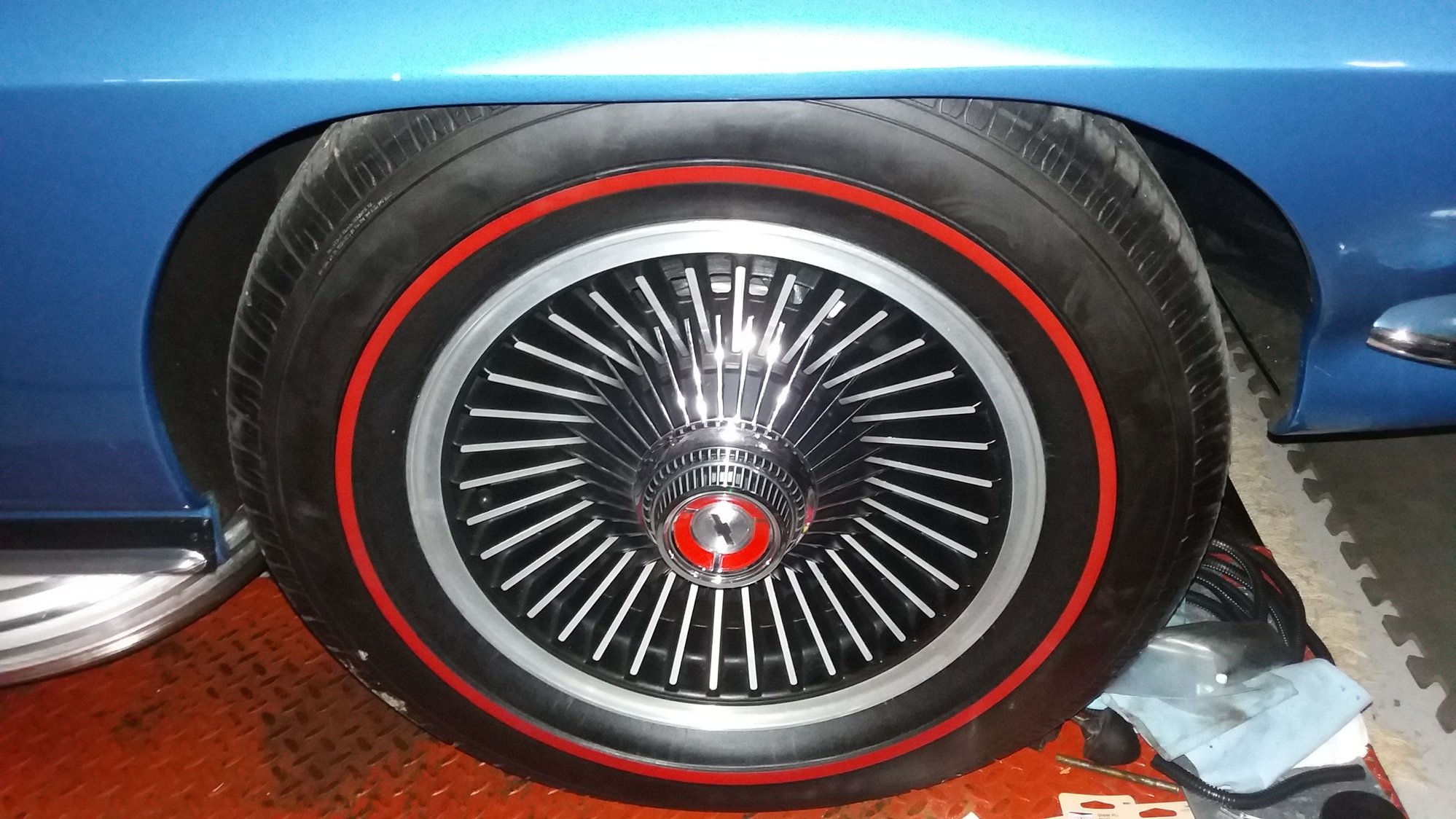

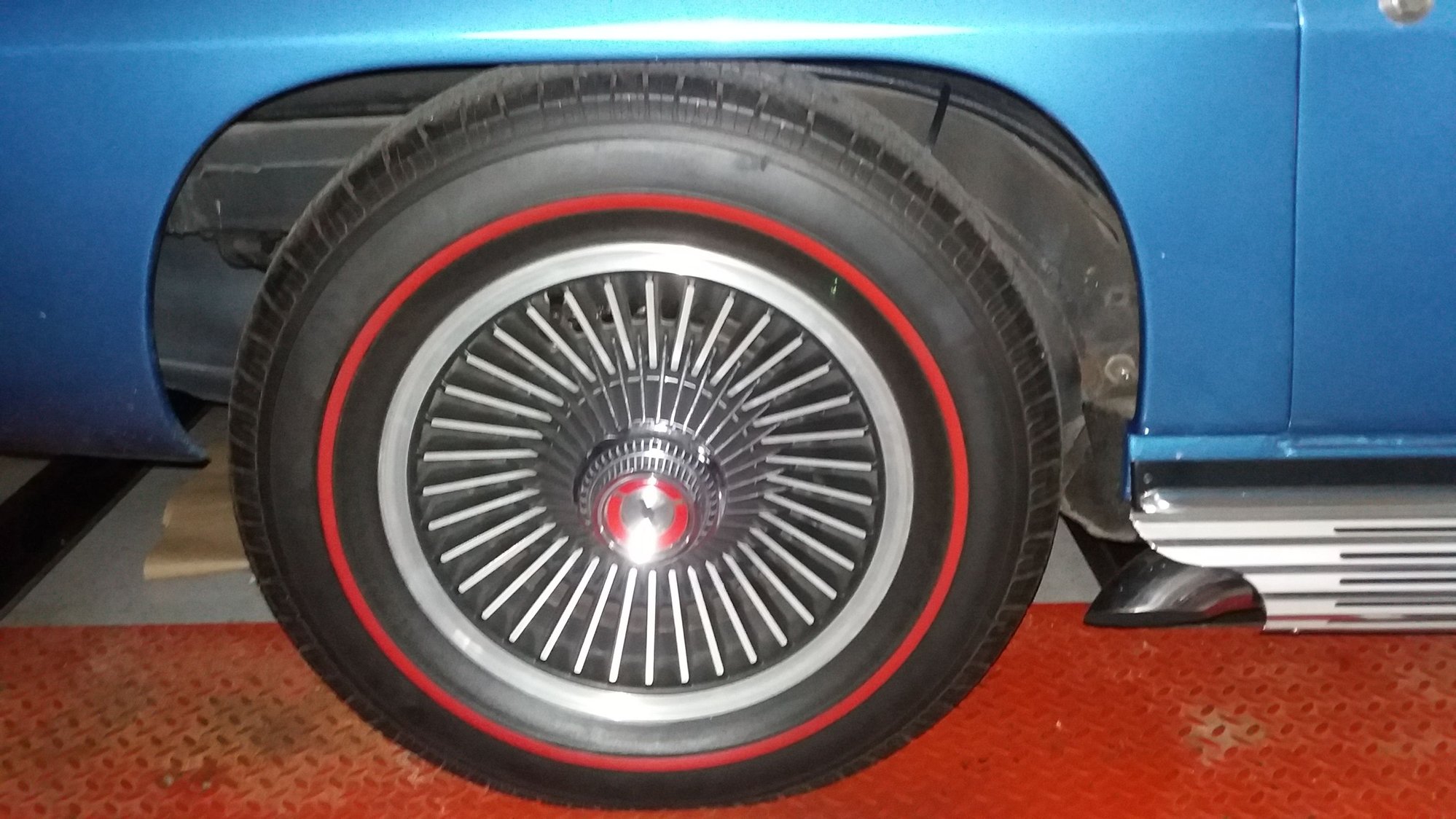

If you remove the console and boot, how is the shifter centered in the hole in the tunnel? On side view, how are the wheels/tires centered in the wheel wells?
Do they seem to be offset to the back of the wheel wells? It would be subtle but should be noticeable if you focus on it.

Good points. It appears that the body is pretty well centered on the wheels and the fan is mostly inside of the shroud, with nearly an inch of clearance from the front of the blades to the radiator side of the shroud. So if the body were to be moved back 3/4" there would be a slight clearance for the fan blades to the front of the shroud.

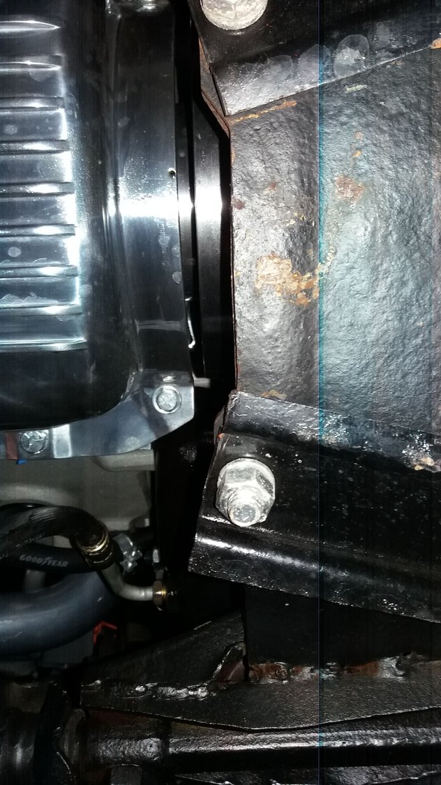

It would also be interesting to see where the harmonic balancer is in relation to the front crossmember. I wish I could look at the car/engine placement in person

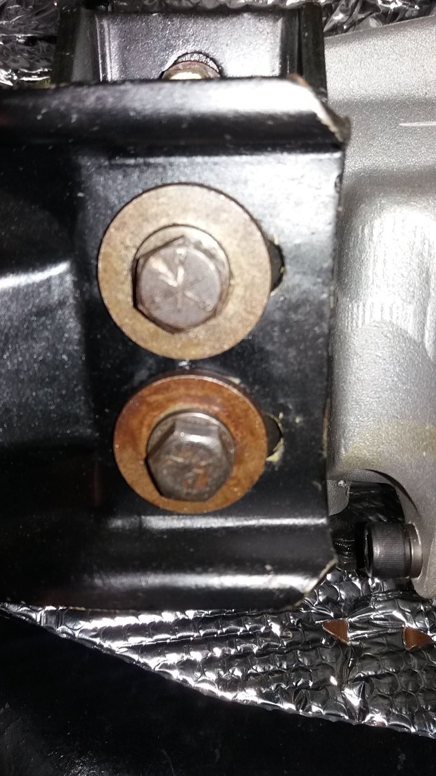

I searched for the thread above but could not find it. Here is a picture of my rear transmission support for reference. I also included a picture of the bolt heads with reference to the slots in the crossmember. The bolts are offset to the rear of the slots.
Old Jun 4, 2021 | 08:32 PM
Brads67's Avatar
Brads67
Joined: Jan 2012
Posts: 98
Likes: 11
From: Greenfield, WI
Here is a picture of the balancer from below. The rear face of the balancer is approximately 3/4" to the rear of the front crossmember.

If you have a copy of the AIM , check to see if your transmission is installed correctly.
Obviously something is not right. It is going to take some time and detective work to figure it out.
