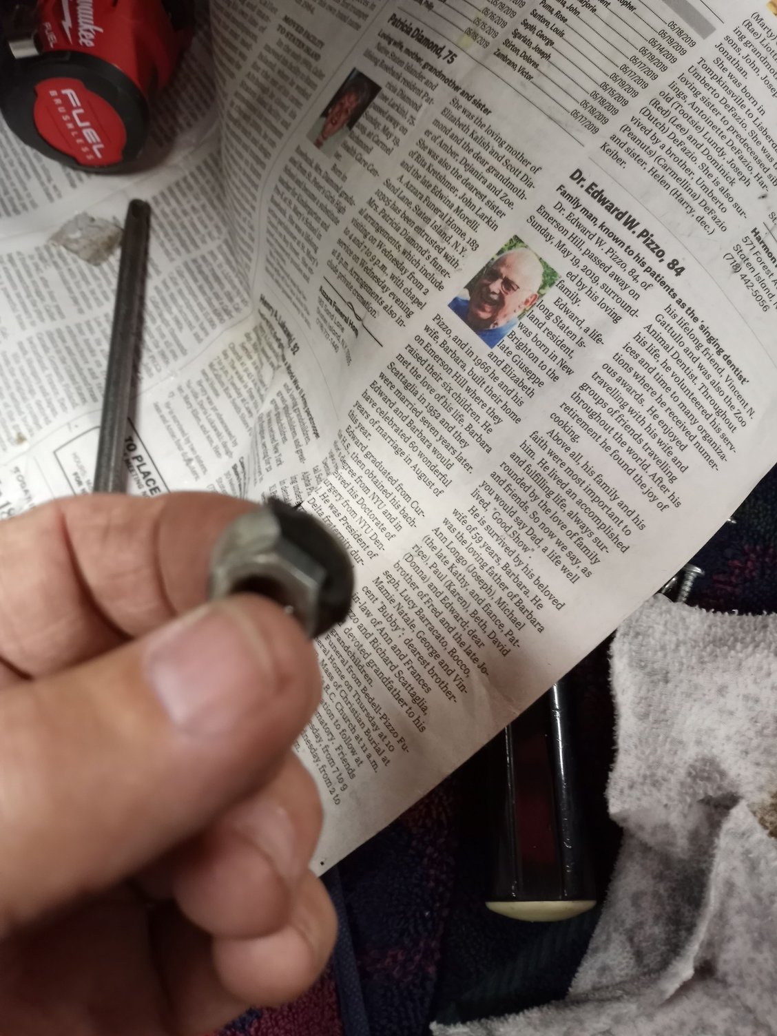

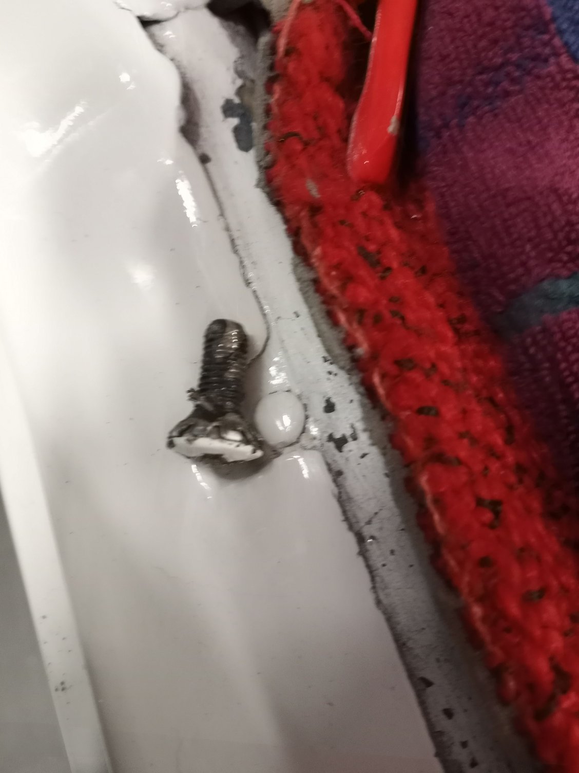

I am assembling my recently painted 61 and had another door installed on the drivers side.
I was putting on the door sill and noticed the lower bolt/screw was loose. I went to tighten it and it spun and I was able to pull it out.
The body used 'dum dum' to hold it in and there are no threads in the hole, only fiberglass.
Is there a way to get a nut back there to hold the bolt/screw in?

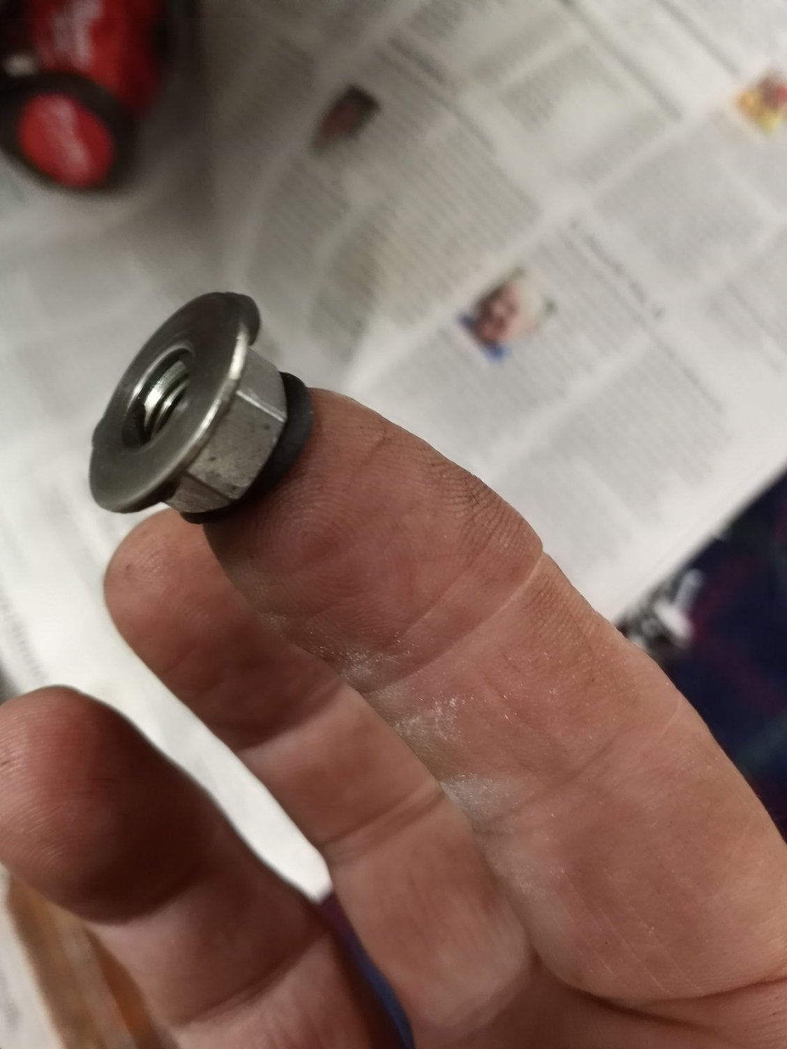

I removed the kick panel, bored a 1" hole in the fiberglass and installed a nut and washer.
All it good and I now can continue assembling the car.
Thanks everyone.
