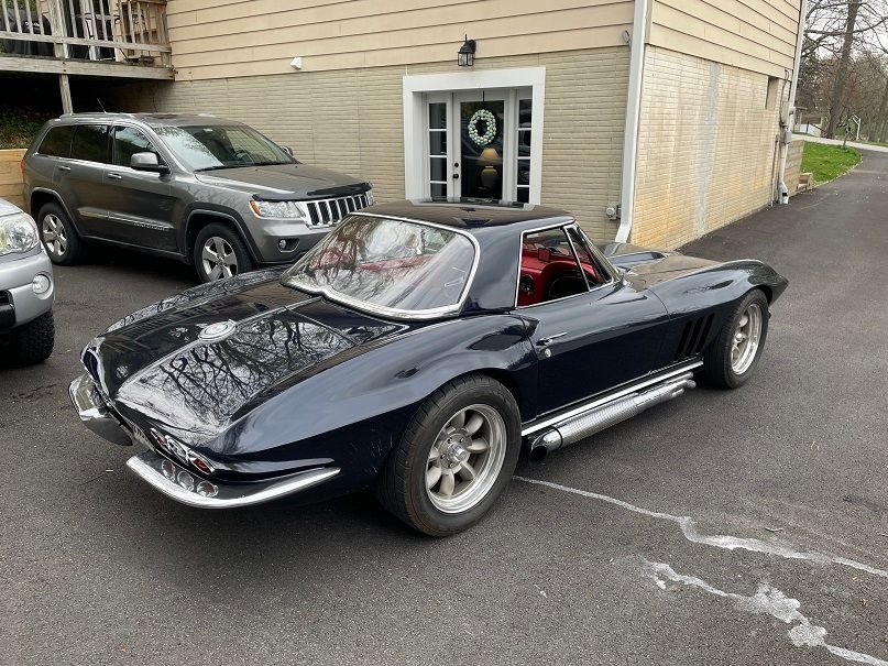

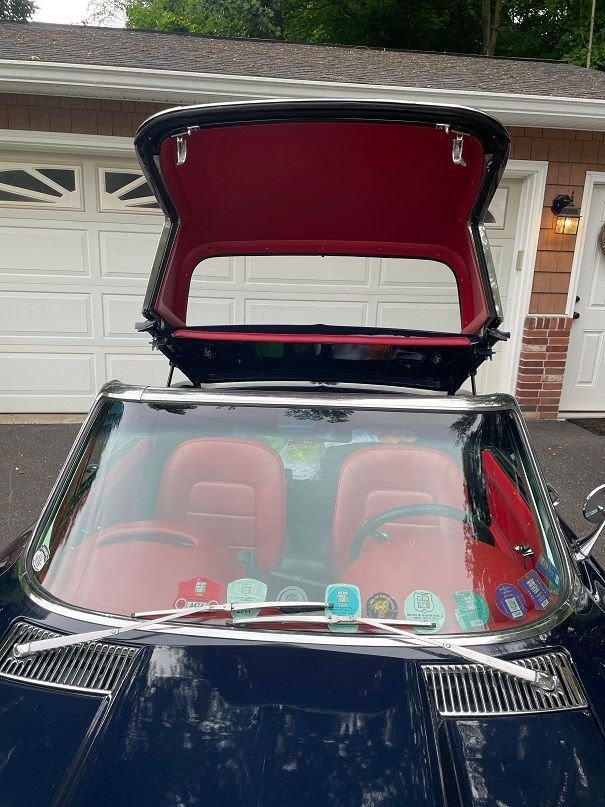

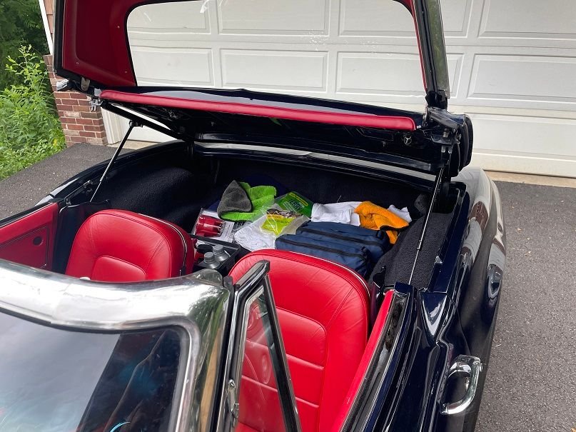

About a month ago I decided to put my hard top back together and put it on the car. I always loved the look of cars with the hard top. Maybe even better than coupes. My issue with the hard top is we travel in the car a lot and access to the luggage area by reaching behind the seats is a pain. Blue Stripe showed me just unlatch the windshield latches and deck lid latch and lift it all up as an assembly. Brilliant! But the assembly is heavy and how do I keep it open to use it? I first made a prop from a 3/4" wood dowel cut to length and worked fine. Until I bumped it and the top came down like a guillotine! Pretty scary actually. So I ended up making two brackets and installed Pneumatic struts. It wa a bit of trial and error finding the right hardware, strut pressure and mounting locations but I think its good. We took a trip, about 2300 mikes the other week. Different hotel every night and it worked well. A few pics.

Although the car is far from correct I did not want to modify it or the top and something that could be easily be reversed. The bracket I added to support the upper strut mount stud is bolted on the deck lid at the latch and hinge using existing bolt locations. The lower strut mount stud is installed through the soft top frame mount plate, upper threaded hole, at the door jam. The strut lays horizontally over the wheel well in the storage area when the top/deck-lid is down and latched.
Tom
