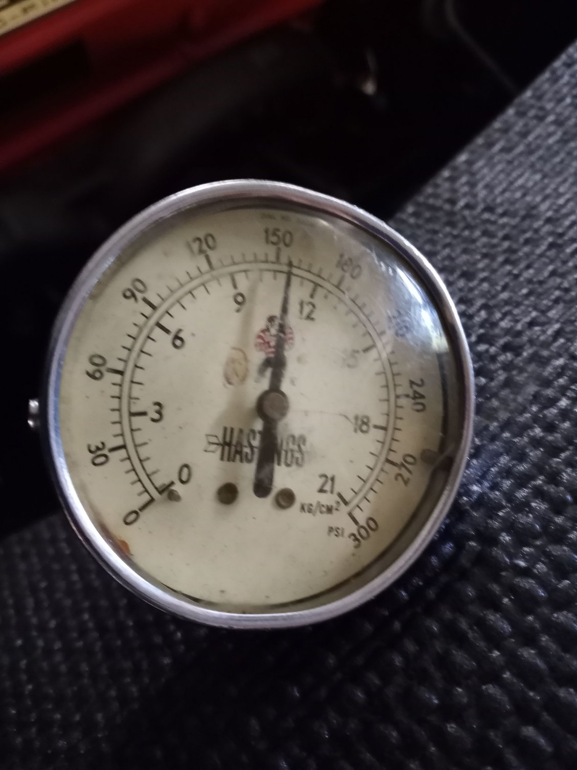

Hello,
I recently bought a 67 427 Vette with the 400HP engine. The motor was recently rebuilt by a previous owner. There is no documentation on the rebuild specs. I did a compression test on all cylinders and got readings between 120-125PSI. How can I calculate the engines current compression ratio assuming the rebuild was to factory specs?
Thanks!

You cant really calculate CR from a compression test. There are other variables that affect compression test pressure. 125 is low. Should be closer to 150 to 170 on that motor.

I agree that your compression might be low. I just performed a compression test on a 65 with a 327, 250Hp and it was over 150PSI.

Keep in mind that the carburetor has to be open for the air to pass thru and get good readings. In addition, I believe the manual calls for the engine to be at or near normal operating temperature. A leak down test should give you a more meaningful idea of the engine condition.

Thank you for your feedback! The engine was not at normal operating temp. There is no smoking and the driving seems okay to me. I just recently bought the car. It has been completely restored but I have no documentation about what was done to the engine internally, so I thought I would have the compression checked. All the numbers are closely grouped, but as you can see others have replied to my post that the compression pressure should be between 150-175PSI. I'll have it checked again at operating temp and inquire about a leak down test.

If it is running good and not using oil, I don't know that I would worry about it. Did you put a little oil in the cylinders to determine if the rings were sealing? If it is a new rebuild, it could need some miles on it to seat the rings, especially cast iron rings.
I did a compression check on an engine and it came out 190 - 200 psi which I couldn't believe, but then found I had a bad gauge. A leak down test will give you an idea if the compression is leaking by the rings or valves. Compression is affected by various factors as others have stated.

As mentioned above, rerun the test on a warm engine with the throttle blades open. You'll get better numbers.

To have any meaningful results; warm up the engine, wire the carb wide open, remove all spark plugs, hook up a battery charger. Crank engine over for a count of 3 sec. Let battery recover on charger while changing tester to next cylinder.

I agree with the the process above except to the 3 second crank. That may not be long enough to get get maximum compression. Watch the gauge as you crank and you will see the compression build. Crank it until it no longer goes up. I do 8 compression strokes for each cylinder. You can hear them while it cranks.

Correct. The factory service manuals specify that a reasonably healthy engine should show no more than 20 psi spread between the highest and lowest cylinder. So consistency is actually more important than the absolute numbers, which can vary widely considerably from engine to engine.
Given that the OP did not run the test properly - engine at operating temperature and the throttle blocked wide open the data is worthless, and the test should be rerun properly.

Don't get hung up on your results. If it pulls hard, runs well, does not smoke or dirty its oil quickly close the hood and drive your car.

In my experience testing compression hot or cold, throttle plates open or closed does not make a big difference. Less than 15 psi per cylinder.
Many times I check compression cold and with the plates closed just looking for a problem or to judge engine health, I know it is not a perfect read but it is close and reliable.
That said doing another test on this engine with it warm and plates open he is not going to see 150-175 compression, maybe 130-135 is my guess.
Like others already stated you have to crank it over 6-8 revolutions to see max compression.
If a cam with lots of overlap was installed at rebuild that could bleed a lot of compression off. A large cam would be evident by a lumpy idle.
Many of these engines were rebuilt with lower compression so the owner could run pump gas, that would not be unusual at all.
My scan tool can do a compression exam now. Does not give numbers but reads the amp draw on the starter as you crank the engine and reports back if all 8 have the same amp draw. Very quick and clean test but it can detect a problem cylinder.
