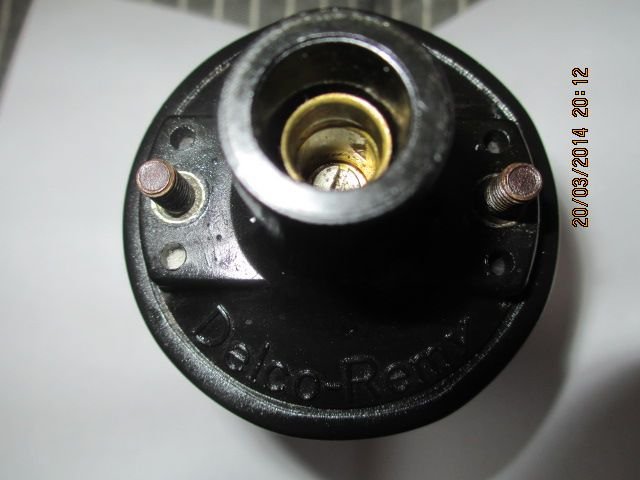

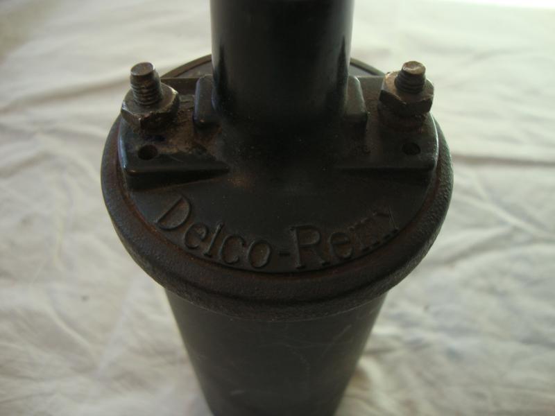

I might add that finding an original 091 coil is tough. It's like looking for the Holy Grail.
AND, if you want to get real technical, there are/were 2 types of 091 coils used in 63. Has to do with the presence of absence of two buttresses on the coil tower.
Old Jun 21, 2021 | 03:16 PM
Chuck Gongloff's Avatar
Chuck Gongloff
Active Streak: 90 Days
Joined: Apr 1999
Posts: 10,866
Likes: 717
From: Beverly Hills/Pine Ridge Florida
091 Early. No Buttresses
091 Late. Has Buttresses.
Old Jun 21, 2021 | 03:19 PM
Chuck Gongloff
Joined: Apr 1999
Posts: 10,866
Likes: 717
Late. Buttresses
Old Jun 21, 2021 | 03:37 PM
63vert's Avatar
63vert
Joined: Mar 2005
Posts: 93
Likes: 9
From: Auburn, WA
Well that's not good news, I guess the hunt begins. I really wish who ever had swapped out this stuff would have thought twice but I remember back in the day nobody cared much about originality. So anybody that has all the 091 coils sitting on shelf are free to reach out.

If your car will not be judged, get the 087 coil and use the blue stripe (1.8 ohm) ballast resistor.
No one except you and a select few will know the difference.
Larry

I don't think I was aware of that, Chuck, but I clearly can see the difference in the photos. Also, do you know about when the second design was installed by Flint, and as with many changes the old and new designs may have both been in use until inventory of the old design was fully depleted.
Duke

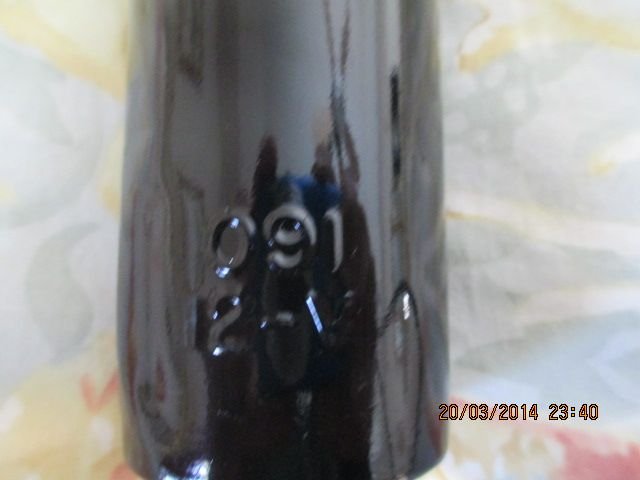

Is the number 091 on the coil somewhere? I have a Delco Remy coil with the buttresses but I do not see a number on it anywhere. I might just be missing it.
Jay
Old Jun 22, 2021 | 01:17 AM
silver837's Avatar
silver837
Joined: Mar 2017
Posts: 5,127
Likes: 1,612
From: Nor- Cal
It should be embossed on the the bottom of the can.
Jay
Original embossed on the bottom of the can
Repro embossed on the top of the can.

It is my understanding that all high performance 63’s had the 091 coils with the shoulders (buttresses). The shoulders were on all 091 service replacement coils which were introduced in the later part 62. I’ve never seen any documentation as such but it has generally been accepted that the change from “no” shoulders to shoulders was made in later 62. I’ve always known that most/all low HP (250 & 300) had 087 coils.
