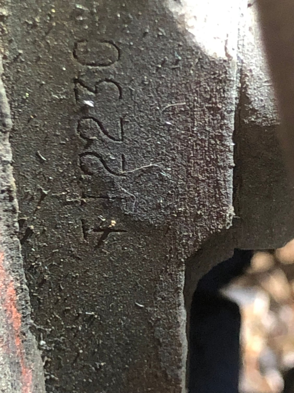

Old Jun 30, 2021 | 08:20 PM
ibegonesurfing@aol.c's Avatar
7th Gear
Joined: May 2021
Posts: 7
Here’s the casting and vin
Old Jun 30, 2021 | 08:33 PM
Nowhere Man's Avatar
Nowhere Man
Joined: Feb 2003
Posts: 54,062
Likes: 9,396
2015 C2 of Year Finalist
its from a Impala
Old Jun 30, 2021 | 08:42 PM
65GGvert's Avatar
65GGvert
Joined: Jul 2006
Posts: 22,164
Likes: 4,172
From: Kannapolis NC
It's a 283 that came with a 2bbl carb, from a 58-64 passenger car. the engine ***'y date is 12-23 of whichever year is in the block casting date, if the stamp is correct. Most were 170 hp.
