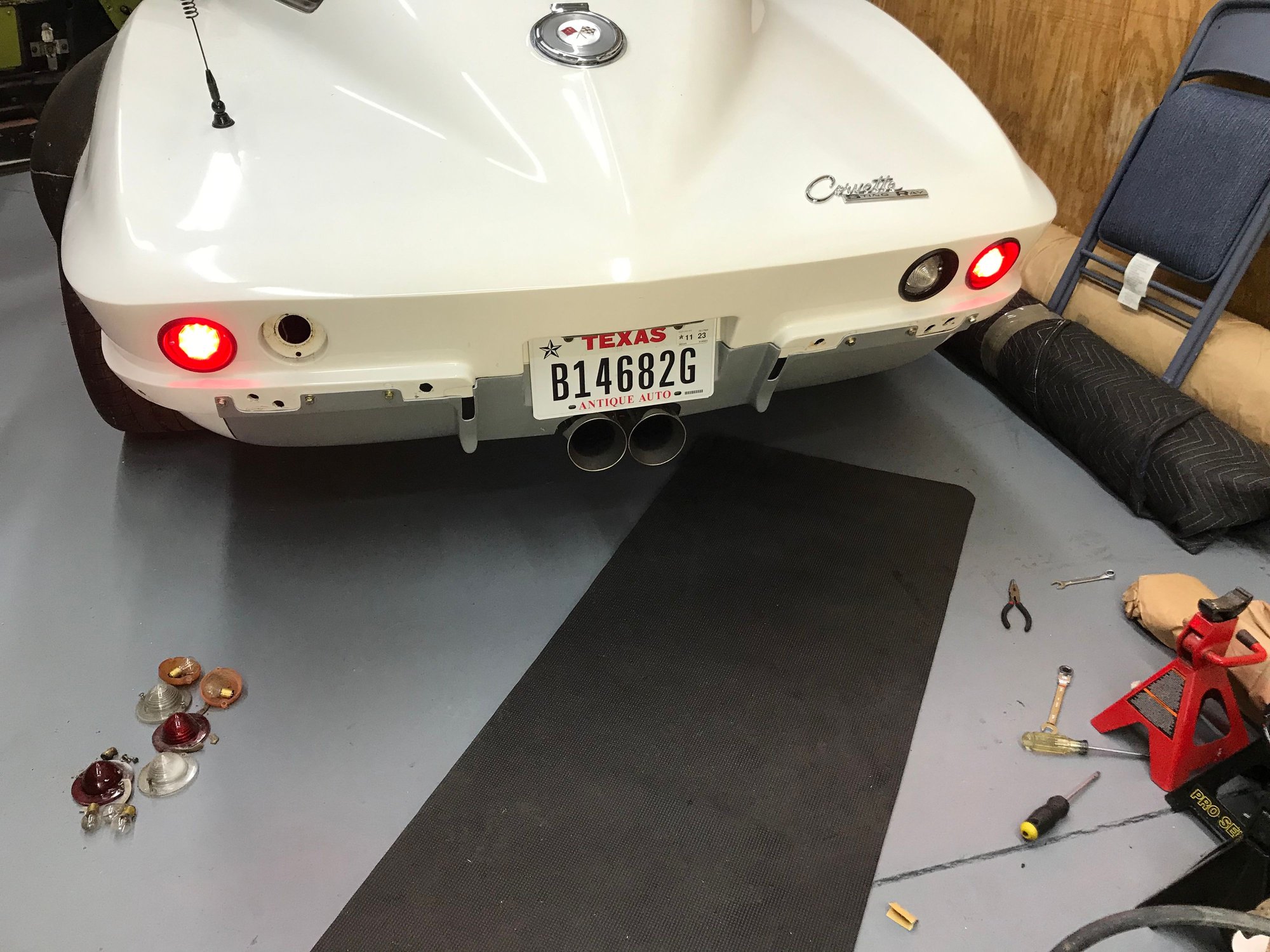

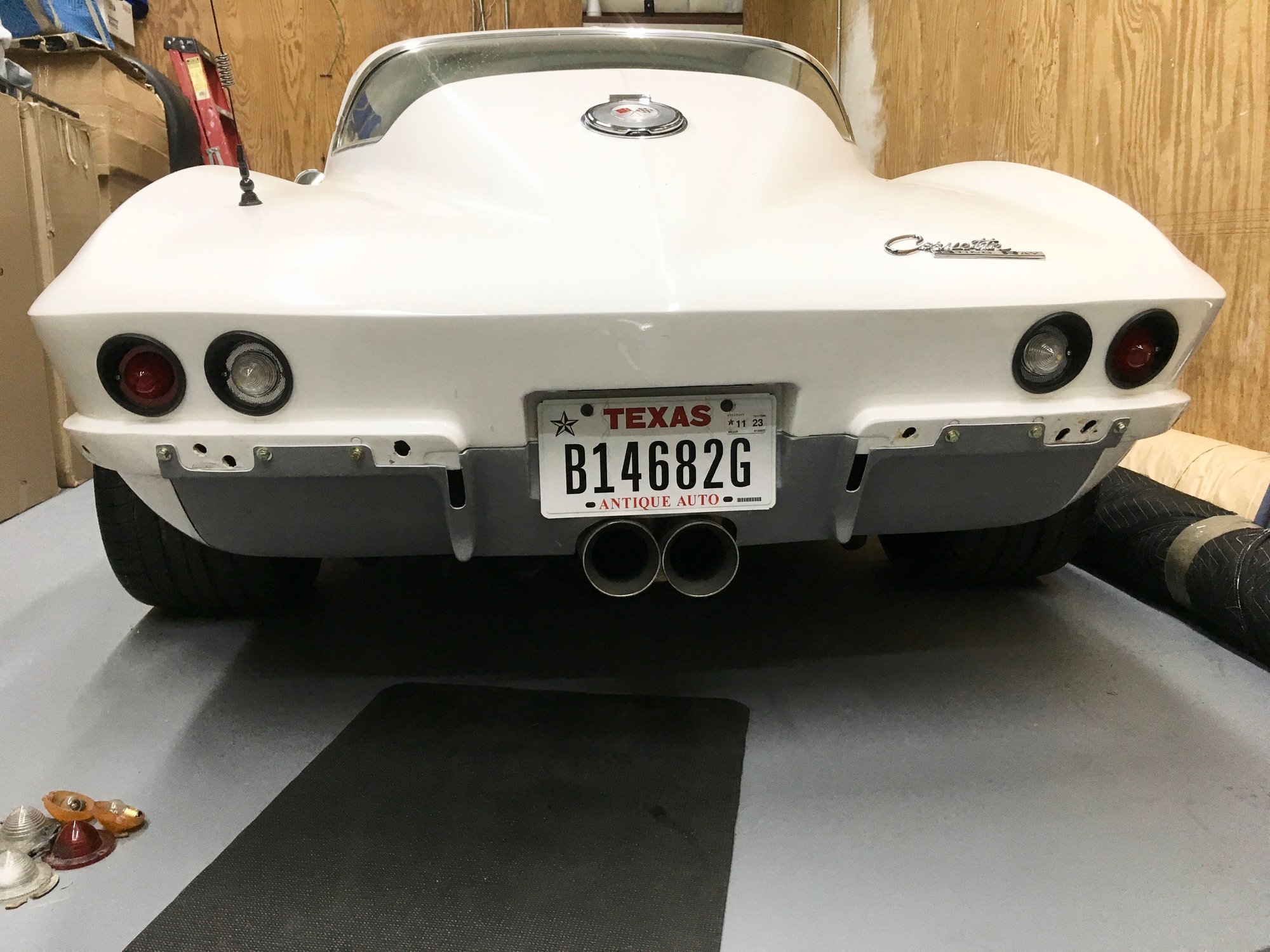

On my ‘64, some of the lenses were cracked and all were hazy. I used the complete assemblies from Zip and painted the oem bezels black as that was on my list regardless.

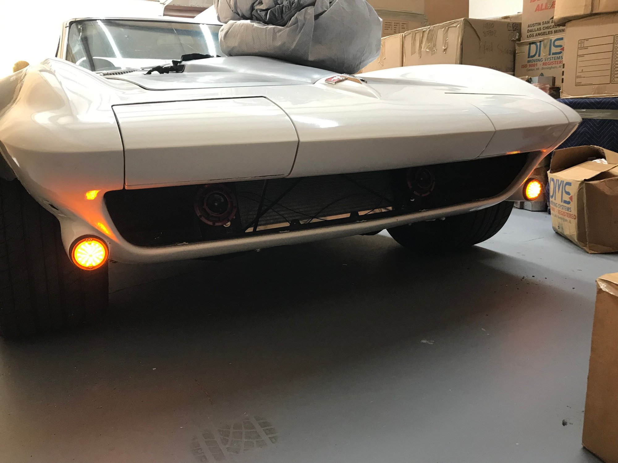

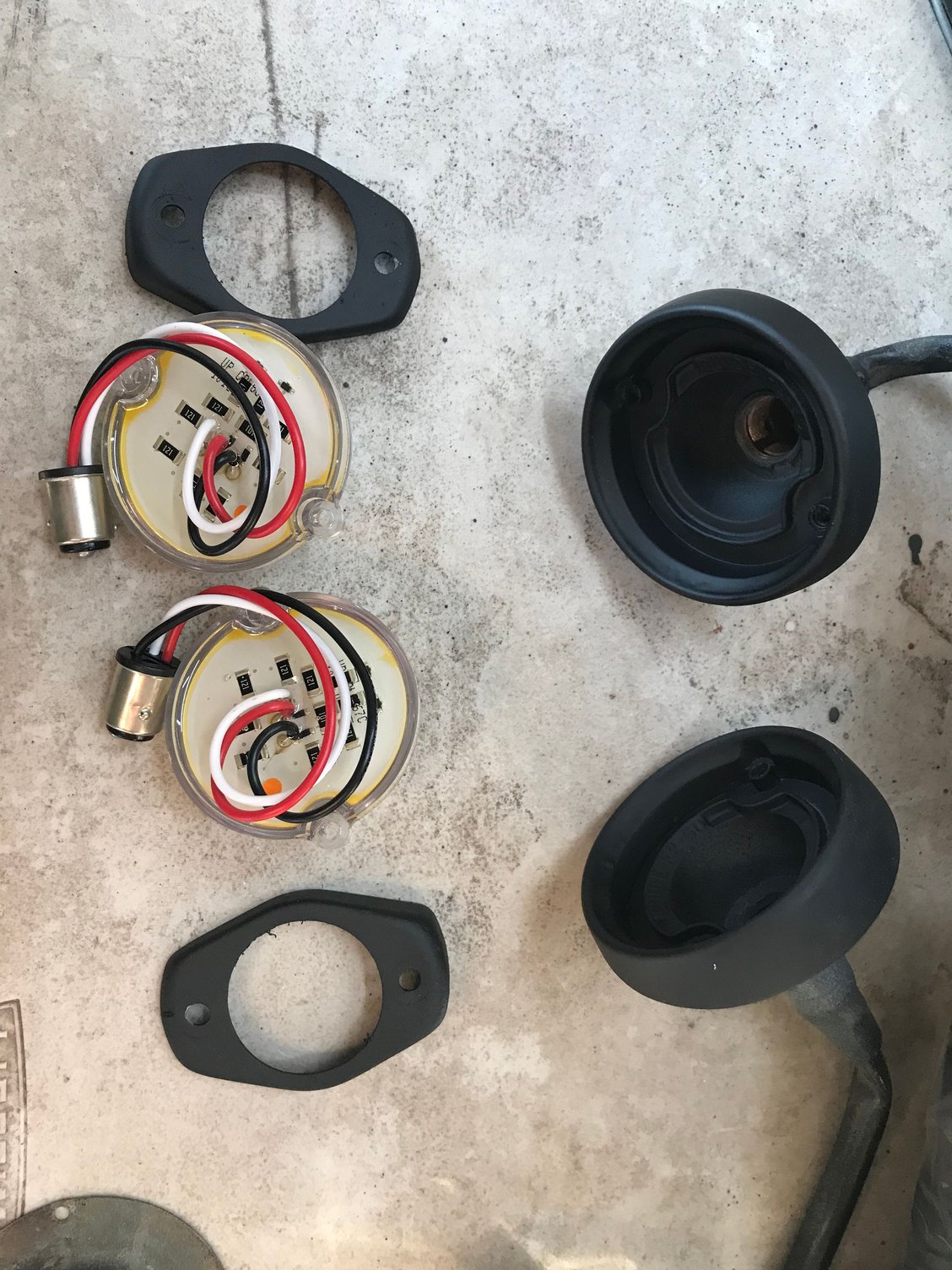

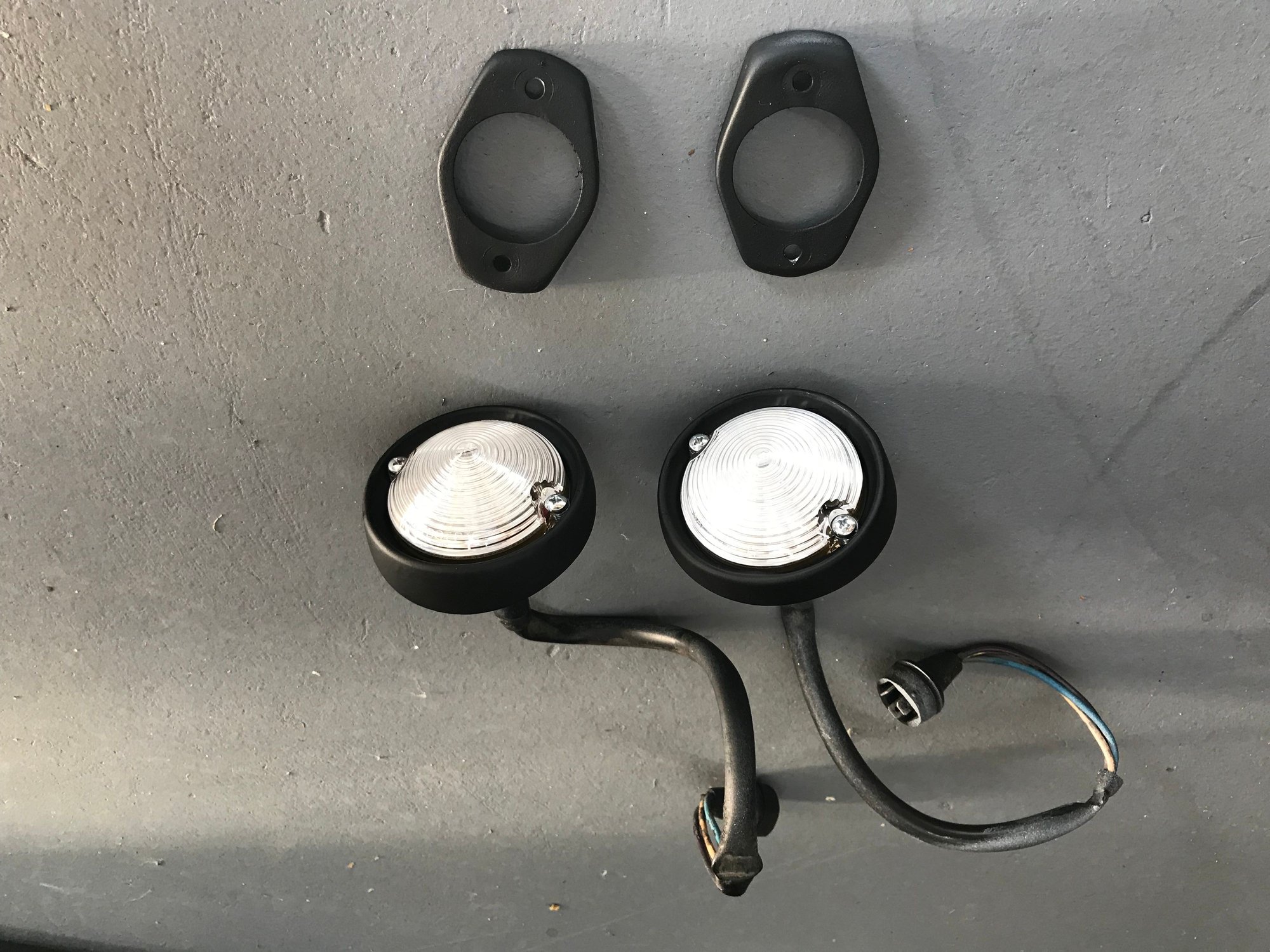

Here are some other images.
These are the front parking lights with the oem housings and retainers painted flat black.

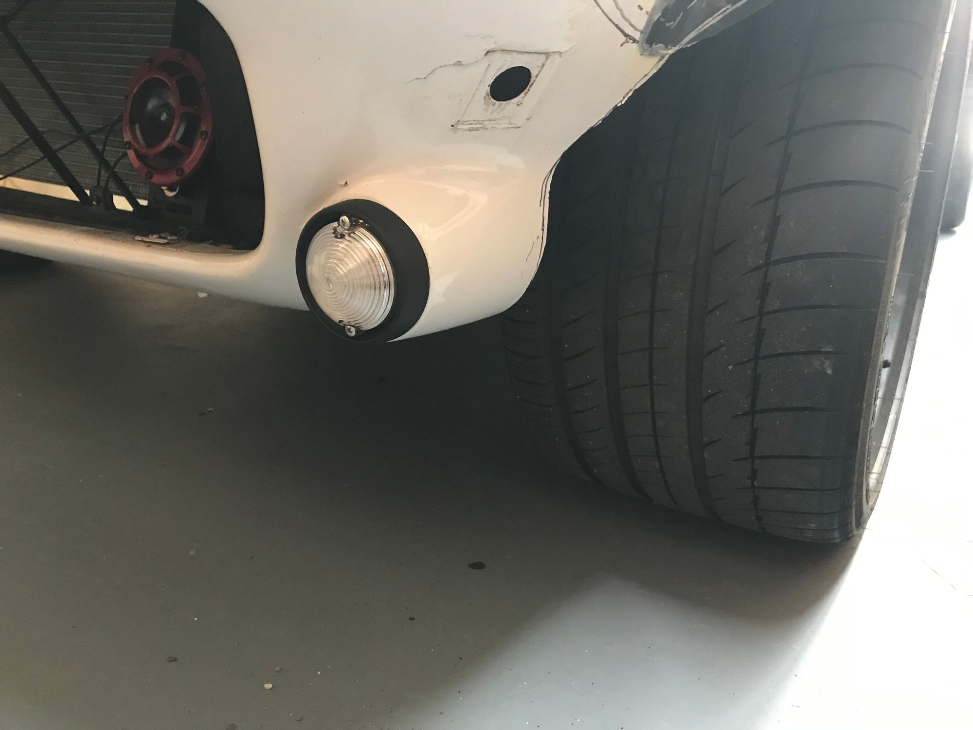

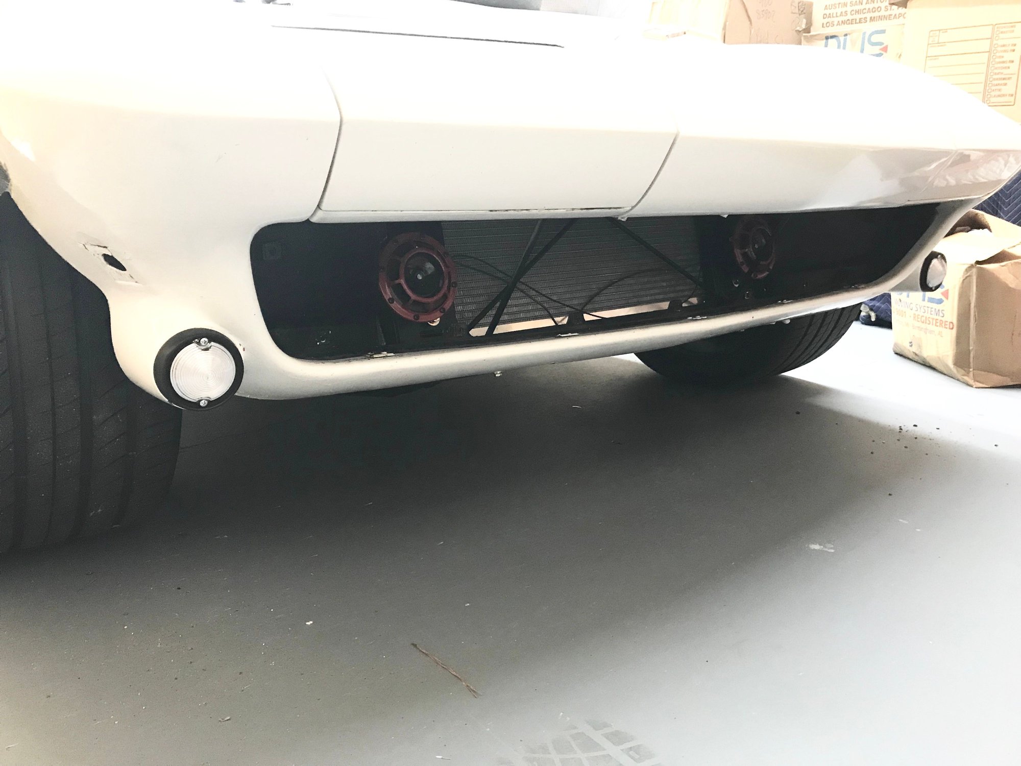

Fronts assembled…
…installed…
…and on.
The rear on. The picture makes them look almost white. They are not, but they are about 3XL brighter red than stock.

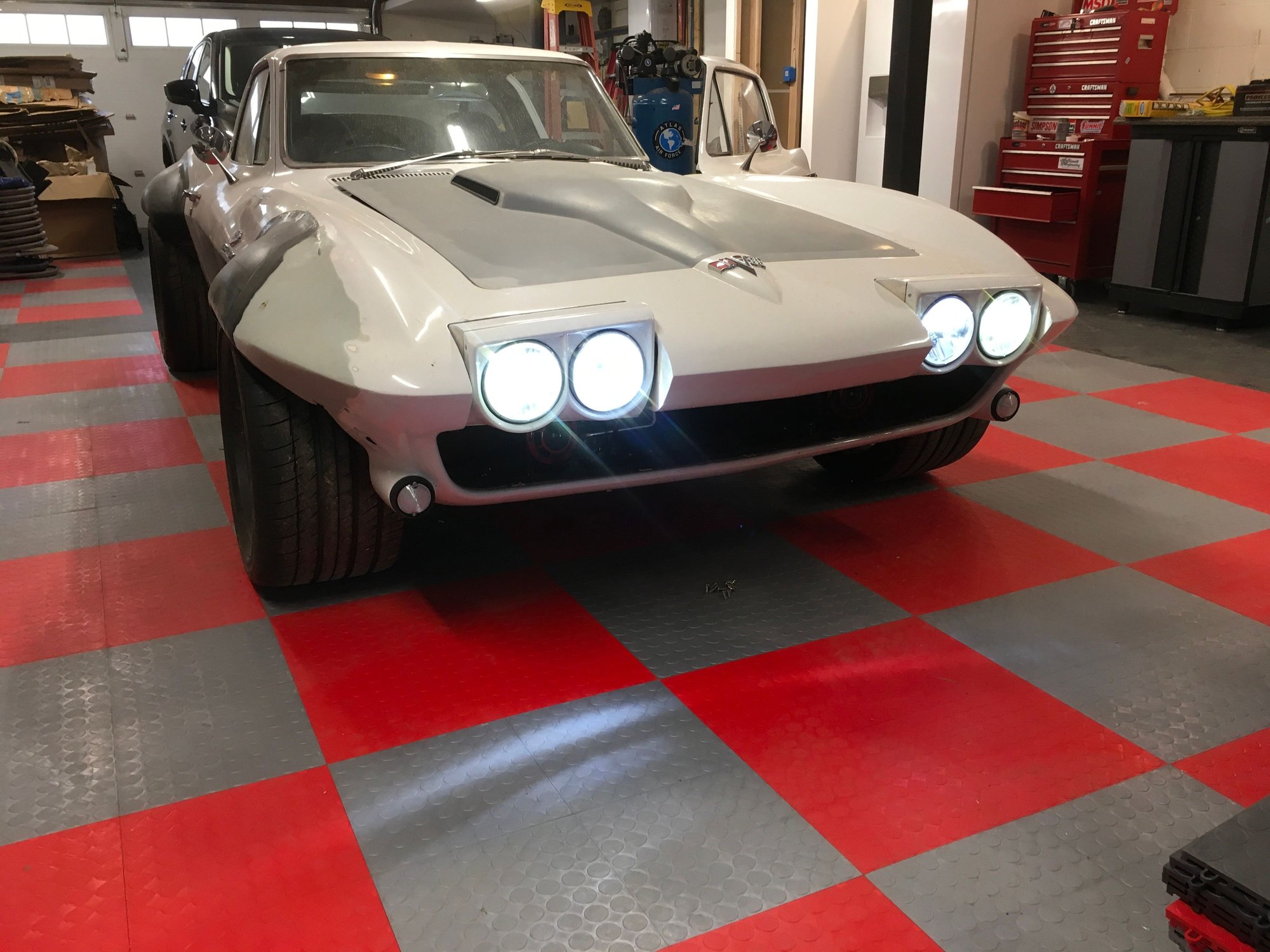

I did the headlights also. One benefit here is that my oem headlight switch was toast and I had to use one of the aftermarket ones with the known lightweight internal CB that causes original or halogen headlights to flicker. LEDs are significantly brighter and drawn significantly less current eliminating the flickering.

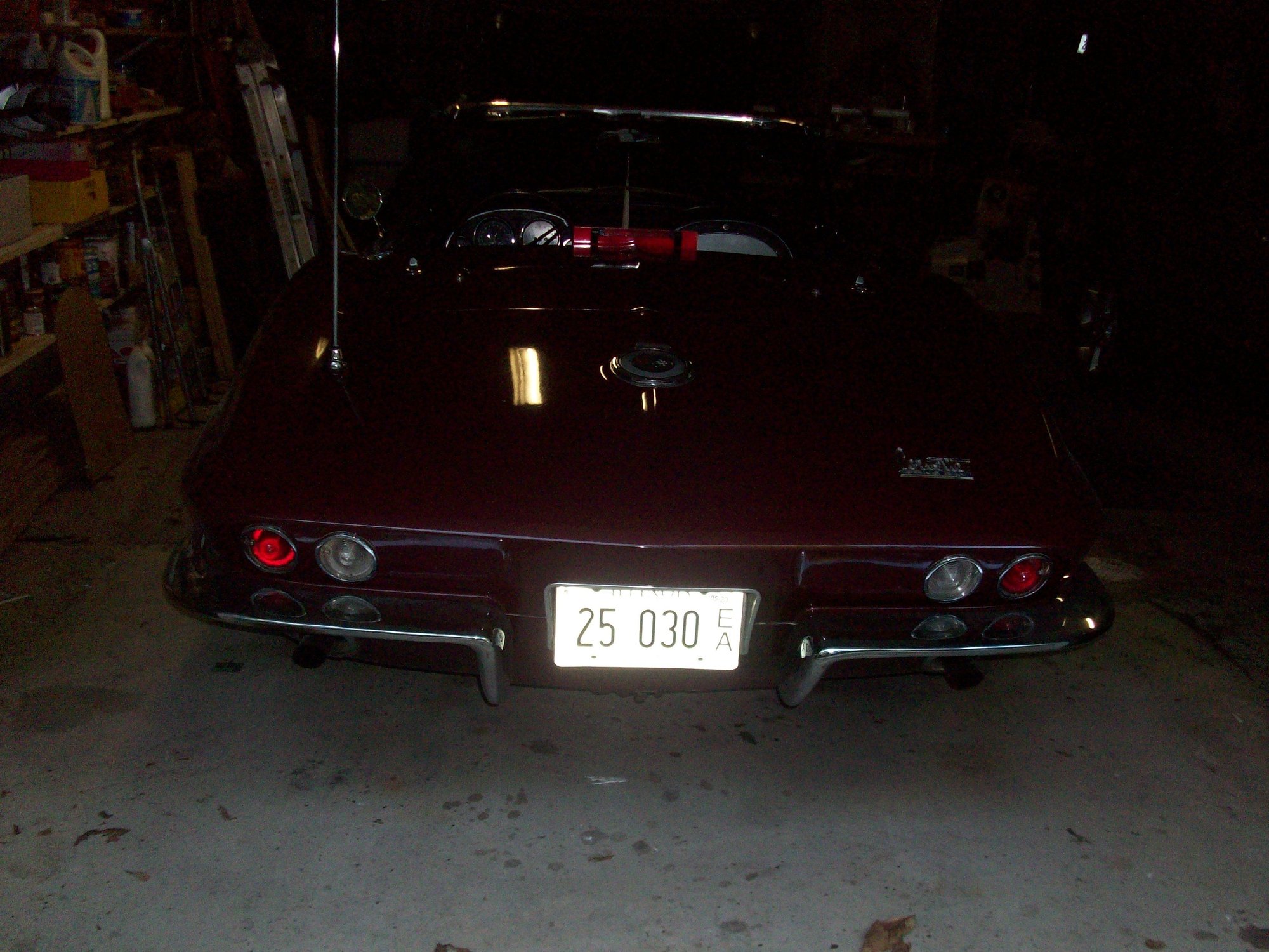

LED Infused lenses in outer brake light locations - stock. SuperBrite red LED bulbs in backup light locations with stock white lenses. Both brighter than stock / 1157.
Just an option. I gave up backup lights for additional brake lights without modifying the wiring harness.
